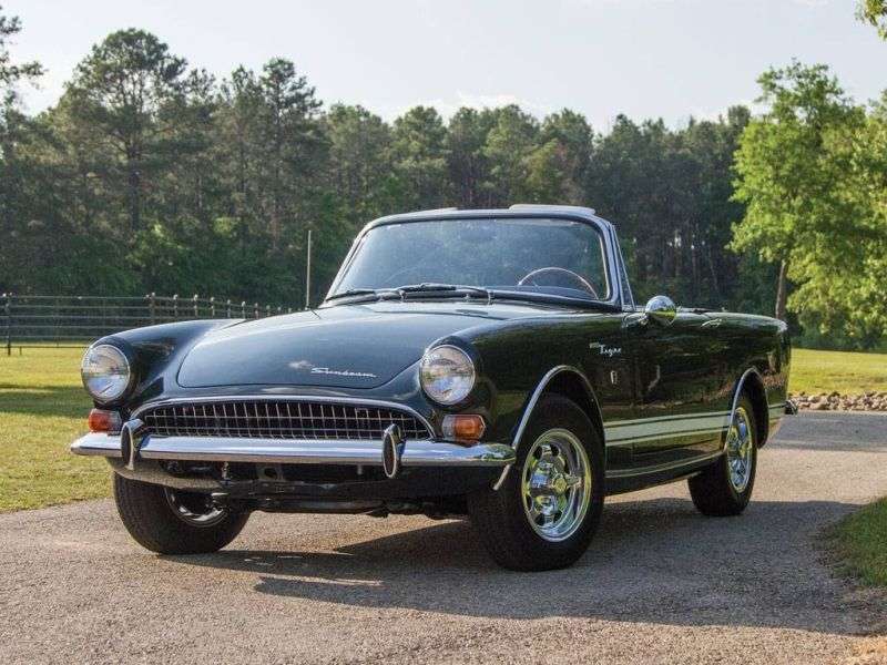

Tiger Mk I

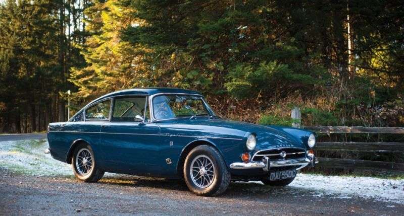

Tiger Mk II (Non-standard wheels)
While the Mk IIs had more grunt I found the Mk I was much better balanced, and wasn't so likely to sling you into the hedge backwards, not that I ever did that, mind you.  ;D

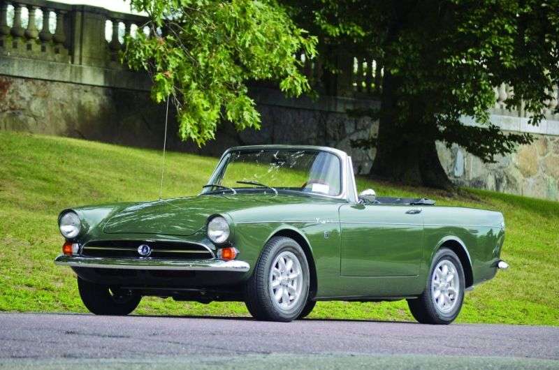

Just found a pic of this Tiger Mk I on the Net.
It's either a Harrington Alpine Mk IV/V converted into a Tiger, or a Harrington-ised Tiger! Definitely not a standard car but  it looks superb, especially in that scheme.
I wonder if I could do that to my AMT Tiger kit?
[Later] Looking deeper into this car it seems it WAS a proper Harrington Tiger.  :o
Indeed it's unique, as it's the ONLY official Harrington Tiger. It's currently over on the west side of the Atlantic somewhere, having won its class at a Pebble Beach event a few years ago. Respect!  :thumbsup:
