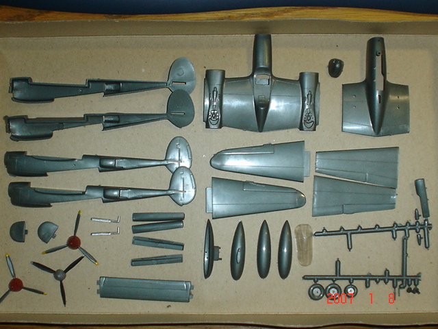

And my first thoughts when seeing the photos was -- they used P-38 tail surfaces. And I had this un-named kit of a P-38 which I've decided was going to be used as a donor kit for something else in mind, so the fins were quickly removed before I changed my mind ---  :wacko:

I printed off the side profile and scaled it to the kit's fuselage, then offered up the P-38 fins to it and soon realized that although the Twin Tail's fins look like a P-38, they weren't quite. So a bit of reprofiling was done and a lot of sanding to thin the fin parts down was needed.
For the tail modifications, I started with some strips of styrene angle section which was whittled down to match the top of the fuselage and the side profile. These pics I've got bit's an pieces taped up so I could view the result. I had pinned the new tail plane with some small diameter brass tubing and found that cutting the P-38 just in half didn't look right as the styrene angle leg made it look to wide apart. So I trimmed the root ends down until I got the fins to be the same width as the P-38 has them. With the lack of a 3-View, that's a bit of a guess on my part.
