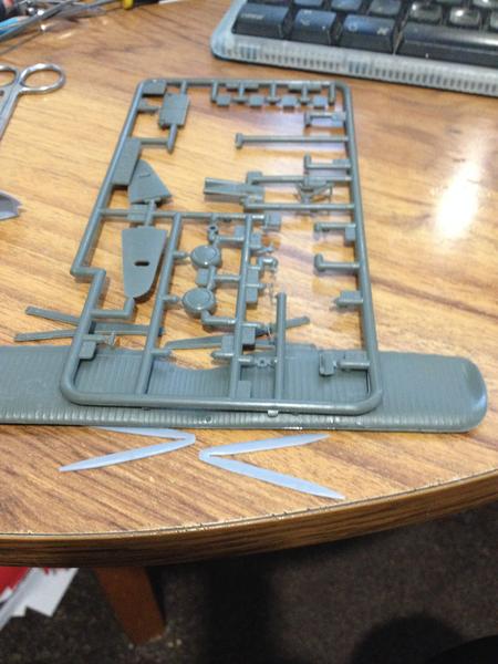

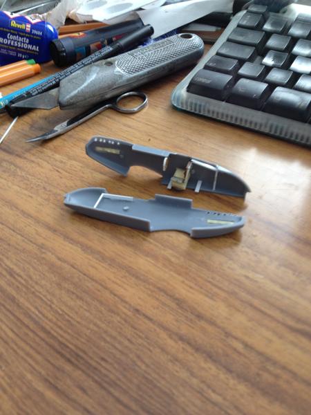

As I potter around with the final touches I've made a start with the spare fuselage that comes with the kit. There were a few varieties of the Br 27 with the early versions sporting a 500hp Hisso while later types used the 650-690 model. This was used by the Spanish Furies so should be ok for an ad hoc fighter. As noted earlier the wings of this batch of 27's went down with the ship so I'm going to try to modify the fuselage to single seat and use the spares from a Heller Nieuport 62 to provide the wings and other bits and pieces. Plan is to fill in the second cockpit with card, hence the support struts, and reduce the length of the fuselage. Going to cut out the section between the front of the cockpit and the rear of the engine upper decking. I was going to cut out the rear cockpit but this meant building up a prominent step which would then increase the cut out for the spar carrying the tail unit. Hopefully, the way I'm looking at will be less work.

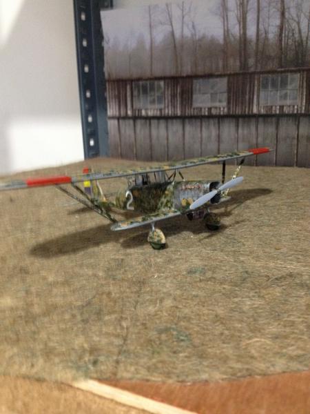

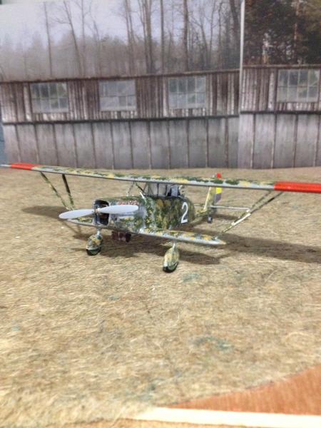

Hi All,

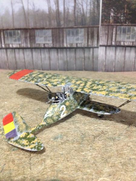

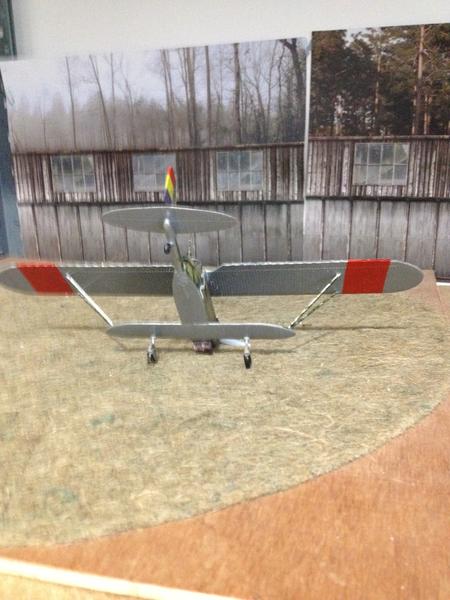

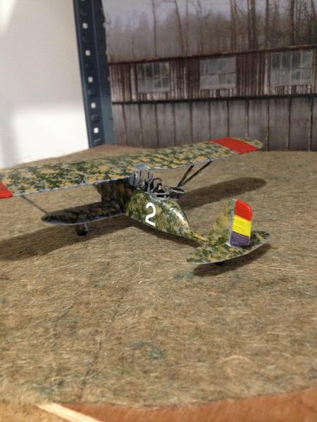

         Calling her finished. My interpretation of a civilian version of the Br27 which has been militarized. It has received a Soviet copy of the Hisso salvaged from an SB2 bomber. Internals have been kept very basic and constitute a scratched camera and magazines. Based on the export Br 273 she would have been a bit faster than the Polikarpov R-Z the Republicans were using so I've assigned her to photo recce duties. There's a hole in the bottom of the fuselage filled with glue and glaze for the camera. Flown alongside the R-Z's they eventually ended up on ground attack duties as the Aragon campaign turned against the Reds and appear to have been lost. No signs of Breguets on the Grupos inventory when they were transferred to Catalonia at the end of 1937.

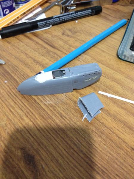

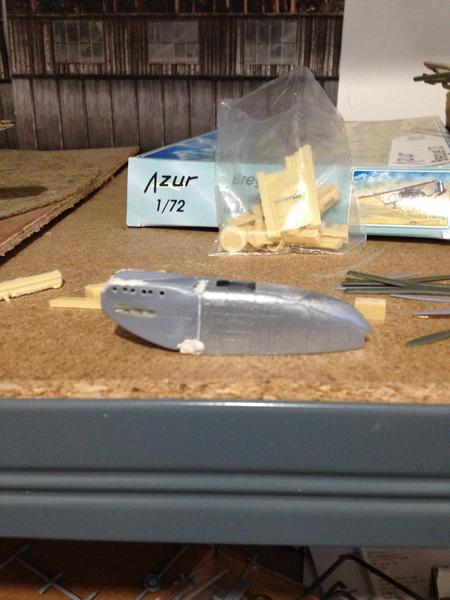

Work on the Breguet Parasol continues with some surgery having to be performed. A shorter fuselage was thought desirable for a fighter so a section between the cockpit and engine compartment was removed. On rejoining my careful cutting was revealed as wishful thinking and filler and a plug was required. I've tried a dry run with the Nieuport parts without any obvious issues showing up so fingers crossed.

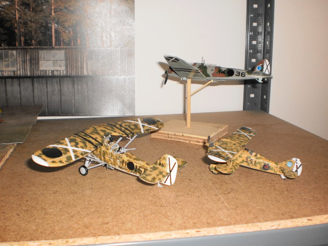

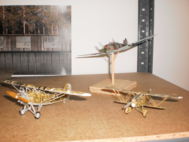

Last, with all these Republicans, I thought there should be some opposition. Not so much scope for Nationalist whiffery so RW only. I built these during Covid lockdown and they are the Supermodel Fait CR32, and two Heinkels, the AML parasol He 46 and the Revell/Matchbox He 70 monoplane.
That looks good  :thumbsup:
The 3 Republicans look good as well

Those are looking so good Steve...love the camo bigtime  ;D :thumbsup:  :thumbsup:
