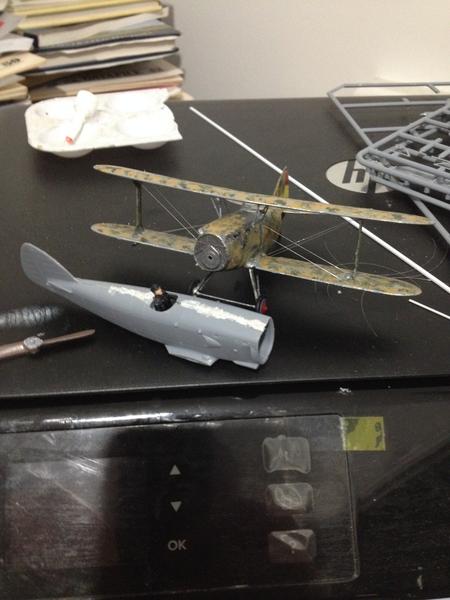

Almost there. The lower wings went on straight enough. I drilled the interplane locating struts a little deeper but they proved to be a good fit. I used ordinary polystrene cement to increase the waggle time. The secret weapon as far as this kit is concerned is the small lips that the cabane struts sit on. This pretty much ensures you get them into the right position. The rigging holes were drilled before the wings went on but as long as the rudder is fixed before hand all that is needed is to allow the glue to go tacky and then upend the kit onto the top wing. Use that waggle time to get everything lined up and then support with paint tins and bottles etc. The undercarriage came from the Matchbox Fury. The Spanish were going to build the Osprey under licence so I reckoned they might have some spares curtesy of Hawker.
As this build comes to an end I've started the other 510. This one will be largely OOB and will represent yet another rebuild on the S91 after another prang. An upgrade of a 690hp Hisso from a Potez 54 bomber means I can use the kit fuselage as it comes. The main change will be the undercarriage.

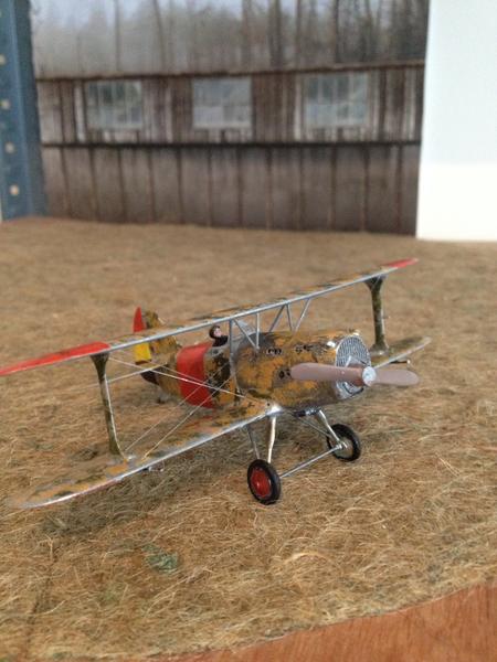

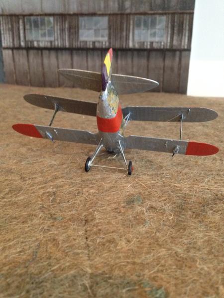

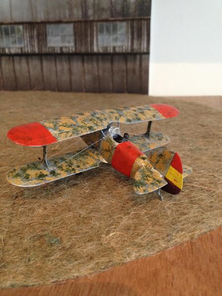

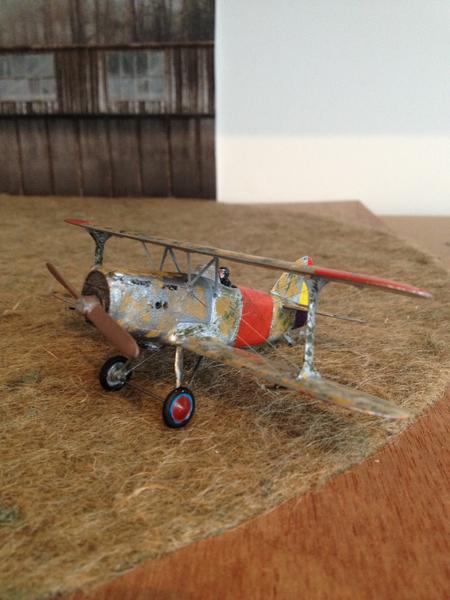

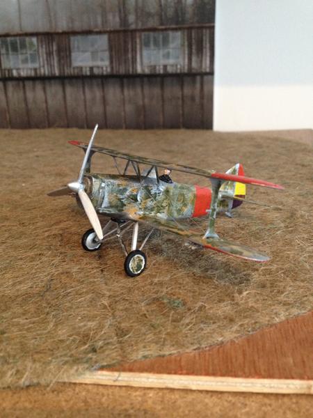

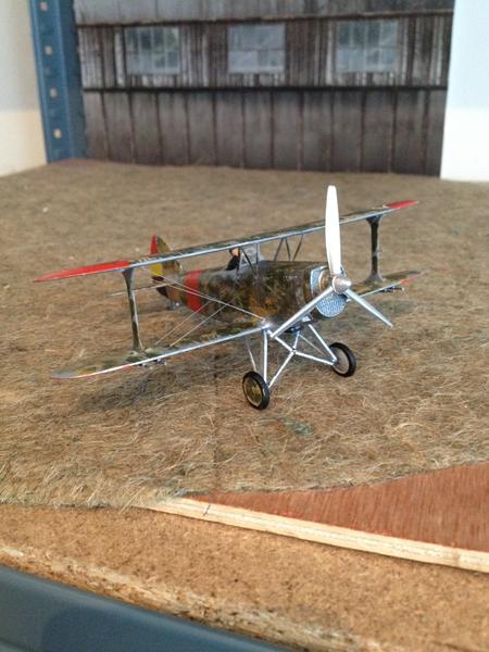

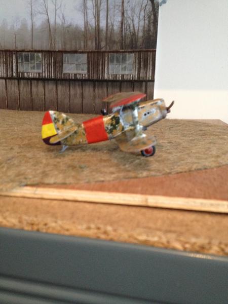

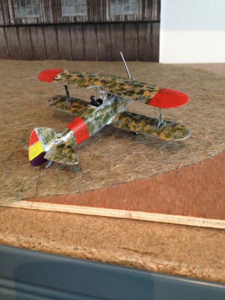

Finally got these two finished. Here's the back story and photos.
The original S91 flew in the defence of Madrid and was believed to be shot down at the end of October 1936. Nothing more is heard of this machine but it now appears it may have been repaired and sent to re-inforce a small aerial component of the Republican forces which defended the Cartagena region after the Nationalists had taken Malaga. It served in an ad hoc formation comprised of the two prototype CASA parasol observation aircraft and a flight of Breguet 19 bombers. A flight of upgraded Spad 51TH fighters from Turkey made up the initial Red air strength. A half hearted attack was made by the Nationalists which was repulsed and both sides then sat back behind mountainous defensive lines for the rest of the war. The Red fighter contingent coped with the Franco fighters which comprised some Heinkel 51's and Polish PWS 10's, a parasol aircraft which was quickly re-allocated to training duties. This was the fate which befell the Red Spads after they were replaced by I-15 Chatos. The surviving aircraft were sent to the Fighter training school at Cartagena and the tender mercies of inexperienced pilots.  The S91 was once again on the receiving end of a rough landing and was despatched to Alicante for major repairs. It was probably intended to be an instructional airframe to train groundcrews but it was apparently repaired and re-engined as a project for the engine fitters. The engine used was a 690hp Hisso which was retrieved from a Potez 54 twin engine bomber. The trainees had to lengthen the fuselage to accommodate this engine and create a new undercarriage. In effect, they had upgraded the S91 to Spad 510 standards. This was a machine the Republicans had had high hopes of obtaining early in the war and it is likely that the manufacturer's manuals had made it to Spain. The deal fell through when the famous French air ace, Rene Fonck, who had sponsored the deal, demanded 2,000,000f, as a personal payment before signing the contract, and the deal fell through. The Alicante Spad was armed with four underwing mgs, could make at least 220mph, and the undercarriage was constructed from parts smuggled from England with the Westland Wallace consignment. As a single type the aircraft was sent back to Cartagena where it served with Grupo 72 alongside Breguet Parasol fighters on coastal defence and patrol duties.
First, the first repair job with the short fuselage.
The Alicante repair with the longer fuselage and upgraded engine. The fuselage was used OOB with the radiator as AZ intended this time. I changed the prop to a three blade as if it had come from the Potez or something similar. It came from an old Airfix Gladiator. The undercarriage was made from the front section of the Novo Wallace/Everest kit with the rest of the legs from scratch strip. Wheels are white metal.

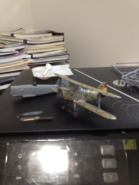

There's less scope for whiffs with the Franco Spanish Nationalists and this is another RW from Heinkel. It was issued by AML, a Czech company, and put up a bit of a fight. Definitely more early Airfix RE8 than the more user friendly and recent BE2c. The Heinkel 45 could be claimed to be the German equivalent of the Hawker Hart. Production ran from 1933 to 36 and 512 were built. Aircraft served as long range recce and at flying schools. Twenty-one served with the Legion Condor until apparently replaced with the Heinkel 70 monoplane. A total of about 46 aircraft served in Spain and for the rest of the war served with Spanish forces. They operated in reconnaissance roles, and engaged ground troops in strafing and more general bombing roles. Popular with the crews it was nicked "Pavo", Turkey. Thanks to AML for the background info.
There is a little disagreement regarding the colours sported by this type during the SCW. At the beginning of it's deployment, circa Nov 36, it sported light grey overall and this does not appear to be in dispute. As time went on camouflague was applied. Some say green was mottled onto the grey while others say brown. Later there is a brown and green lozenge effect but other types such as the Heinkel 70 sported the green/brown/grey mix that I've gone for. Appears logical to me. Finished in the recce role but may add some bombs later.
