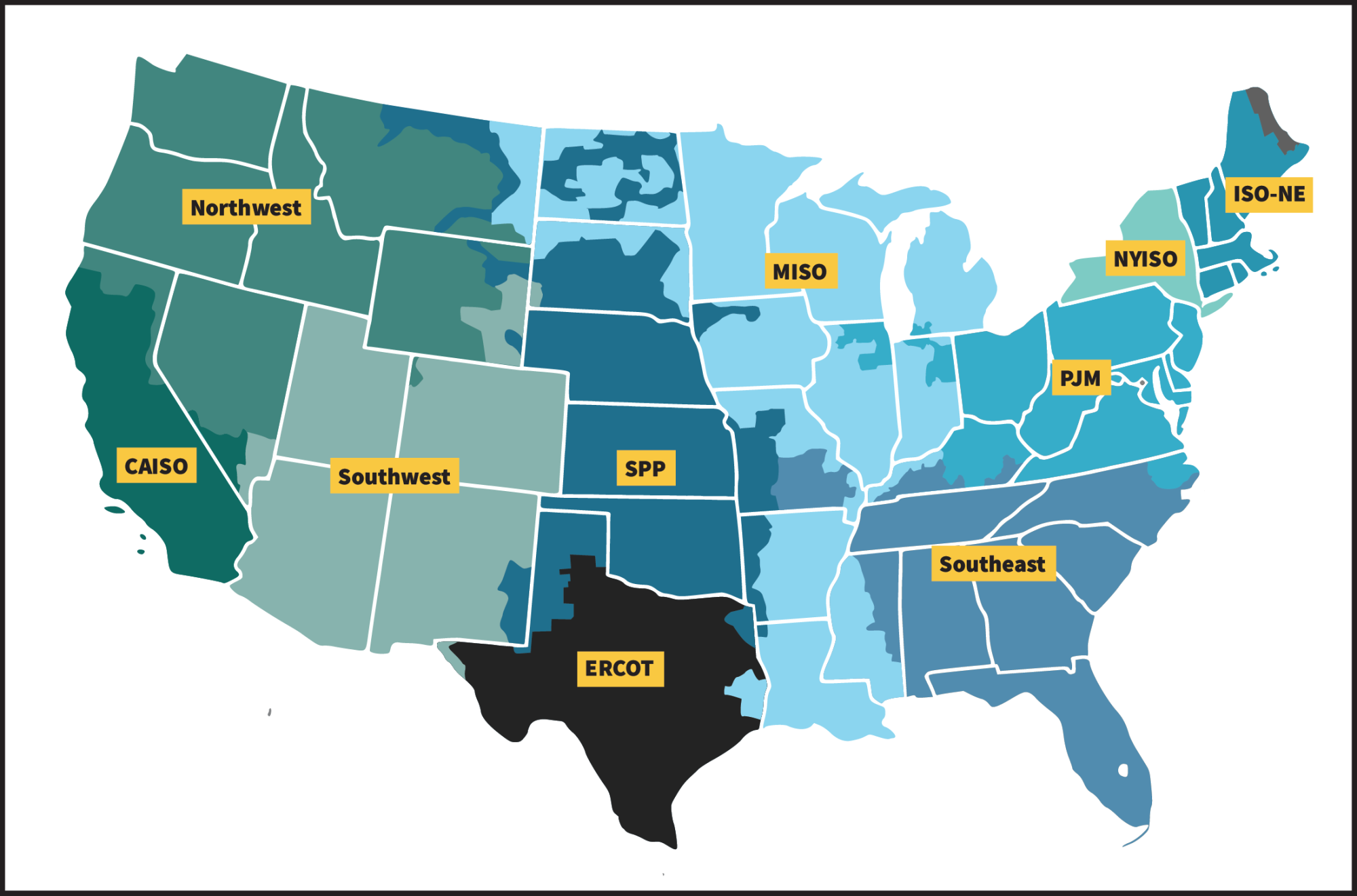

In a larger system, this is amplified, and even a big grid, connecting many consumers and several big producers (a Transmission System Operator, or TSO), will have huge gains by being well connected to it's neighbouring TSO's, thereby being able to "borrow" capacity over these borders when necessary. The US system delivered one of the best/worst recent reminders of that during the winter storm in Texas a few years ago, when large parts of the state were in blackout for days, even up to a week, leaning people to actually freeze to death in their own beds. Compare that to NW Texas and Oklahoma, that was hit by the same weather but connected to another TSO, instead of those major blackouts experiencing only short interruptions of about 30 minutes each. The problem here was that Texas main TSO (ERCOT, if memory serves) over many years has been staunchly independent, refusing interconnections to neighbouring US TSO's, whereas the TSO in OK has not, instead it's seen to that it could get support from both the west and the east during this stress event. The following map shows that in an very clear way.

Adding insult to injury, here's an even better US TSO map:
Greens and blues are well interconnected within their own main colour, basically being able to import 20-30% of their internal max load at any time. Between the green and blue areas, a transfer of 10-12% is possible but from ERCOT (black) to anyone - only ca 1% of what Texas uses. Not ideal.

Quote from: Pellson on October 14, 2024, 04:18:02 AMAdding insult to injury, here's an even better US TSO map:
Texas doesn't want to be subject to Federal regulations when it comes to the power grid, which is why they don't interconnect with anyone...which is why the "Reliability" in the ERCOT acronym (Energy "Reliability" Council of Texas) has become a joke of late.

Quote from: scooter on October 14, 2024, 04:26:16 AMTexas doesn't want to be subject to Federal regulations when it comes to the power grid, which is why they don't interconnect with anyone...which is why the "Reliability" in the ERCOT acronym (Energy "Reliability" Council of Texas) has become a joke of late.
