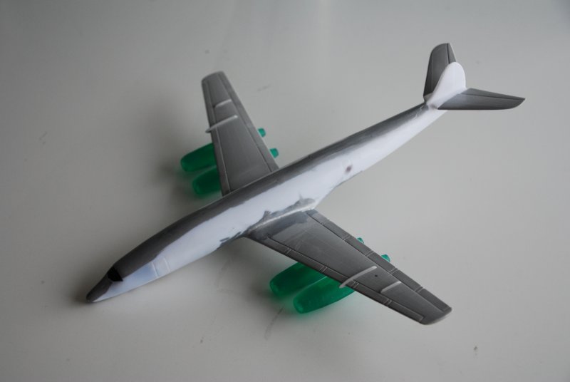

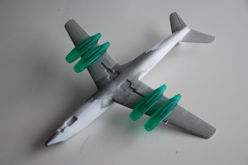

The jet engines are now added to the wings. 4 of them are enough :)
But because of then, I cannot use the original landing gear of the Caravelle, it is too short (the one of the L1049 does not fit under the wings at all). So I have to make a new one.
First tests are printed and I will continue in this direction.

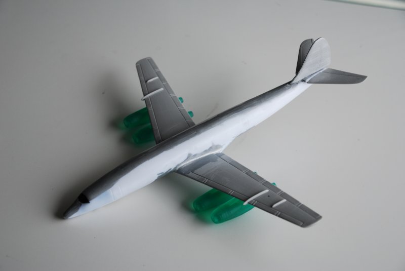

Quote from: salt6 on October 13, 2019, 06:57:27 AMI think you'll need a little bit more rudder.
As salt6 pointed out, the rudder was too small. So I am working on a bigger one. Which basically a scaled up version of the original one. A first test print was made, now i can make the "real" one:

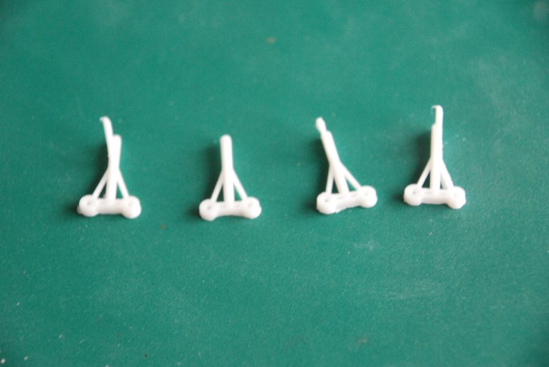

Besides this, the new landing gear is now made. The front one is the original of the L1049, the main gear is printed, the wheels are taken from the Caravelle kit:
How strong and stable are 3d printed parts compared to injection moulded styrene or resin?
Resin will bend over time if there is weight on it (don't ask me how I know that) while injection moulded styrene is more stable.

the rudder was too small. So I am working on a bigger one. Which basically a scaled up version of the original one. A first testprint was made, now i can make the "real" one:
This is even better with the new fin. :thumbsup:
A good question, I don't know. I guess FDM prints (PLA) and SLA prints (Resin) are quite different.
PLA is sensitive to temperature. at about 60°, its getting weak. I had one mount for a thermometer outside which got a lot of direct sun this summer. Its now completly bended. I have some other prints outside to see how they will react to sunlight, rain, snow etc over alonger time.
For the resin, I have no experience so far. The landing gear is made with the SLA printer, so I have to see if this will be a problem after some time.

Looking really nice with the larger fin. I glad you kept the original shape... the curviness of the whole affair is a large part of the appeal.
-Sprues McDuck-
Quote from: TheChronicOne on October 21, 2019, 10:05:35 AM
Second that.  :thumbsup:
nönöbär
The fin was taken form a 3D model of a Constallation. I removed the rest of the plane, scaled it in the size I wanted and printed it. Have to see if I can really use it or make a new print with the Resin printer.
And i will have to see what happens to the printed landing gear after a while. As I do not have this printer fro so long, there is no long-time experience for me with the prints.

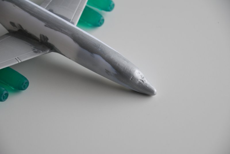

Unfortunately I lost the cockpit windscreen somehow...  :banghead:
So I will close it, sand it and use some decals for it. Would fit better to the passenger windows as those are decals, too.

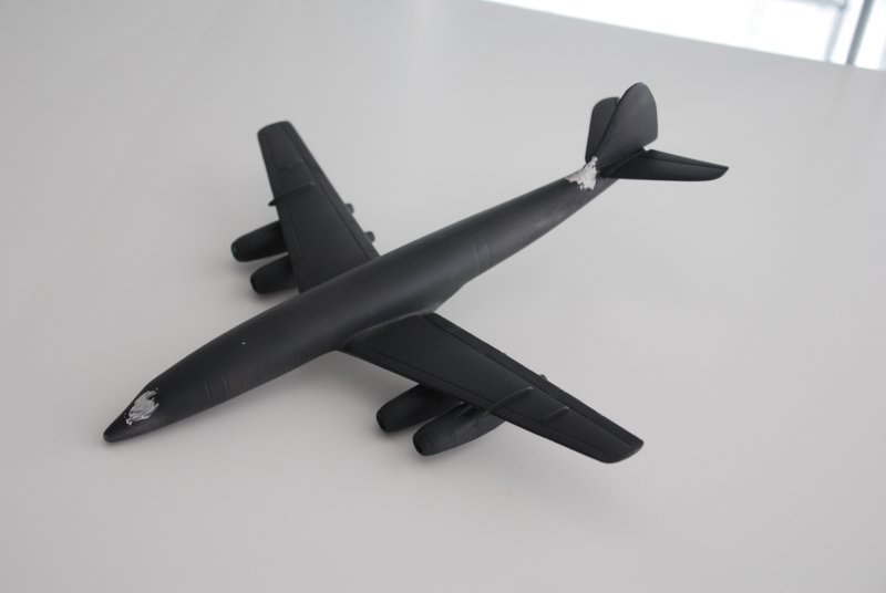

To check if the putty&sanding went well, I did a complete paint over the complete model. Looks as if a few spots are left which need a bit more work:
But i hope I can go to the real paint job soon.
