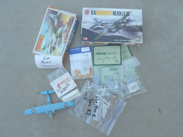

It's upcoming, but maybe a ways off while some vacations and medical procedures take precedent. But...
The pic shows the elements. I will combine whatever features of the Airfix and Matchbox Mossies I can use. I may extend the fuselage forward a couple feet (maybe not). I am keeping the glass nose of the "standard" Mossie, but will most likely put "halibut" individual canopies (a la American Douglas B-42, but provided by a 1/144 Catalina!) on top of a re-worked fuselage. The "Highballs" might need to go in a bulged bomb-bay (aeroclub aftermarket), but the Highball armament is the essence of the model, so the bomb-bay will be open. The Pegasus Spitefuls will provide the Griffons' nacelles, and old Hawk Spit. 22's will provide the 5-bladed props (though two Hurricanes will provide blades for the other-handed rotation). This will be American Reverse Lend-Lease, serving aboard the massive carrier "USS Lafayette" (a "Furashita's Fleet" re-make of the French liner "Normandie"). Livery will be summer-of-'43 red-outline Stars and Bars, tri-color sea camo American-style. Maybe the moniker "Wooden Malaria" under a mosquito motif. Wings will have a "fold" mark, but I ain't gonna do a "real" folding setup like the complicated-but-successful Jinpu-Kai I did previously. IJN take notice!!
The Spitefuls are too small and will look too Supermarine.  May I suggest the Airfix Firefly instead or, rather than you cut up a pair of Spitefuls (which I'm looking for and THAT tooling in particular!) I could provide some resin engines?  I'll throw in some wheels, radar noses (three or four types) and cockpit interior too.
And use the Airfix kit all the way.  The Matchbox one is nowhere near as good and the plastic is thinner - the Airfix one withstands heavy sanding much better and will take that Paragon conversion.
Props.  If you've the Aeroteam or Eduard Spitfire F22, it's got a contraprop arrangement.  If you've a pair, that'll give you handed props with some creative use of the blades.  Trust me on this as I've done it for something else. Alternatively, the prop blades in the Spitefuls have no real pitch, so could be set to suit.
Highball used a modified gunsight, not a proper bombsight, and the fighter cockpit, with an armoured nose and bulletproof windscreen would be far better for attacking ships.  The Highball bay was open anyway.  Paragon revised the bay which looks not unlike the bulged bay of the B/PR16.

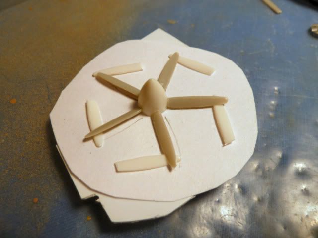

I wanted to make "handed" 5-bladed props for my Flounder. The Hawk Spitfire 22 prop blade was good for the "typical" Griffon rotation, but I needed one for "normal" rotation. I took the Hawk Spit 22 prop (using two of them for the Flounder), traced it onto some cardstock, made a plastic holder from scrap (the Spit prop had a protruding central post, so I had to make a "stand" for it), snipped off the 5 blades cleanly with a nipper, and measured the individual prop blade length. I searched for the right shape/length of blade to use, and found, after much searching, that the FOUR-bladed props of the Airfix Mossie kit (comes with both paddle-3 and thin-4 blade props) were the best shape match (I was going to use a Williams Brothers Martin B-10 set of props, also the proper shape, but that would "ruin" an otherwise intact, rare kit). I then snipped five blades from the two 4-blade props and affixed them according to the template. I used the snipped 5-blades from the Hawk prop to "rest" the new blades in the right place. Voila!

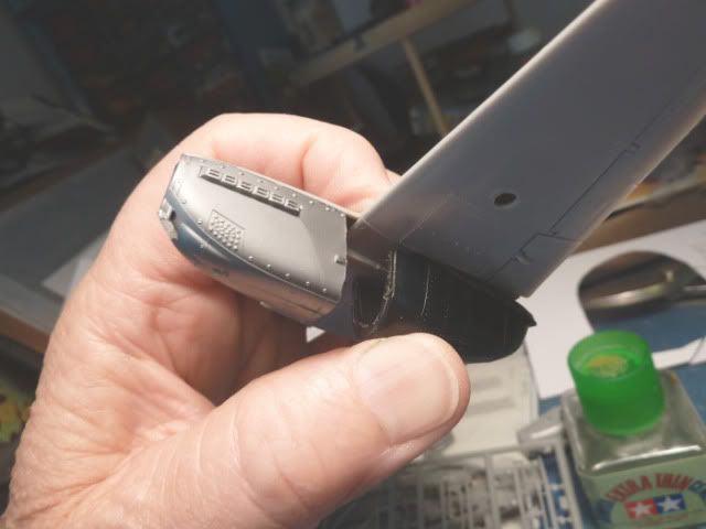

I wanted to use the Twin Mustang nacelles for the Flounder, and am now affixing and futzing to do that, using the forepart of the Twin Mustang, and Lancaster outer nacelles. The outer nacelles were too short (there was a deliberate rear overhang of the Mossie nacelles for better airflow) and the Lanc's longer inner nacelles were too wide. So I am forced to do a composite to get "my" nacelle. Trial-and-error, work-in-progress!
