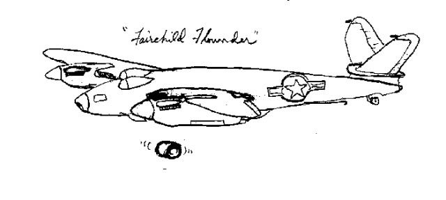

I just received a TREASURE TROVE of goodies from "Wooksta" that I plan to incorporate into my "Flounder". Since I got an extra set of Highball rotating bombs, I may make a "tray" of three in the bombay instead of the "standard" two. I plan to lengthen the nose a bit anyway, and move the tailplanes (now formed into a "T-V" tail) farther to the rear to balance the look (luckily the Mossie had a long tailpiece there). The bug-eyed "Flounder" will look somewhat like my crude hand sketch below.
OK, you can wipe that silly, disbelieving grin off your face, now!   :blink:

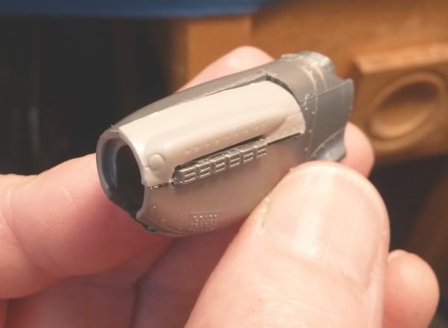

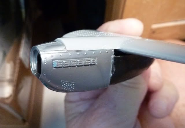

For my "Flounder" I wanted the "muscular" Griffon engine-cowl look with the bulged rocker-arm covers. I acquired some nacelle "tops" with the requisite bulge, and hoped to adapt them to my Flounder's "Mustang" cowls. Here is the yet-untreated cowl:
I got a test-piece from another 'Stang, and CAREFULLY cut out the nacelle top over the exhausts....:
...and fitted the new "Griffon" tops over that---I like it!
Now that I know it can be done, I will do it on the model itself!

I did test-fit them, but I like the "American" look of the Twin Mustang cowls better. I have some filling-in-of-gaps to do, and a little (NEVER really only a little, is it?) PSR, but the "Griffon" tops you gave me fill the bill for the "muscular" cowling look I sought.

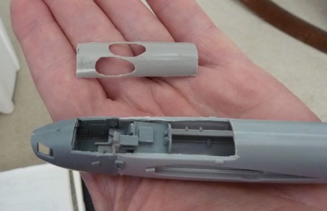

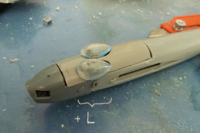

Here is the delicately-cut top fuselage piece (from the bottom of a Matchbox Mossie) that will go over the cockpit. I used the excellent Tamiya cockpit and forward fuselage, doctored a bit to fit the "burly" pilots that will be squeezed in later. Unfortunately, the bubbles will obscure most of the interior from view.  :angry:
Then, here is the "cover" in place, with the 1/144 Catalina (salvaged from another's throw-away pile) side bubbles as individual canopies (TIGHT squeeze). They are too bunged-up to use, and a Vac-U-Formed pair will be too much wider, so I will acquire a fresh Cat to borrow from. You can just barely make out the pilot's heads. In this view you can see the "lengthening" of the Mossie forward nose. That little raised triangle (trapezoid?) in the middle of the side is part of the wing-root radiator in both Mossies, so that measures the actual lengthening (good for an additional Highball underneath, too!). The Twin Mustang cowls will jut forward more than the old Mossie ones, so the nose "protrusion" will not be so pronounced when I'm done as one might think. Really, it will look like a Mossie when I'm done!
PSR-ing this will be a nightmare, as I need the cover piece to blend in with the lower fuselage and nose, but need the cockpit painted and pilots in place before that. I'll improvise.

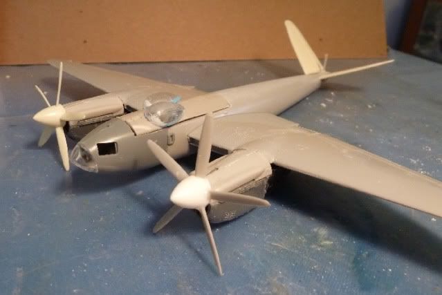

Aha! Fairchild's US Navy manufacturer's designation for Fairchild Aircraft Corporation was "Q", so my Flounder designation is quite appropriate (my "Douglas Decimator" being the TB3D)! So "4Q", enemy ship--The Flounder is "comin' to git cha"*!!

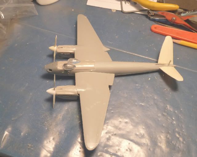

Below is a mock-up of the main Flounder parts minus the Highball apparati below. The "post" in the tail is merely a guidepost for proper final fixing of the Vee-tail's angles (they are a little askew in these photos). I made a slotted paper template for the tail looking like a chicken-foot that will use the post as "vertical" and has cutouts at 45 degrees left and right for aligning the tailplanes (aftermarket resin ones from Wooksta with enlarged mass-balances). Eliminating the "forward" vertical tailplane (dark stretched oval) and moving the horizontal tailplanes out to the ends of the tail visually "elongates" the look of the rear fuselage to "balance" the lengthened nose.
In the view below you can see the bulged "Griffon" engine cowlings (note "handed" 5-bladed props!) and the crew blisters better.
