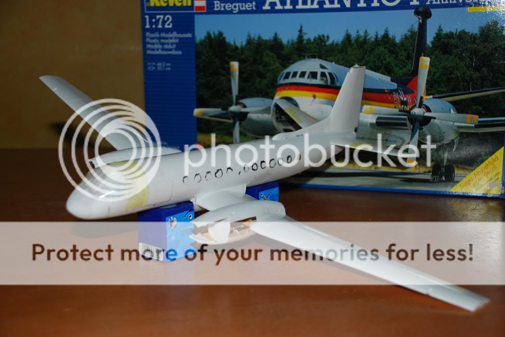

So if Avro's had built the Atlantic MR.1 (not a bad idea considering the possible export markets that the "British side of things" might have brought the NATO project)
Might they then have carried on with a small redesign and produced this as the Andover?
As you can see its not even cut out yet, but I'm thinking Dark Earth, Middle Stone, Black, "D" type Roundels etc,
Some details need working out; Like nose treatment and tail (Beaver tail?)
profiles ,comments, Brickbats etc welcome!. :thumbsup:
I should of course explain that Avro's decided to modify "their" Atlantic design and that the black shaded lines are meant to represent the portions of model requiring removal, and the bulkhead should show the "new" fuselage shape!! :banghead:
If you see what I mean :unsure:
TallEng
 Well just like the "Ahem" Andover really, so faired into the bottom of the Fuselage. If you Wikki HS Andover there is a link to Airliners.net, with loads of pictures of Andovers, and you'll soon see the fairing thingamy I have in mind :thumbsup:
TallEng
Well its been a long time since I've posted anything. But Summer is over and i am back with the plastic :thumbsup:
And I have restarted the Alternate Andover project, At the Moment its all held together with masking tape, but I guess you can see the general idea,
showing where the windows might go
The shape of the rear fuselage needs flattening I think to allow a rear door for loading/unloading (like a Herk only smaller)
What do you think?

TallEng
Andover progress report, Not much really what with working shifts and decorating the living room. Still on with the update!
Main fuselage now stuck together, and the start of sand/putty/sand etc to fair the lower sections in to get that "round" shape as against the `double bubble' of the Atlantic
Cockpit glazing fitted temporarily to allow shaping of the new nose (8 discs of plastic card sanded to shape)
Underside view showing strengtheners fitted to support the wing join. When the wings are finally cemented on I will remove the rest of the original fairing.
And some additional views showing how it might look all together ;D
Along with the box top showing what Revell had in mind should be constructed from the contents of the box :lol:.
And now the bit that I have conveniently ignored up to now; How do I do the cabin window glazing? :banghead:
Anybody got any ideas? simple would be good, I don't want to overtax my limited modelling skills :unsure:

Quote from: rickshaw on December 01, 2010, 03:20:45 AM
Two alternatives - Microscale KrystalKleer (which is basically PVA white glue).  The other is to simply place thin clear plastic behind the openings.
The openings for the cabin windows are approx 10mm diameter and I am not sure that KrystalKleer will stretch that far?
