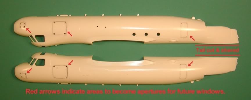

(In sotto-voce: Baz, would you explain to me the little holes in the future windows?)
Yes.  The pencil lines are the final, hoped-for perimeters of the window openings.
The drilled holes help me aim for the corners as I open up the windows and leave the corners tight but still a bit rounded off.
I'll show some in-progress pics once the Dremel comes into play.  I was supposed to get to this today but I had to do some really early Christmas shopping instead.
Heh, heh, Christmas shopping in February.  I make the funny.
If you dust off the archives and find my World's Ugliest Helo thread, I think I had a pretty good series of how-to-pics on this technique over there.

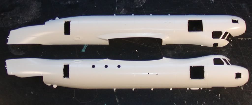

Here are the three window openings, rough-cut with a Dremel ™ tool at this point.  Looks blecch so far but I can now file them to more decent apertures.
I only made one genuine screw-up that bit past the outline (which means filling an edge to be straight----not easy).
mmmm....pretty.
But I now see that the starboard pilot's stepside window is bigger than the port version so more filing to come.  But still looks better than the pic above!   :)
