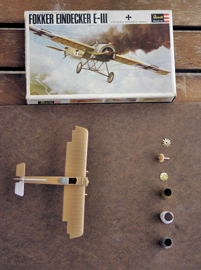

A few years ago, I bought a handful of 1/72 WWI planes. Most were old Revell kits and one pristine ESCI Neiuport 17. The Revell kits were in bad shape, and most were missing decals, instructions or parts so I got the whole lot for less than $10.
The worst of the lot was a Fokker Eindeker E-III. It was missing several vital parts and the plastic was about as brittle as a resin kit.
I decided to make the most of what was left, and came up with the idea of turning it into a variant of the Morane-Saulnier type G or H, which looked remarkably like the Eindekker.
To make it WIFFier, I wondered what if the Coanda powerplant had been developed past 1910? It wouldn't have displaced piston engines due to the high heat and fuel consumption. But what if in 1915, Messrs. Morane & Saulnier had developed an engine with a performance that rivaled or surpassed existing designs? For one, you wouldn't need an interrupter for the guns.

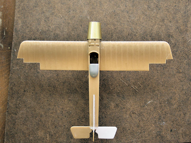

This is what I have so far:

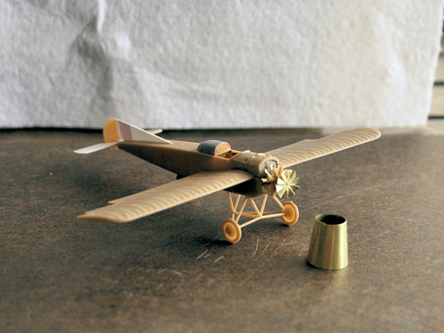

Most of the white parts (like the tail plane) are replacements. I also added ailerons because wing warping is so 1914!

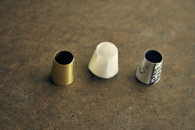

I used ShroudCalc to produce the pattern for the cowl. The first one was of paper, the second out of a Coke Zero can, and the third out of 0.005" brass:
It was incredibly easy to produce the cowls - less than 10 minutes each from start to finish. I crimped the metal cowls, and the results I think, look very WWI-ish.

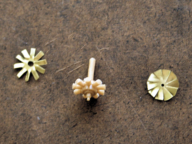

I also printed out patterns for the impeller/fan. I didn't like the first fan, so I made a second, with wider blades. The first fan will now go behind the rotary engine. The second will act as the compressor:
Here's a top view with the cowl attached:

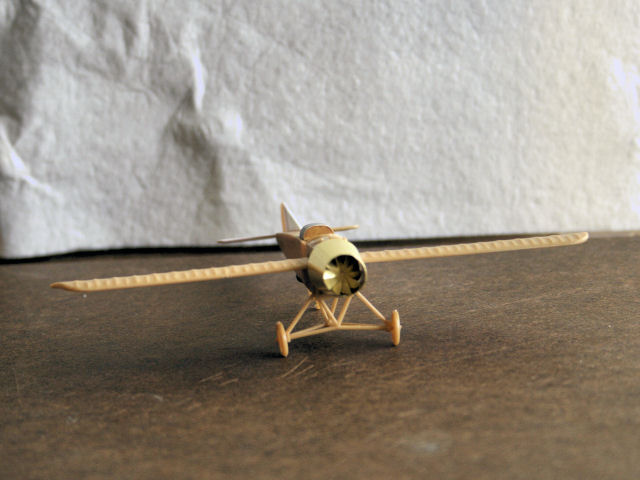

A front view with the cowl removed:
And in place:
The headrest area is half a lifeboat from an old Revell T-2 tanker. I still have to add some more details (instrument panel, add the seat, guns, some rigging) and add blast deflectors under the wings. I moved the tail skid forward to keep the plane level on the ground. We don't want to start fires on takeoff!

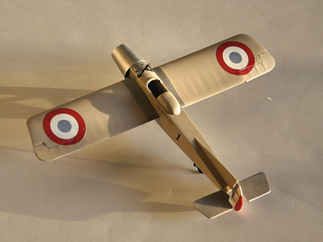

Progress on Le Petit Pet!

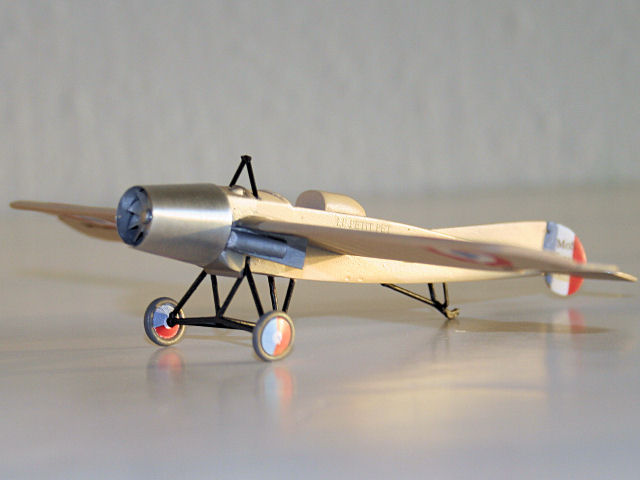

I made some decals and painted the plane in tan.  The areas that would get hot on the wing roots and the elevator were painted in steel and represent aluminum doped wing surfaces, or aluminum covered wood. I sanded down the upper surface of the main wing because the rib and fabric effect were just ridiculously overdone.
Here's a beauty shot from above:

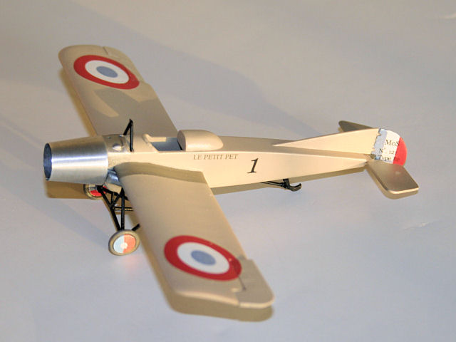

This is a low port side view. I moved the compressor blade forward and remade the cowl out of aluminum from a soda can (or aluminium for our UK friends) because nothing says aluminum like aluminum! I also added exhaust tubes and a blast deflector and moved the tail skid forward.
This is another side view:
The tail codes are completely made up. The lower letters "Type Rc" stand for "Type Reacteur-Coanda" The aircraft nickname is only on the left side.
I made decals for the wheels because I just didn't want to paint them.
Still left to do is add the cockpit fittings, one or two machine guns (that I'll have to scratch build) a windscreen and the most "fun" part, the rigging... which I'll make as minimal as possible.
Frank

For rigging, I suggest .009 steel guitar strings. You can cut them easily to length with a good pair of nippers and secure them to the model with white school glue like Elmer's™. This is by far the easiest rigging method I'd discovered.
I'll be looking forward to your next update on this little beauty!
