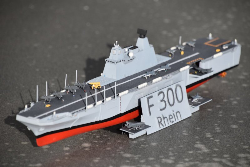

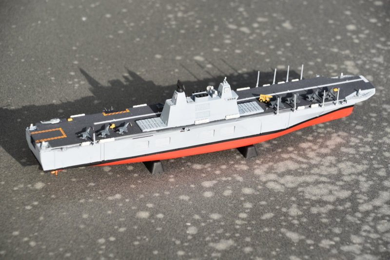

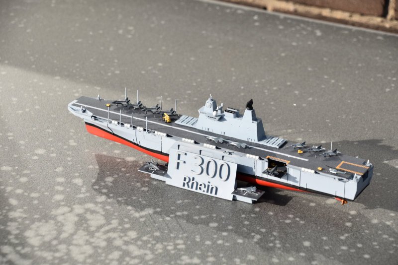

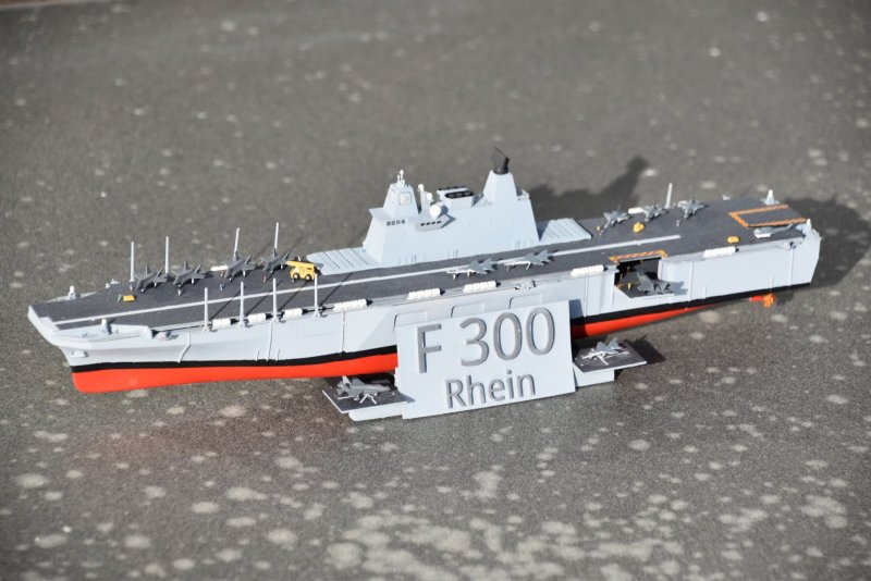

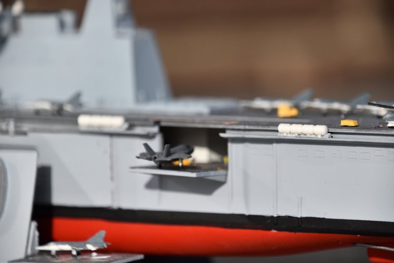

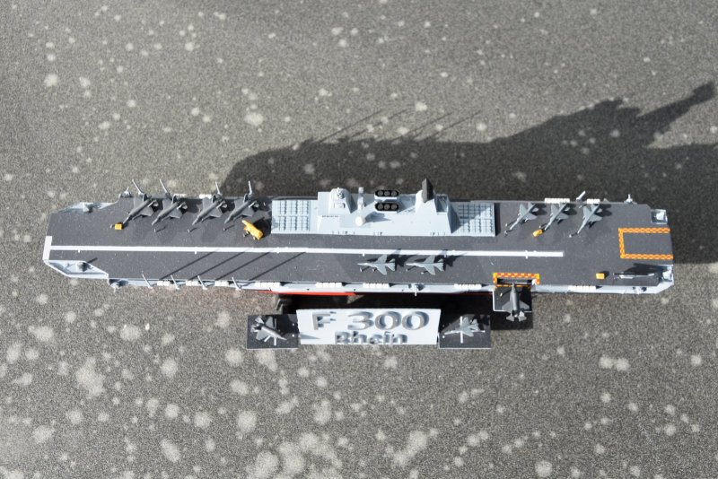

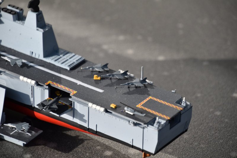

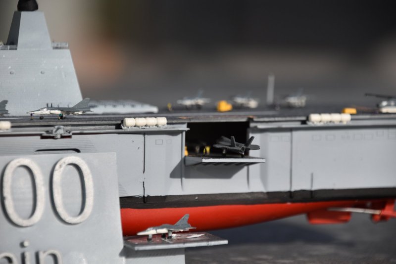

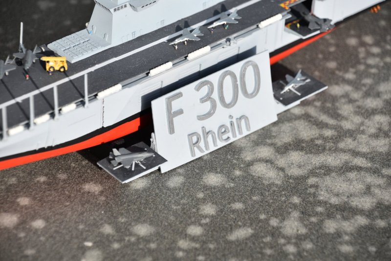

The model
This build is based on the Revell 1/720 USS Tarawa LHA-1 kit. The well deck was closed, and 3D-printed hull extensions were added to the sides. Visible hangar sections were also custom 3D-printed.

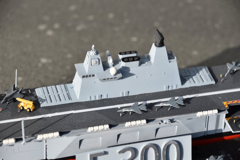

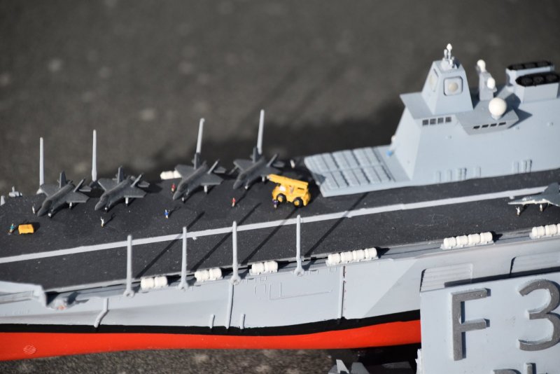

The island superstructure was completely replaced with a newly designed and 3D-printed version. Several sensors and weapon systems, including VLS and CIWS, were 3D-printed; the CIWS models were sourced from Thingiverse.
Aircraft such as the F-35 and the EADF Skua (based on a Mirage F1 model) were also obtained from Thingiverse, resized to scale, and 3D-printed.
Additional photo-etched parts were incorporated, and the model was finished with Revell Aqua Color paints.
