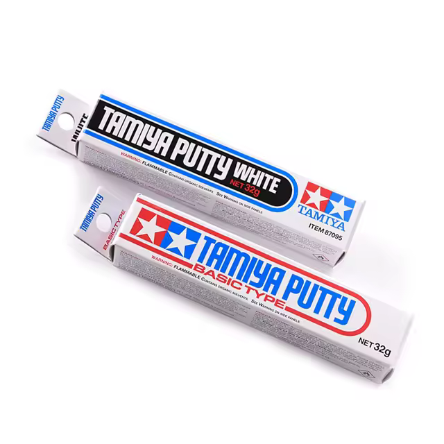

1: Aves Apoxy sculpt
2: Tamiya Basic (grey) & Tamiya White
3: Perfect Plastic Putty
