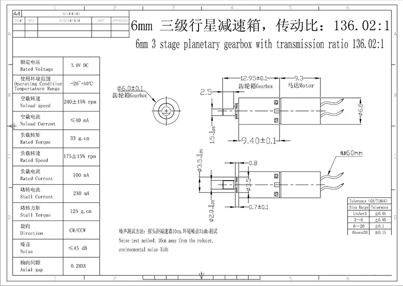

Y'all might recall my project motorizing the Atlantis B-36. Motors arrived a couple days ago, and while I'll need to do a little cutting on the lower wings in the nacelles the fit just fine - the bad news is they're a direct fit, shaft pokes right out the prop hole with no room for a driveline or spline so I'll have to cut the propshafts and drill and epoxy the hubs.
https://www.aliexpress.us/item/3256807876109017.html
3v CR2032 battery turns one at acceptable speed, haven't tried two and gotta find my wirestrippers first. At 40 mA draw,  what am I looking at needing to keep all six of these turning? I'm also toying with the idea of a two-stage power switch that would run four motors on two batteries on "slow cruise" then connect a third battery and the other two motors on "full power".

Kerick, I already have the motors I linked in hand (which appear to be different vendor same product WITHOUT the highway-robbery shipping). Manufacturer spec is 240rpm at 3v.

Am I misfiguring that six motors at 40mA load each means I need a 240mA supply? Explain like you're talking to a second-year high-school Electronics Tech student 25 years ago who needs a refresher course, please. :)

Update... an electrician buddy and I figured two twin-pack AA's in series-parallel. Each two-battery clip is in series for the 3v, then two such clips in parallel to get the amps up. Have six motors, have the clips and a multimeter, now I gotta figure out the resistance for a voltage-drop on Low Speed. Wish I could find a switch that looked like a tiny throttle quadrant...
