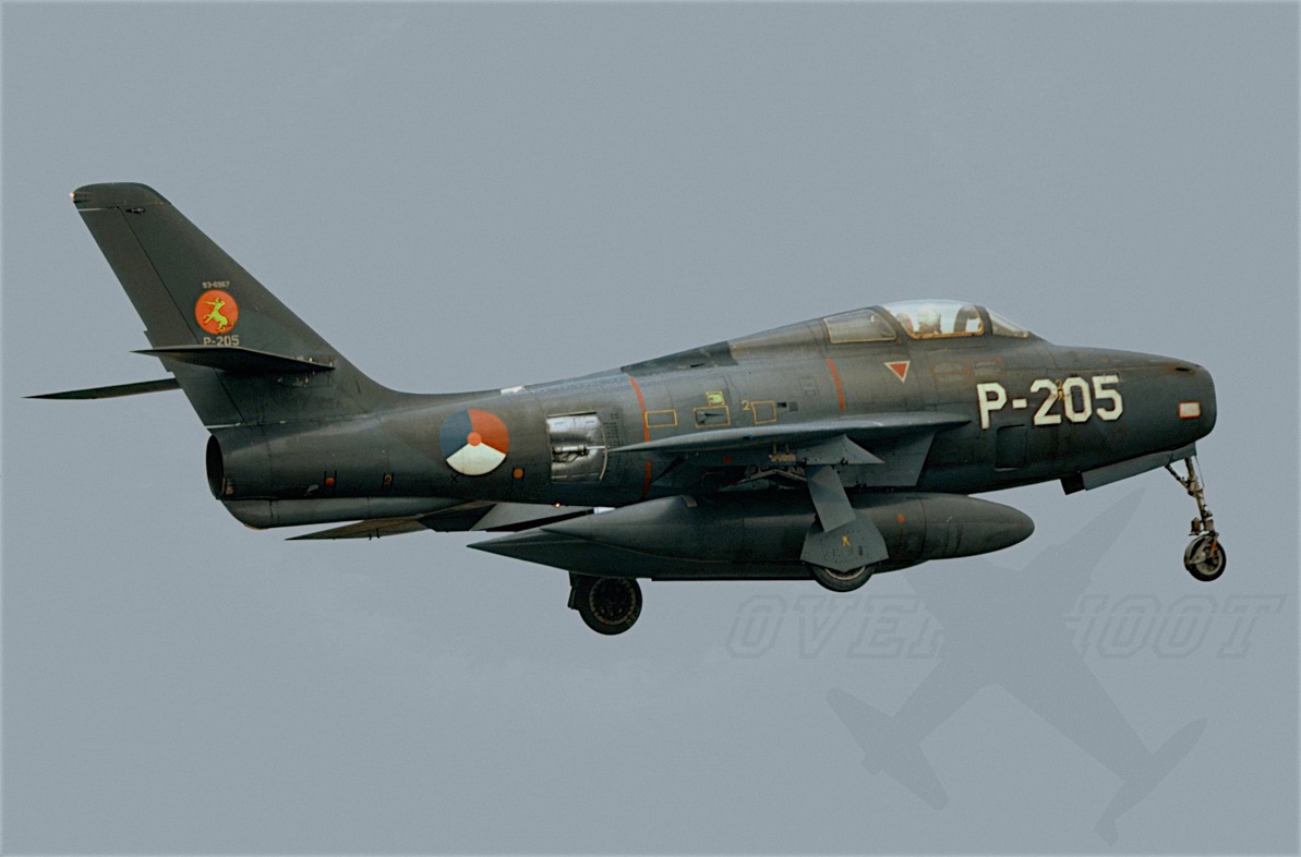

Now - looking at in service photos, none of the above seems to be installed, as very clearly shown in this pic of a Dutch F-84F on short finals.
Which is correct? Were there wing root guns and slats in service?

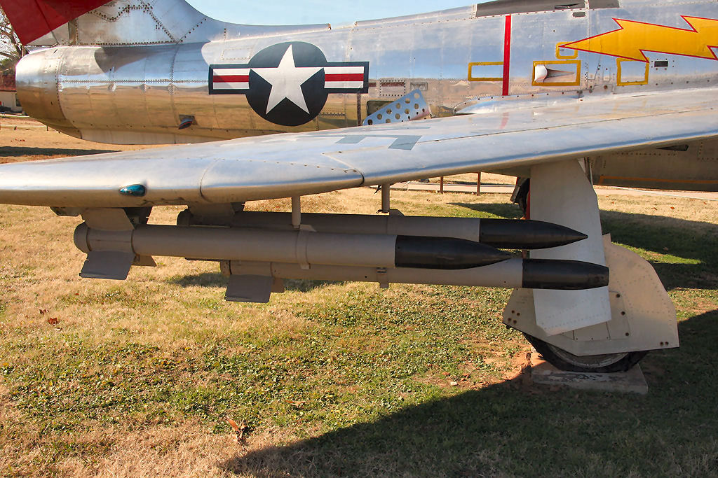

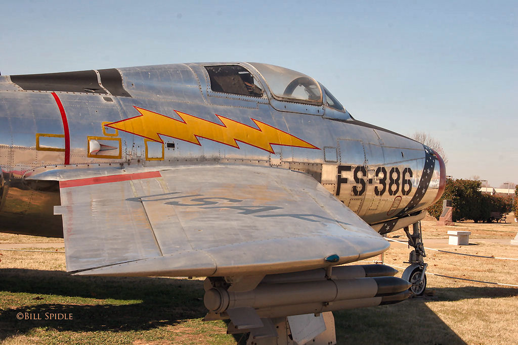

These photos, USAF F-84F, show what appears to be a separate, movable leading edge section, but again,
I think it's a leading edge flap not a slat. Which probably would not be deployed on the ground.

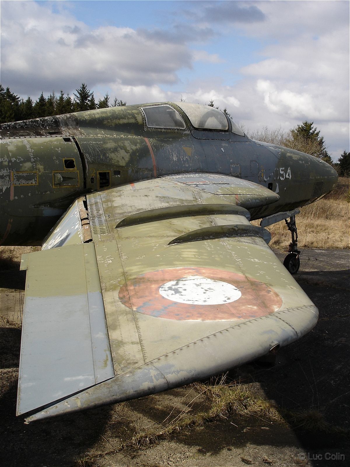

In this photo the same section appears to be fixed.
However on the RF-84F wing, with fences, the leading edge in that area definitely appears to be fixed.
Also looking at the photos of the dedicated fighter-bomber versions, the position of the outboard pylons
makes having a movable section of the wing in the same area rather doubtful.
