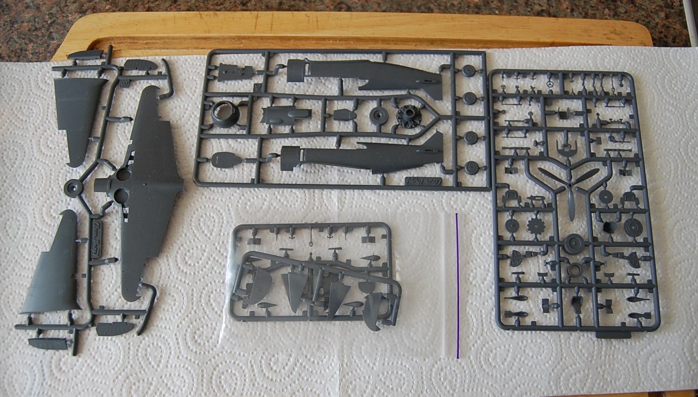

So here's the Box and sprues etc.
Box and instructions
Sprues
Bits and bobs
Very impressed with the La-5, level of detail is excellent, you can even make out the maker's name on the tyres. Fit so far on the interior is good, so hopefully that will be true for the rest of the airframe.
The kit has an extremely detailed and intricate cockpit interior. When I got this kit I obviously clicked on the "advanced" rather than "starter" kit option. Clear Prop offer most of their kits in both versions. The starter kits are excellent and the advanced consist of the starter plus masks and an awful lot of etch. The instructions are tailored to the kit however so they are not your normal style of "this part or the optional etch" etc. Means if you lose the etch you have to work out which bit of plastic it replaced which is not always obvious, especially when it comes to some of the internal parts. Does mean your spares box has a good day though
