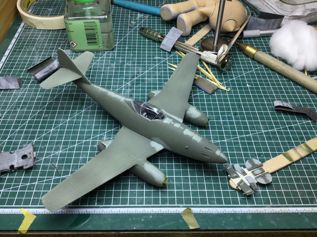

The graphic novel isn't bad, but it gives me all the excuse I need to kick off this project - so who cares? It's still early in the game, so standard construction doesn't really need much commentary. However, I did squeeze in 8g of lead into the nose as per the instructions. While doing that, I ran across some good advice warning against using CA glue.  Apparently it will react with the lead weights over time and eventually produce enough white powder to pop the seams.  So I used white glue instead.

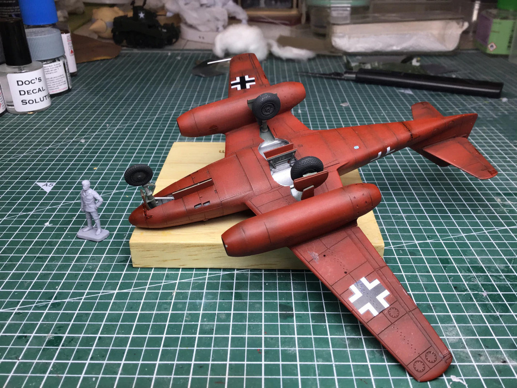

I've heard there are some shape issues with this Academy kit, but it goes together like a breeze. I did add some putty to the joints, but mainly as a reflex action. I'm try to take my time and "get it right" with this build and I'm happy mostly how it's coming along. I did the best I could on the sanding and it seems to have paid off.  I then used Tamiya XF-22 (RLM Gray) as a base coat for the entire plane and then gave it the works with XF-7 (Flat Red).  With a bit of undershading and some panel washing, I really like how the black adds some depth to the red.
The one thing that bugged me though, is I'm missing parts - two bits of the front landing gear. I sacrificed the diagonal support strut to the carpet monster all on my own, but after checking the sprues shot, I realized I never had the side door for the front wheel bay.  Obviously both can be replaced with a bit of scratch building, but what a pain.

I'm still plugging away at this one, and added a few of the decals. I also had to scratchbuild a couple of missing pieces (one that I sacrificed to the carpet monster, the other that seems never to have been in the box).

As it turns out, the carpet monster returned my missing landing gear strut... seemingly out of the goodness of its heart.  I'm SURE I swept that floor three times... and then, there it was!
I have a few more touch ups to do before I call this one done, but the major build has been completed at least.

Thanks guys. I put the finishing touches on last night.  All in all, I'm pretty happy with how it turned out. It's basically the DC Comics version of What If the Red Baron had survived and fought in WWII... who can resist that idea?
