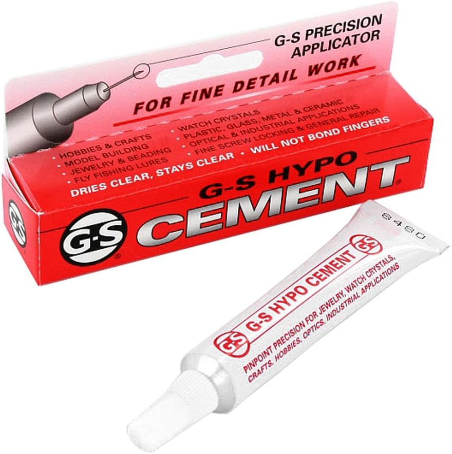

I use "Watchmaker's Glue".  Get it from Evilbay, usually from the US.  I have been using one tube for about 18 months and have a spare.  Fairly cheap.  It is a clear glue.  Sticks like all buggery but won't fill gaps.

This is what Brian is referencing. It's also one of my preferred clear bits adhesives.
https://www.amazon.co.uk/Jeweltool-Hypo-Cement-Twin-Pack-dp-B00PKGSBKA/dp/B00PKGSBKA/ref=dp_ob_title_kitchen

That's the stuff.  Stick like all buggery after a while and is dead clear.  No good for filling gaps though.   :angry:

I generally use simple white casein glue, because it is water-based and, once dry, becomes almost transparent. Slightly thinned the stuff can also be used to fill small gaps.
Never heard of the watchmaker glue, but it sounds interesting.  :thumbsup:
