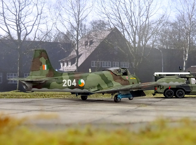

1:72 BAC P.84 "Jet Provost" T.51; aircraft "204" of the Irish Air Corps (An tAerchór) Light Strike Squadron; Casement Aerodrome/Baldonnel, 1968 (Whif/Airfix kit)

The kit and its assembly:
This fictional Jet Provost is, after a long search for a proper aircraft model, finally the result of the attempt to build an Irish what-if aircraft. Inspiration struck when I recently read a book about the Jet Provost’s and Strikemaster’s development and service (which also spawned the BAC Bushmaster single seater) – I thought that an armed Jet Provost would have been a highly probable aircraft for the Irish Air Corps, and from the start I wanted to add a tactical touch to the model, not just a pure trainer.
The armed export variants appeared the most suitable option, and thankfully Airfix recently released a new T.3 kit, which is virtually identical to its armed T.51 brethren. The kit itself is excellent. The molds are crisp, you get recessed panel lines and minute detail where it’s needed – but it is still a very simple kit. Other selling points are two very good pilot figures and seats, two optional canopies (for closed or open display) as well as a superb overall fit of everything. A really pleasant affair!
by dizzyfugu, on Flickr
The kit was built OOB, with just a few minor mods: under the air intakes, machine gun ports were added as well as casing ejector fairings. I also added a pair of underwing pylons (for a pair of 250 lb training bombs) and a pair of R80 SURA missile packs (from a Matchbox Strikemaster). Some antennae were also added, as well as gunsights on the cockpit dashboard.
Painting and markings:
Even though I wanted the Provost to be a trainer, I did not want a flashy livery - instead I adopted a tactical camouflage that would be suited to the greenish environment of Eire. The only "official" Irish camouflage is a uniform dark green, though, and I wanted something more flashy.
Another factor was a tin of "RAF Lichen Green" (Xtracolor) that I found in my collection - a tone whioch I wanted to incorporate. I eventually settled upon a three-tone scheme, somewhat inspired by the SEA scheme that Strikemasters from New Zealand and Singapore carried. I recycled the pattern, but changed the colors so that the green hues became more prominent:
- FS 30219 (Tan) became Lichen Green (Xtracolor X024)
- FS 34102 (Medium Green) was replaced with FS 34079 (Modelmaster 1710)*
- FS 34079 (Forest Green) became RAL 8027 Lederbraun (Revell 84)
- FS 36622 underneath was replaced with Fs 36375 (Humbrol 127), a tone that comes close to RAL 7040 "Fenstergrau", another color that has been in use on Irish Air Corps vehicles
*This was used to simulate the dark green tone "Akzo Nobel 042002" that some real Irish aircraft carried allover; FS 34079 is virtually identical
The cockpit interior was painted in Revell 9 (Anthrazit), the landing gear wells was painted in RAF Light Aircraft Grey (Humbrol 166).

The roundels and some other markings came from a Max Decals sheet (#7220) for Irish aircraft and tanks, the tactical code was created with single white digit decals in various sizes from a Begemot sheet for modern Russian aircraft and the fin flash (without it the tail looked somewhat bleak) was improvised with decal and paint. The stencils were taken from the OOB sheet.
Only light post-shading was done, and the engraved panel lines were emphasized through a thinned black ink wash. As a final step the model received a coat of matt acrylic varnish (Italeri).

After a long search for a project, finally an Irish whif aircraft in the collection! While I was painting the model the three-tone camouflage appeared a little odd, but with the decals everything fell into place, and the result even looks quite natural? It’s certainly an eye-catcher, since the many colored markings, stencils and the ordnance break up the murky military look – even though this Jet Provost still looks purposeful with its training ordnance. And: the Airfix kit turned out to be a highly pleasant build, it’s been a long time that I experienced so few problems during a kit’s assembly.

Oh that is nice and the scheme really suits it  :thumbsup:
I had a senior moment initially and thought "I haven't seen that boxing before" - where's the embarrassed emoji ?  :angel:

JMN mode on.
Side by side two seaters are set up so that the pilot in commend is in the left hand seat. Not in the right hand seat as shown.
JMN mode off.
Still it is Irish so what the heck.  :wacko:
Another cracking model there>  :thumbsup:

JMN mode on.
JMN mode off.
I know... but, unfortunately,  the Jet Provost' interior is so tight that I could only squeeze a single (pygmie) pilot figure onto the starboard seat for the beauty pics.  ;)
Nevertheless, glad you like it.  :mellow:

That seems so right - and looks really good! I like the camouflage. :thumbsup:
Offline Doug K
  • Makes own decals
  • Posts: 401
Excellent, I do like the Irish roundel
