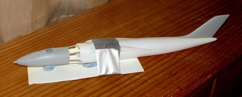

The crucial step, joining the nose to the fuselage.
Note the hi-tech assembly jig, one slab of 60 thou styrene, two slabs of Blu-Tack and a length of Duct Tape......  ;D ;)
I've decided not to use the Victor bits that I've already assembled as they're optimised toward an RW model, and the over-size intakes of the M'Box model will work much better on a Whiffed model.
In any case the Vindicators used the largest version of the RR Conway, the RCo 50, rated at some 22000 lbs thrust and needed the larger intakes.........  ;) ;D

I took the Vindi out of the jig this morning, after leaving it from around 9 pm last night, and I was amazed how strong the joint was!  :o
I'll try that technique on aircraft models again I think, but today I'll start skinning it and see how things progress.

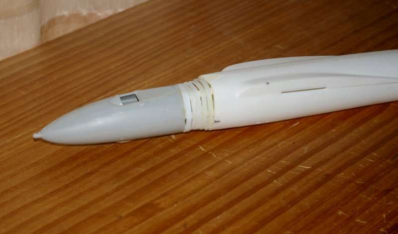

And now it gets REALLY crazy.......  ;D ;)
I thought I'd try something new to fill in the gap between the nose and the fuselage of the Vindi, and used what might become known as the 'Spackman Spiral' to do it. I cut a number of lengths of 20 thou styrene into 4 mm wide strips and then wound them round the skeleton spacers, glueing as I went and holding it all in place with Duct tape while it dried. A few bits came loose but more glue and Duct Tape sorted that out, and it looks like this currently. Weird but it just may work.
I'll put another layer on later today, perhaps with a shaper plate on the top to get the taper correct, and then it'll be the MOAPSR sessions I suspect!
[That's 'Mother Of All PSR' sessions....]
RAFF-35
Wow, that technique has always fascinated me, I can just tell what a miserable failure it'd be if I ever attempt it  ;D this build is looking very good, should be fantastic when it's done, good luck  :thumbsup:
It certainly can get pretty messy if you over-do the glue, which I did at the first attempt.  :banghead:
But the trick is attaching the root end of the strip firmly to start with. I attached it to one of the spacer strips with Duct Tape and then started the glueing at the next spacer along until I'd got to the end of the strip, then went back and glued the starting point, and that did the job.
You end up with having to make two short tapered bits to fill the gaps at the start and end, but that's not too bad if you measure accurately.
