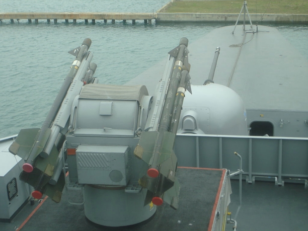

Chaparral (ground-launched Sidewinder) was also available in a Sea Chaparral version. It didn't prove very popular, but Taiwan bought some.
This is Sea Chaparral:
