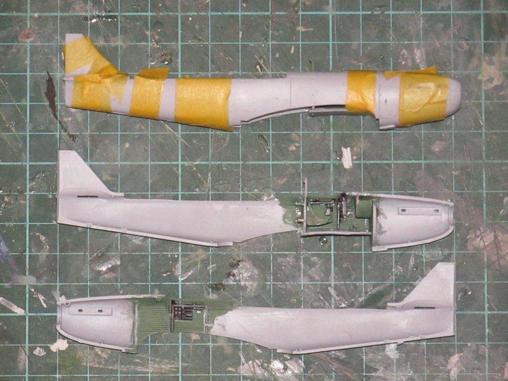

Obligatory box(es) shot.  I took the opportunity for 'Nev time', preparation allowing cutting to remove the spine from both aircraft:

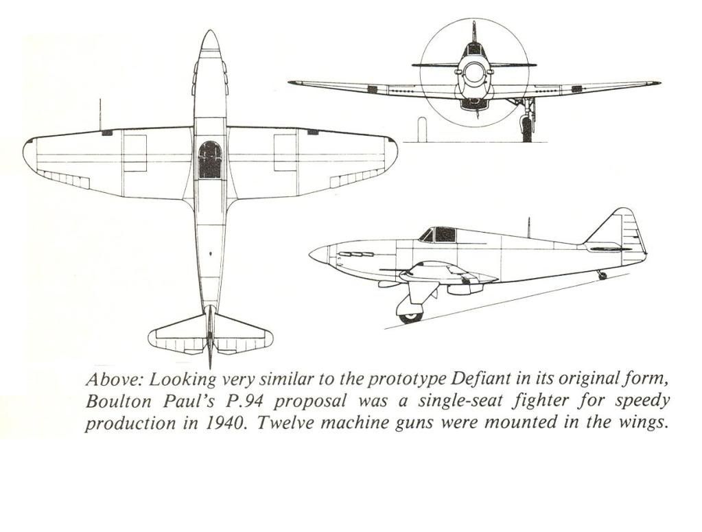

This is my alternative history of the P.94:

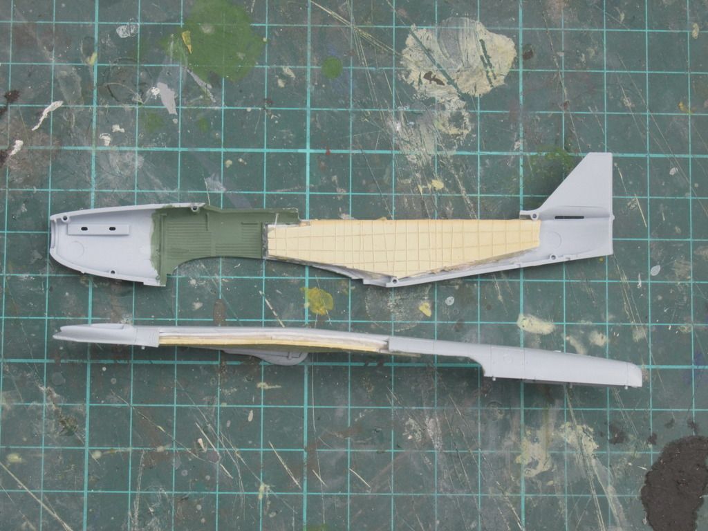

The real snag is that you're probably better off with the OLD Airfix kit, as the rear fuselage bulges out for the turret and thus any single seater is very draggy.  The old kit doesn't have these issues - slim fuselage, amongst it's other shortcomings - and better for conversion work.
Trouble is it's much more effort to correct the old kits problems than to slim the hips on the new one.  What I plan to do is shore it up on the inside then sand the bejesus out of it.  Fortunately for me there's no detail in that area (should be a shed-load of rivets on the real thing).
Didn't get the fuselage together but should have this done by the afternoon today.
As mentioned, I've added styrene sheets to the inside so I can sand back the bulge to get the slimmer rear fuselage for the production Mk.I Valiant (name might change again).  The check pattern is to encourage the styrene to conform to the shape of the fuselage, the first layer was thinner sheet to help with this.
As emergency conversions based on the prototype P.94, I don't need to do this for the Mk.II as the bulge will be retained.
