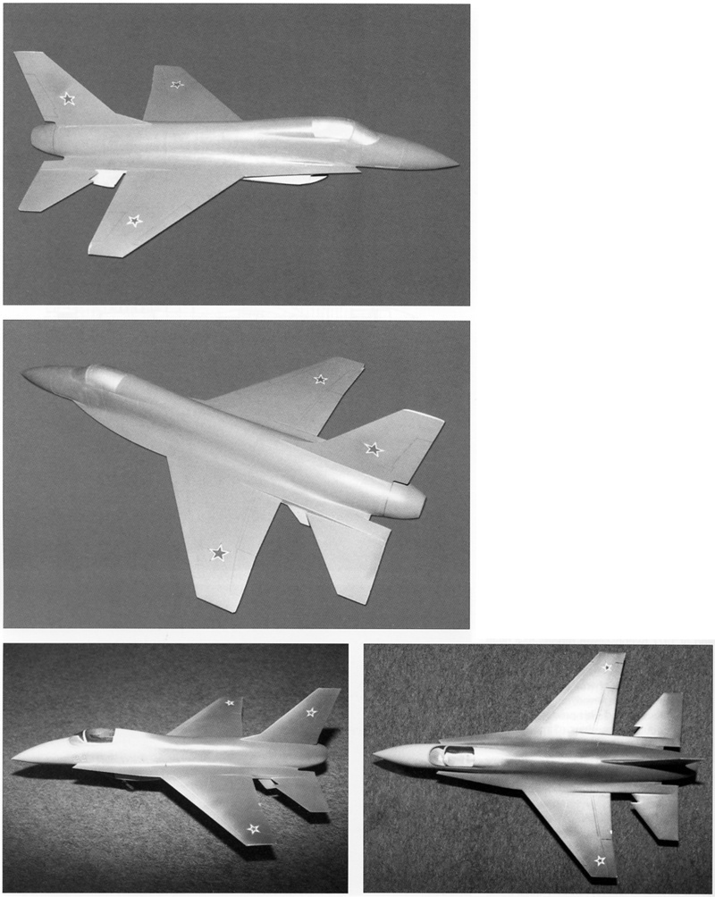

Since things seem to start moving (at least the PR department  ;D), I chime in with the first project: a model of Mikoyan-Gurewich's "Izdeliye 33" - potentially MiG-33, had it entered service or the hardware stage in the late Eighthies. Yes, a model of a "real" project which was killed by the Soviet Air Force doctrine only to operate aircraft with two or more engines. But that would not keep this design from being built for export markets, as replacements for the MiG-21s all over the world as well as some simpler MiG-23 export versions. Vietnam is my candidate for this one. I have a plan.  :wacko:
Information is sparse, and there are pictures of two "Izdeliye 33" models of the OKB that show an aircraft that reminds - at first glance - a lot of the F-16, but that's only superficial:
There also seem to be different chin air intake arrangements, including a split intake like the MiG Ye-8 prototype, while others (like those in the pic) also suggest a simple shovel design.
"Izdeliye 33" was a rather compact aircraft, and my build will probably become bigger overall -  because it will be based on a Nakotne 1:72 MiG-29 (gruesome kit... so wrong that you can only whif it!), turned into a single engine aircraft.  ;D
Stay tuned, lots of surgery and PSR ahead!

Offline kitnut617
  • Posts: 13369
You could use a few of the design concepts of the Chinese J-10 as clues to what it would look like, even use quite a bit of it.
Sort of a cross between the J-10 and the Japanese F-2A

Offline Dizzyfugu
  • Posts: 11709
As a historic side note: information of the 'Izedilye 33' project was actually transferred from OKB MiG to Chin after the aircraft had been axed! These results eventually found their way into the Sino-Pakistani FC-1 fighter in the late 90ies.  ;)
Offline overscan
  • Administrator
  • Posts: 992
    • http://www.secretprojects.co.uk
« Last Edit: January 02, 2016, 02:18:09 am by overscan »

Oh, color pictures from the wood model! Thanks a lot!  :thumbsup:
