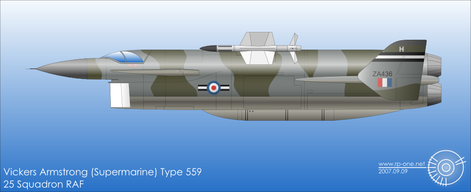

So here`s the basis for the design, the Vickers Armstrong/Supermarine Type  559.....,
Are they Tiger stripes...???   ;D

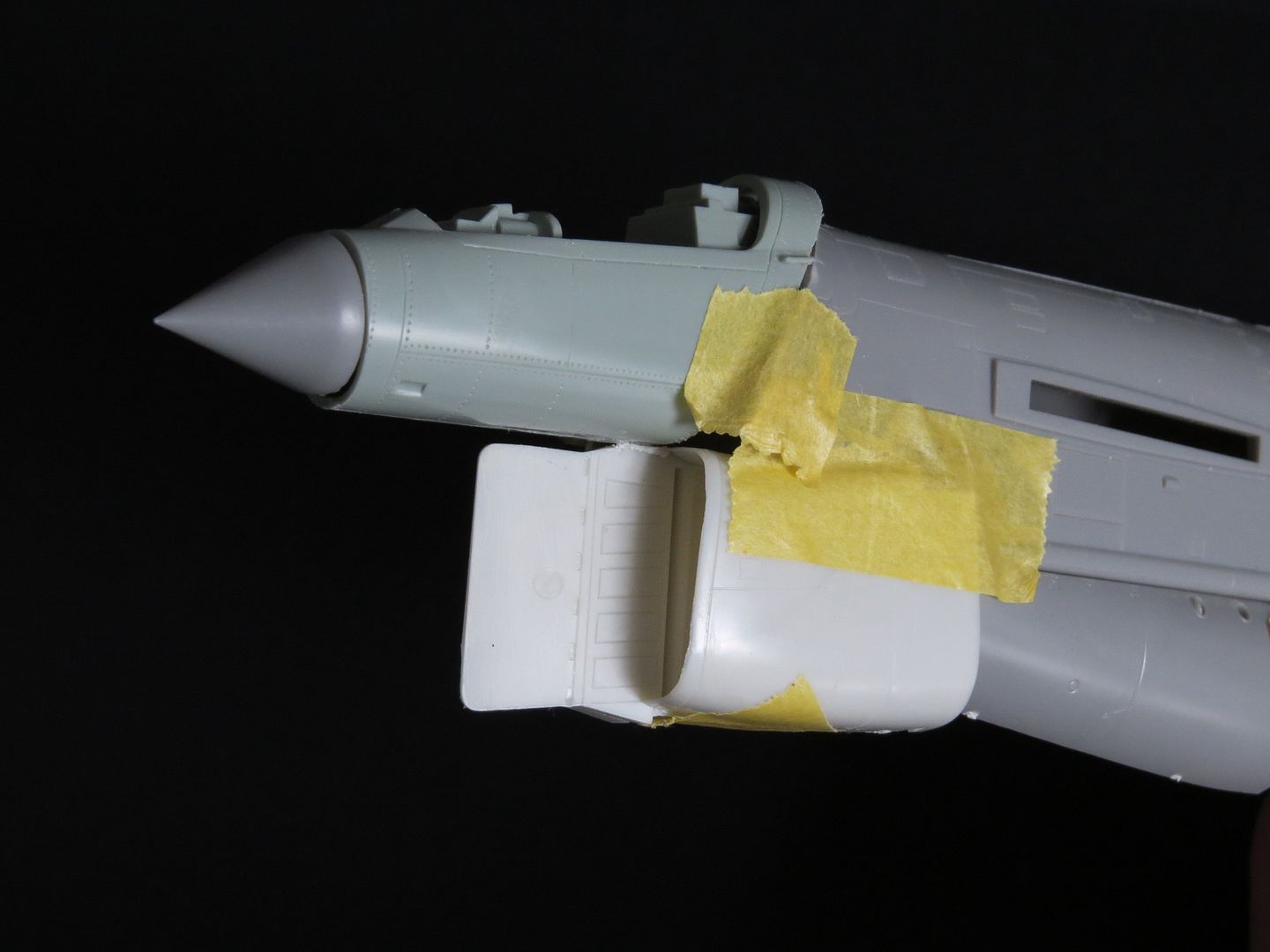

First I`m looking to use the intakes of the F-4 and `transplant` them onto the Lightning....,
Then I be using the wing of the F-4 and sticking that onto the Lightning.....,
I`m going to be using a lot more of the Phantom than shown so not much will be left. Thinking of grafting the front cockpit of the F4 above the intakes and then onto the front of the Lightning fuselage.

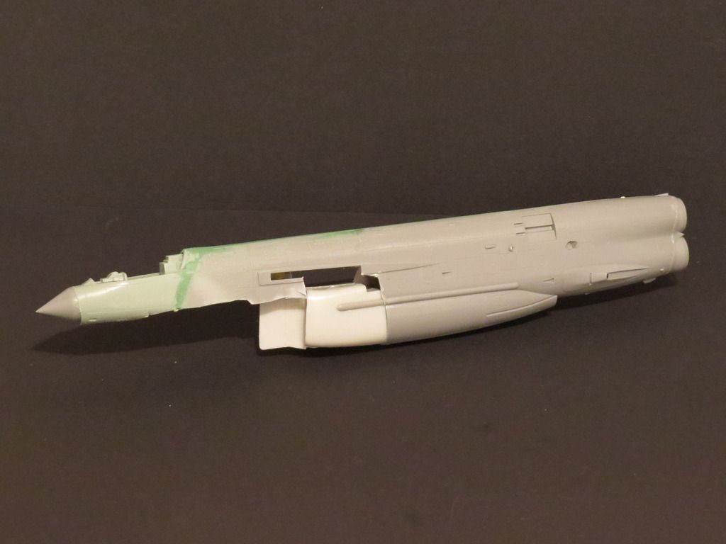

tc2324

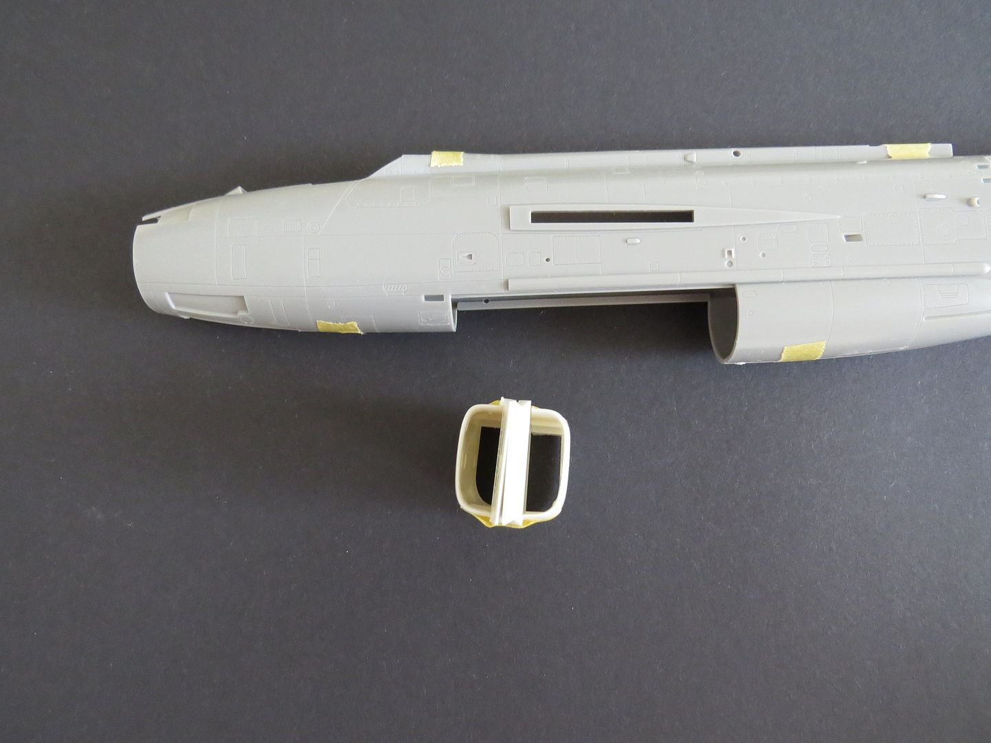

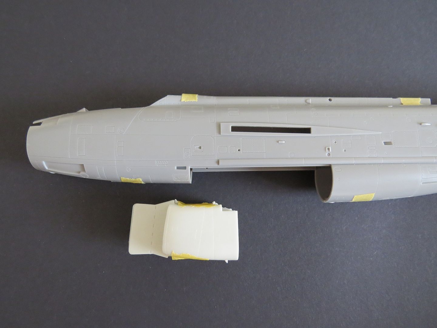

And so with the GB this model is going to be made for a couple of days away from starting, I managed to cut a few bits to size and have a look at the dimensions while not breaking the 25% complete rule.
Pretty it is not.
But as mentioned prior this is not a straight forward copy of the original design and more a version that was developed from the original concept.

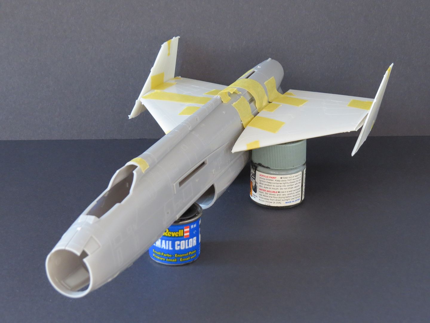

tc2324
So welcome back all to a tc Enterprises episode of `What the feck have you done to a perfectly good Lightning kit..., AAAAAAAGH!!!`
(Not sure that title will catch on..., but anyhoo, moving on .....),
First the pictures and then if you can stand to look any further, the explanation.

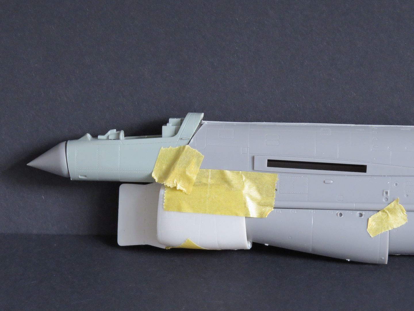

As you can see I`ve been a little busy chipping away at this and that. Trimming down some edges that were redundant and making a pigs ear out of it in general.
`But tc.., where`s the u/c going to go on this?` I hear someone at the back say.
As with all ideas in whiffing a model, everything tends to be in a state of flux with new things popping into my head. This aircraft will not have a u/c and this will all become clear at a later date. The reason? Well if I`m honest the u/c question was really going to be an issue with this. It`s kitbashed to hell now so it was going to be a real problem coming up with a workable solution. That is until I remembered some rather cool stuff involving the F-104. (That should pretty much give the game away!)
Next job on the agenda is to work the intakes and cockpit together and blend it all in at the front.
Should be easy then..........?

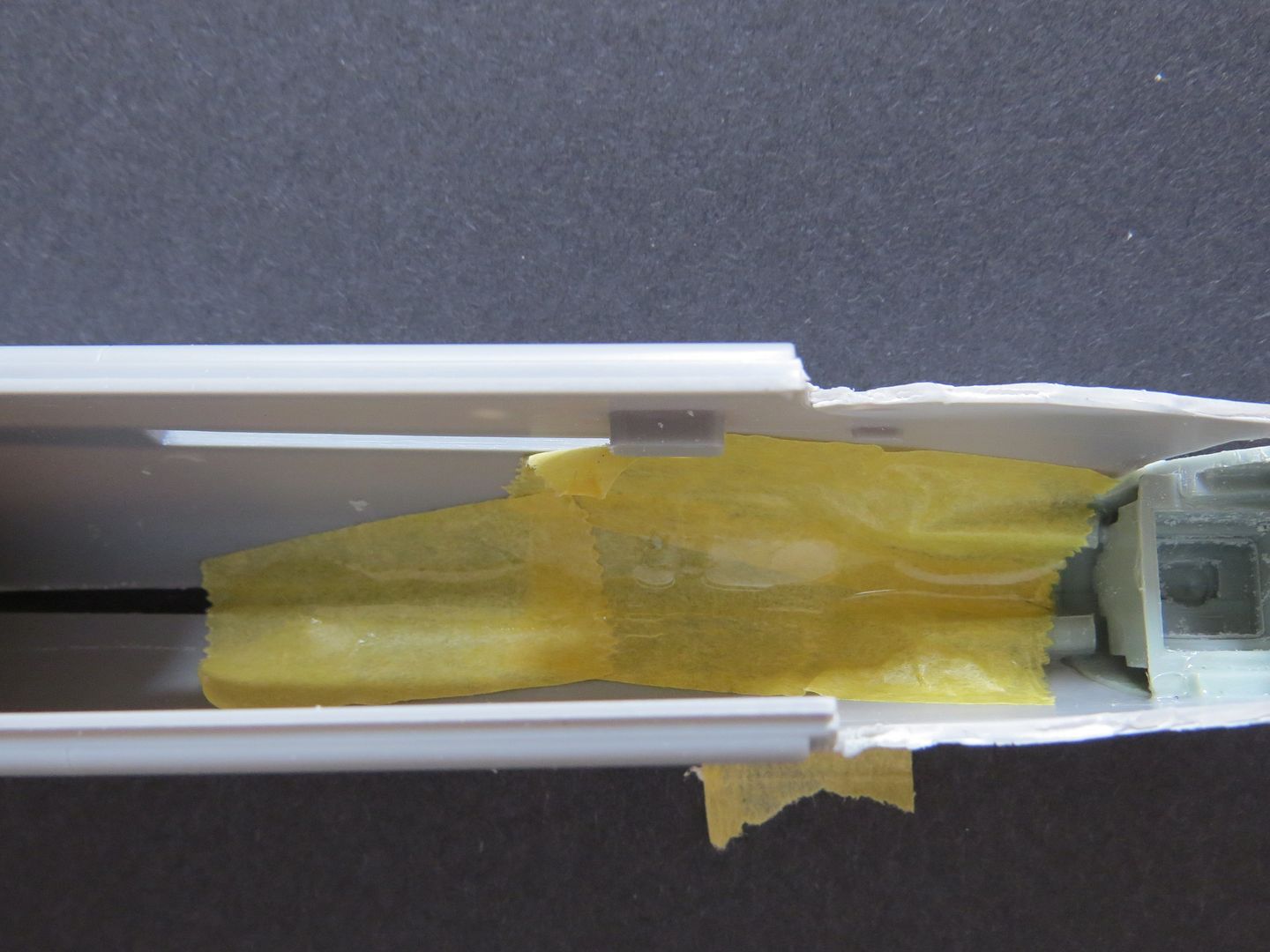

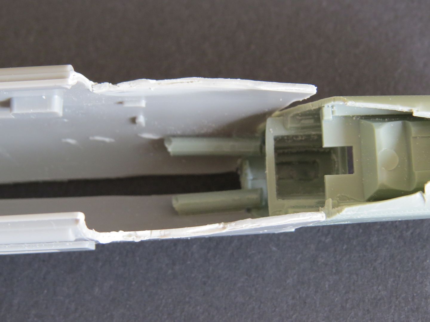

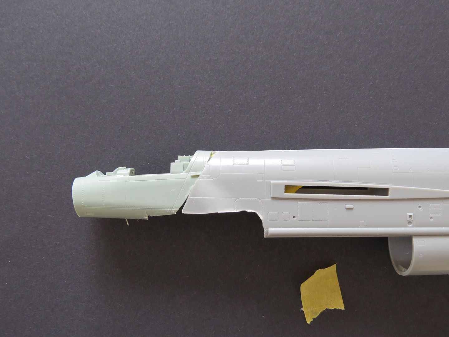

I`ve been working on blending the cockpit to the main fuselage section today.
Now after I removed the spine from the Lightning, this left me, as you can imagine, a rather large gap. This however was beneficial to the whole plan as it meant the front end of the fuselage had some `play` in it and could slightly bend into position. All that was needed was a couple of sprue bits to act as `tabs`.
The tabs have played their part in keeping the two sections straight and level......
Of course there still was the issue of the gap that needed to be filled. Now the way that I do it without using ten tubes of putty/filler and forgive me if I`m teaching you to suck eggs here, is to line the inside of the `gap` with masking tape. This is very easy to apply and conforms with all little gaps that are a pain to reach. Once this is done and then add a good spread of super glue and wait for it to dry rock hard. This means that when you apply the putty/filler to the gap from the exterior, has a `base` to rest on and less putty/filler is used.
Following picture shows what I mean and has the super glue spread on it.
Filler has been applied so now I just have to wait. And wait..., and wait.  :blink:

Rather than simply filling such a large gap with half a ton (metric or otherwise) into the hole, try using scraps of plastic such as off cuts of plastic card or chunks of sprue/runner. It's free and comes with the kit so ideal to fill gaps and saves on filler.
Yep, not to worry, all the cut off`s have been saved..  ;)

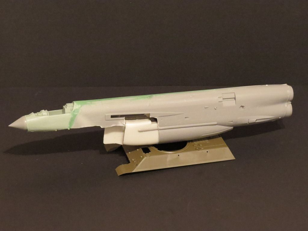

And so a nice warm welcome to the newest member of the build......,
Now certain `heel` jokes aside, I needed a tank chassis that looked like a 1950`s design while keeping to the 1/48 scale. Hopefuly this will look the part once it`s put together and other bits added.
The kit itself is starting to take....., er..., shape? Although I don`t doubt it looks like it has more holes in it than the Titanic does these days.
Dodgy aircraft build, meet tank bit. Tank bit, meet dodgy aircraft build.......
