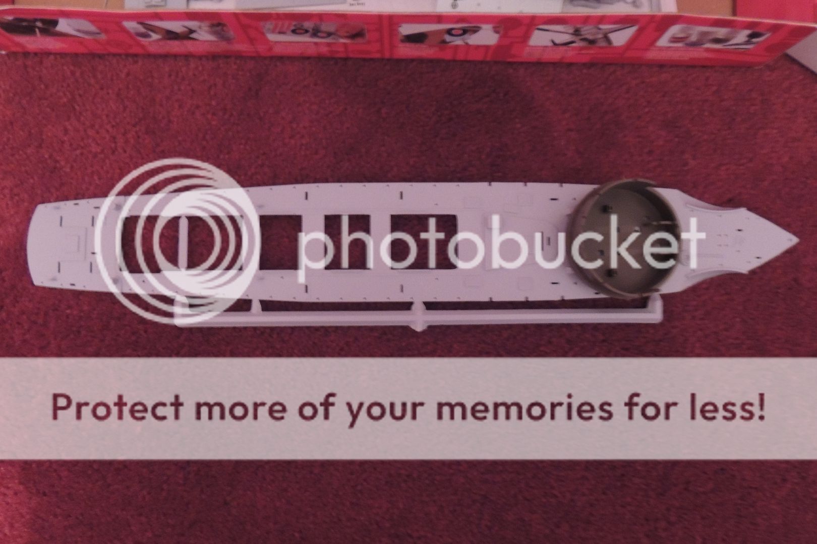

The base vessel is the Airfix 1/72nd S-Boat, scale-o-rama'd to 1/35th.
Weapons:
Main; 2 x 40mm Bofors in M42 "Duster" turret*
2ndary; 1 x 20mm Vulcan in M-163A1 turret
plus; various machine guns
It was goint to have the Vulcan & a quad .50cal mount but I didn't have a quad .50 in the stash & I was getting impatient to start (I'm 18 days late getting under way) so, well ... you know ...
Besides, this leaves me with a couple of turretless AFV's to play with later. :thumbsup:

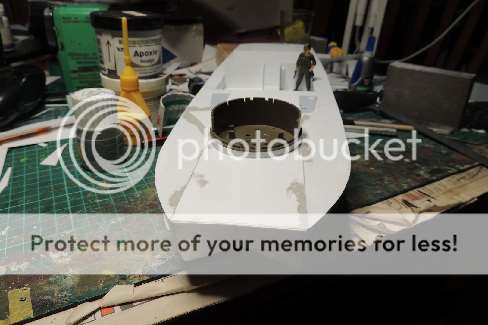

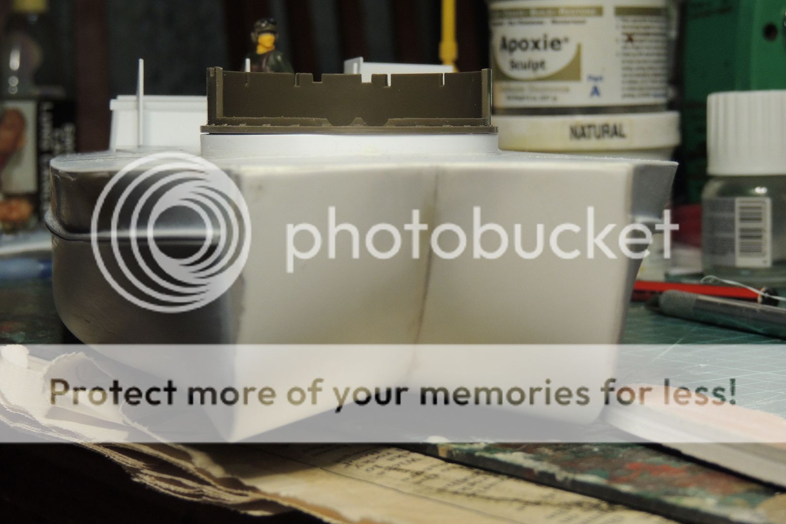

I have no option but to widen the hull of the S-Boat - the M-42 turret is as wide as the fore-deck (the widest part of the boat). As seen below;
Still have to set up my work space, which I should do in the next couple of days, but I have a few plans to draw up first for the mod's to the hull.
Pictures of the unstarted boxes.

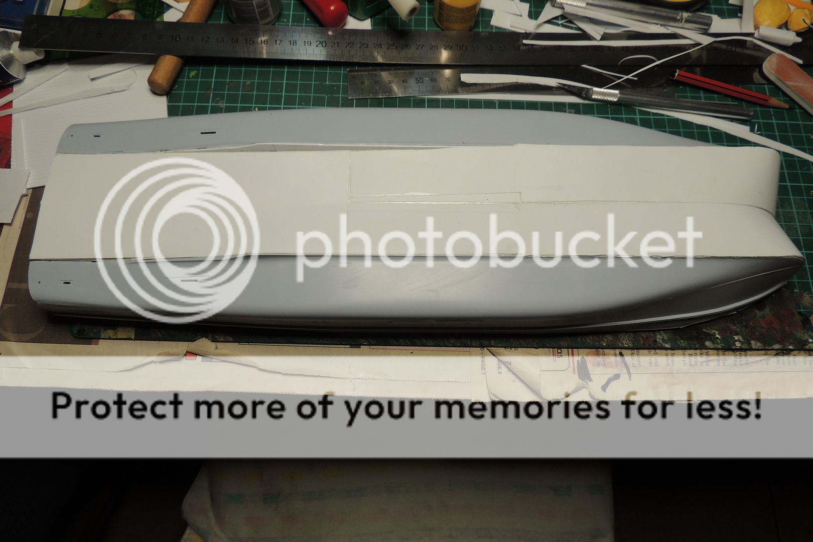

OK, moving along here!

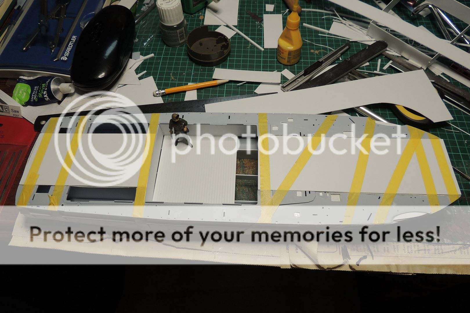

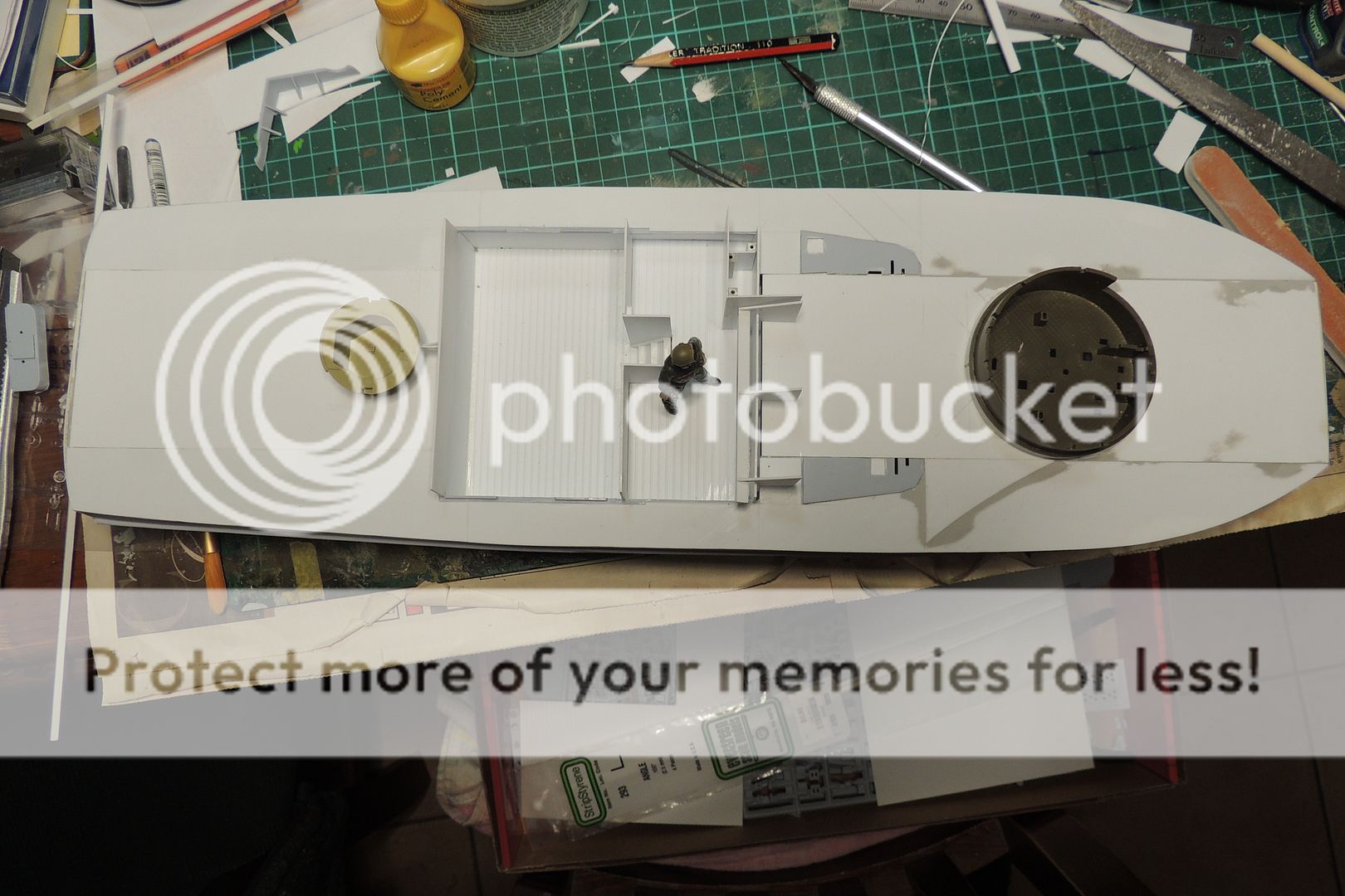

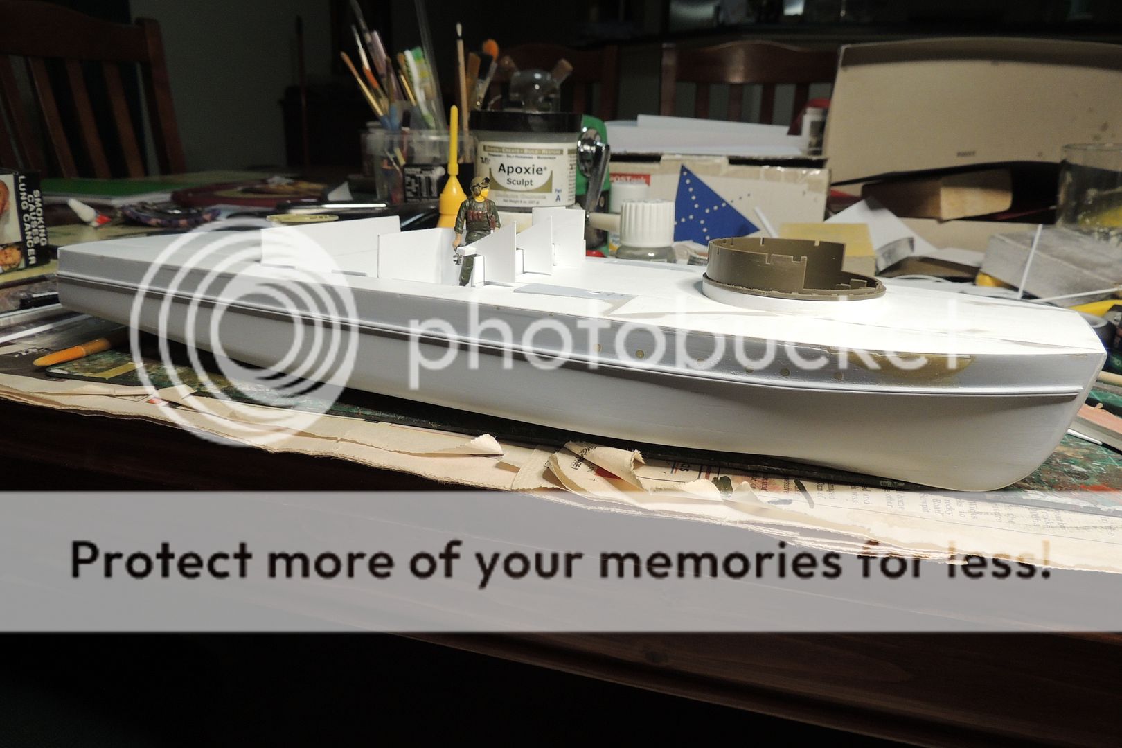

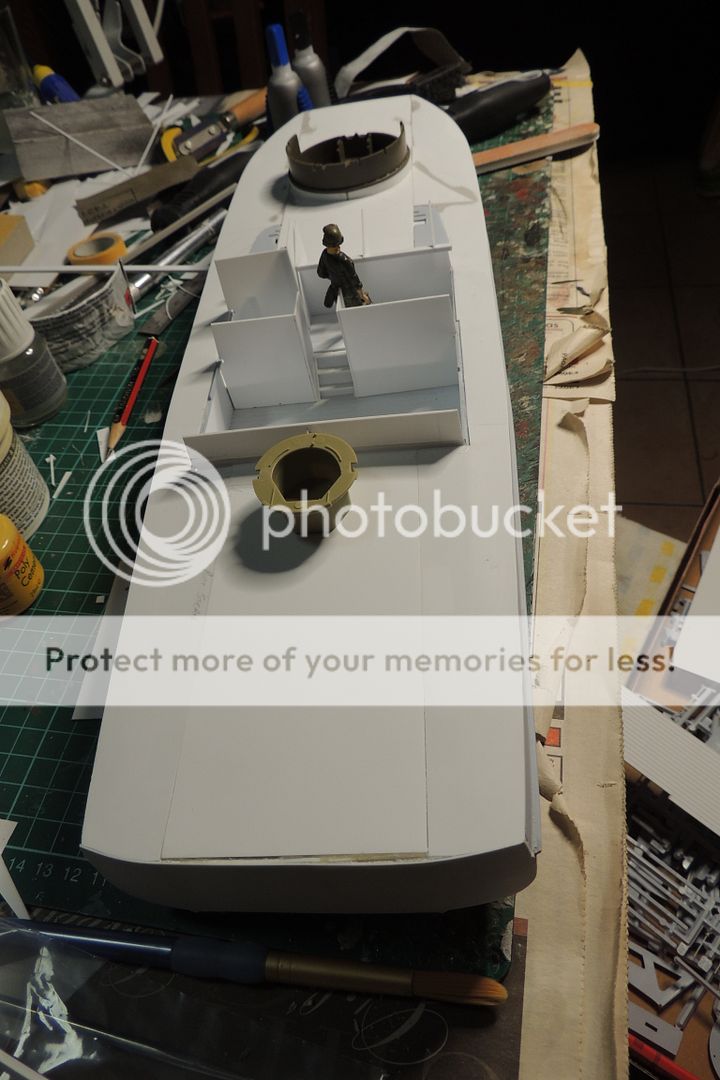

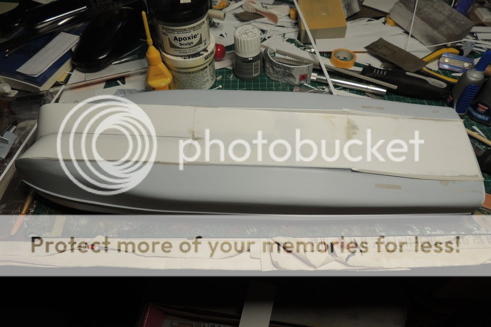

Some progress has happened & a bit more has happened since these photo's were taken - but not much.

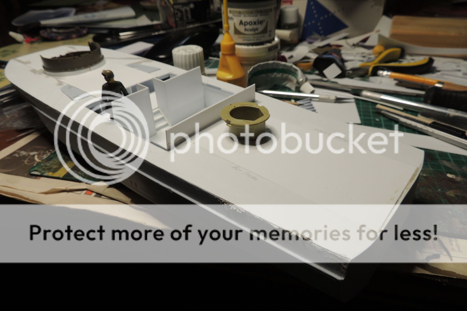

The build in progress with Thomas the Tanker present for scale, as usual;
As you can see the hull is a bit of a cross between the ocean-going hull of the S-boat & the sea-sled "inverted planing" hull.
Getting everything "right" is turning out to be a bit of a challenge (especially the sea-sled hull form) & I may, despite my best efforts, have to sheet over the rest of the deck as the PSR is becoming a bit troublesome.
Still, onwards & upwards!

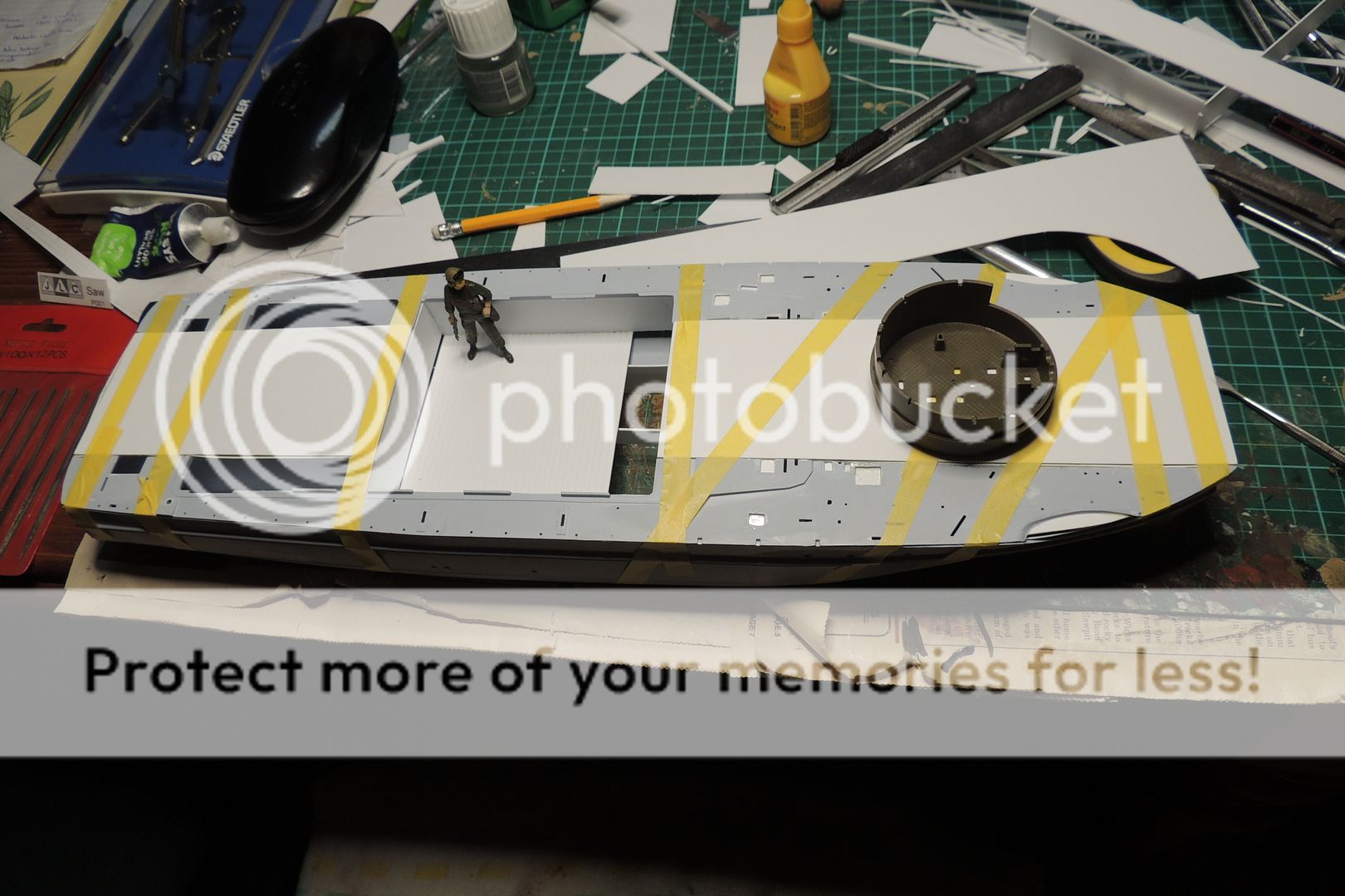

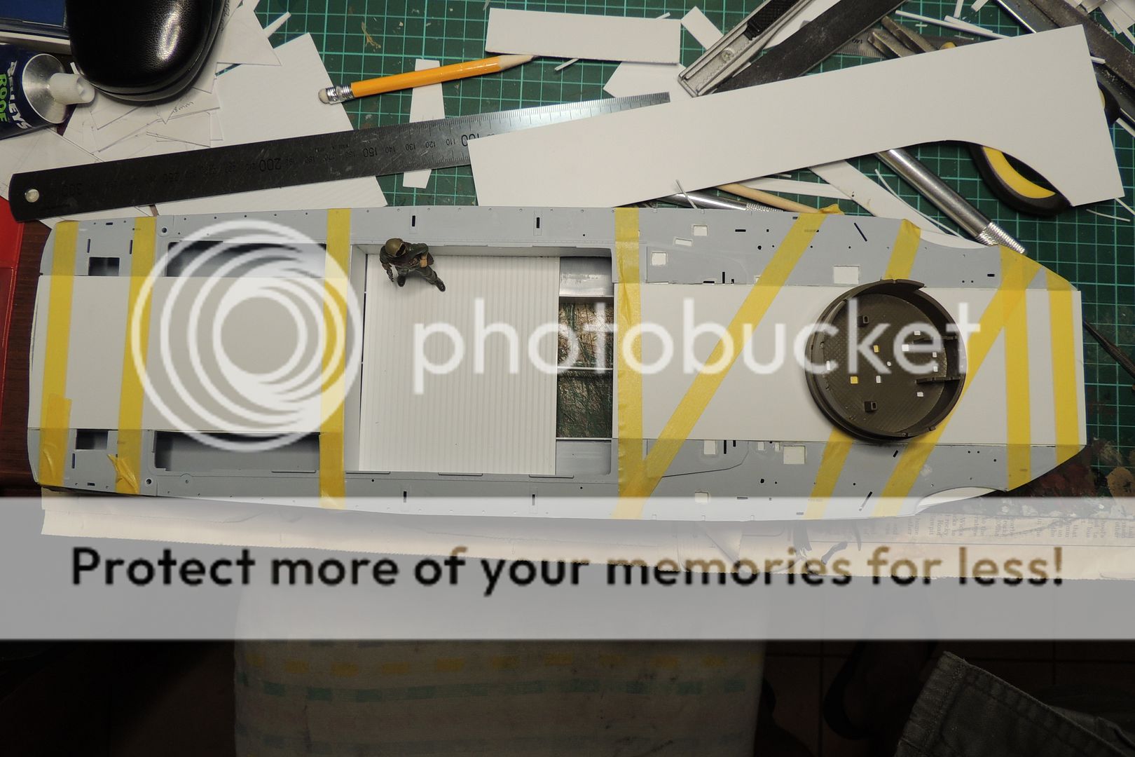

Looking good.  I don't envy you all that PSR though.

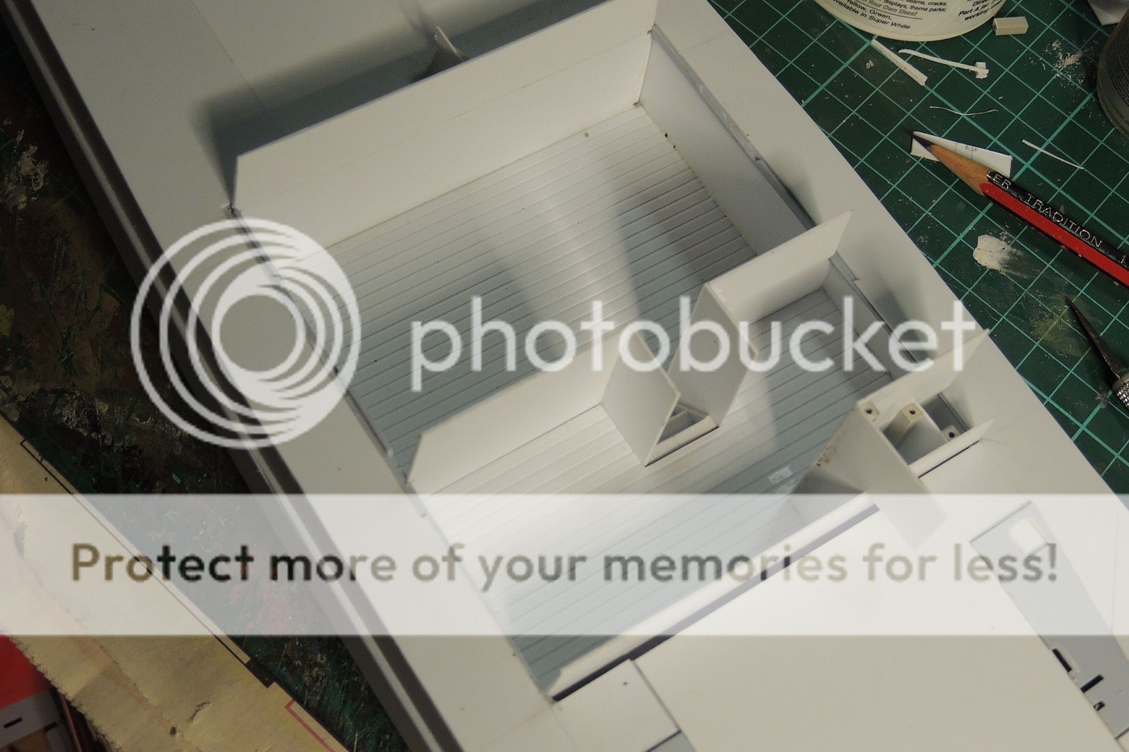

If you are PSR all those slots and small openings on the deck I would cover them. Much faster and would keep the outline of the opening from showing through the putty. Do you have access to a large sheet of something thin? The fewer the joints the better.
I love the hull shape, very unique!
I'm heading in that direction, kerick, but I'll just butt the new sheets against the centre sheets & sand to blend, as I already have the raised forward turret ring fitted, using .020" sheet.
The final central hull structure is 4 layers of .010" sheet, final layer bonded with Araldite because the other adhesives used deformed the styrene in ways which were too difficult to fill/sand.
Very nice. Love the shape of the hull. Nice to see the soldier for scale as well.

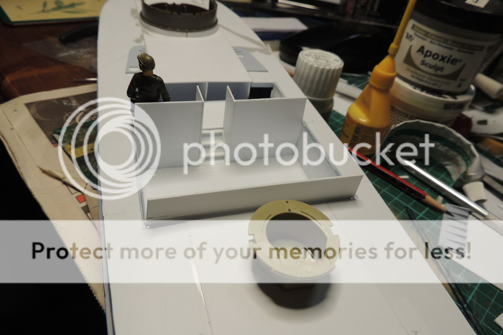

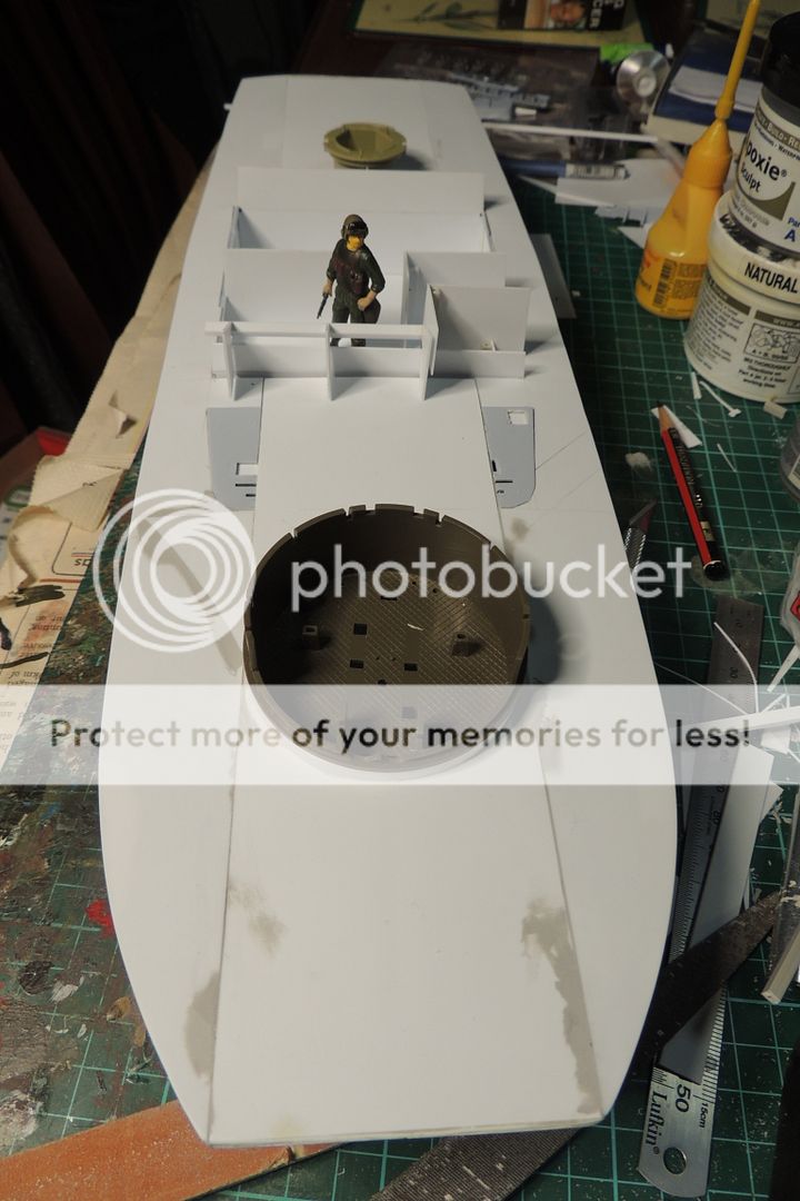

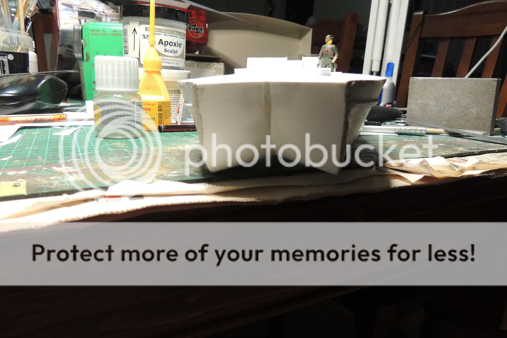

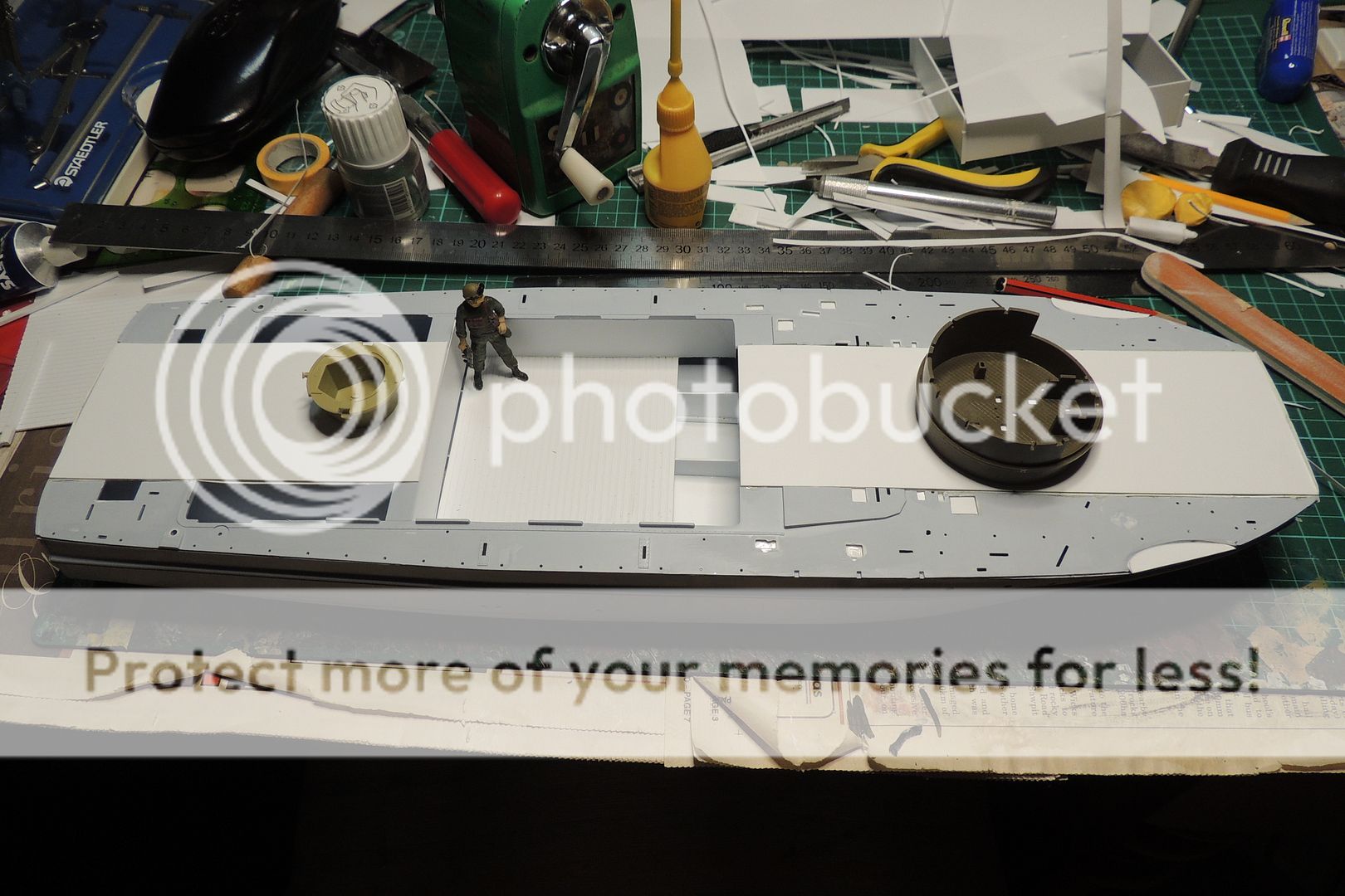

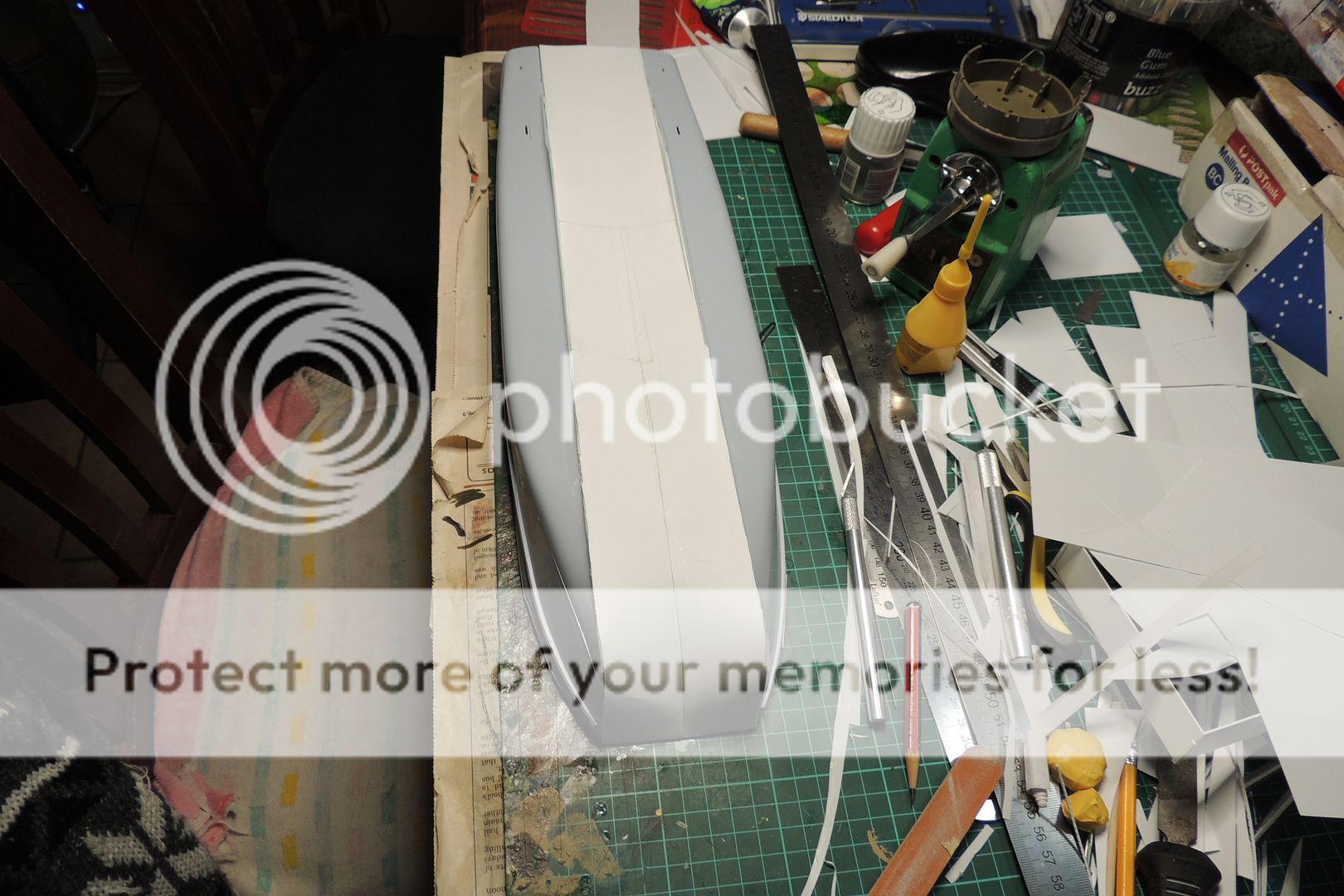

OK, here we are again with lots of photo's of the ongoing build.
Quote from: salt6 on March 04, 2015, 05:04:17 PM
Are you going to do pump jets?
Still not sure on that. If the build goes well & I feel up to scratch building the extenal parts, maybe, but she's pretty big for a jet boat, so I may just go with prop's.

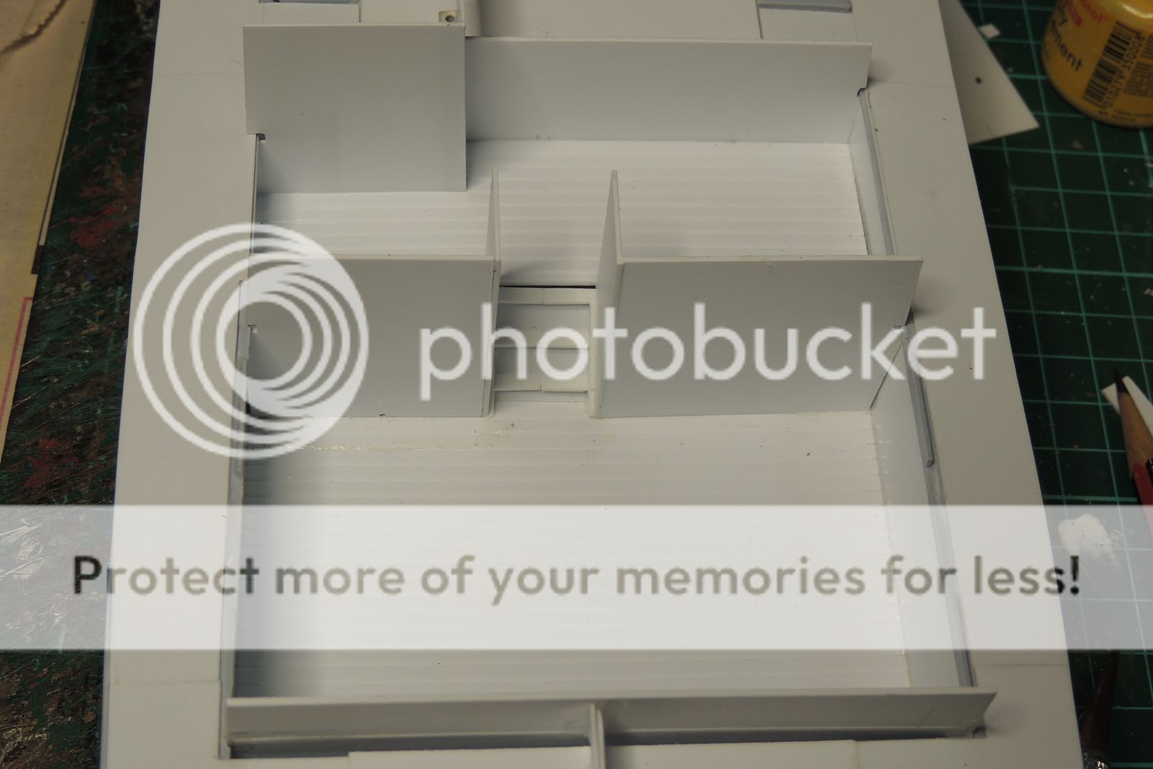

I seem to be an unwitting member of the "Measure twice - cut once ... Bugger! ... Measure thrice - cut once ... $h*t! ... Measure four times - cut once ... Oh, for f^#k sake!" school of construction. I used the card template system, too - even that didn't work!
Anyway, I've gone with the "Near enough is good enough" school for now & I'll use putty to carefully fix any glaring faults.

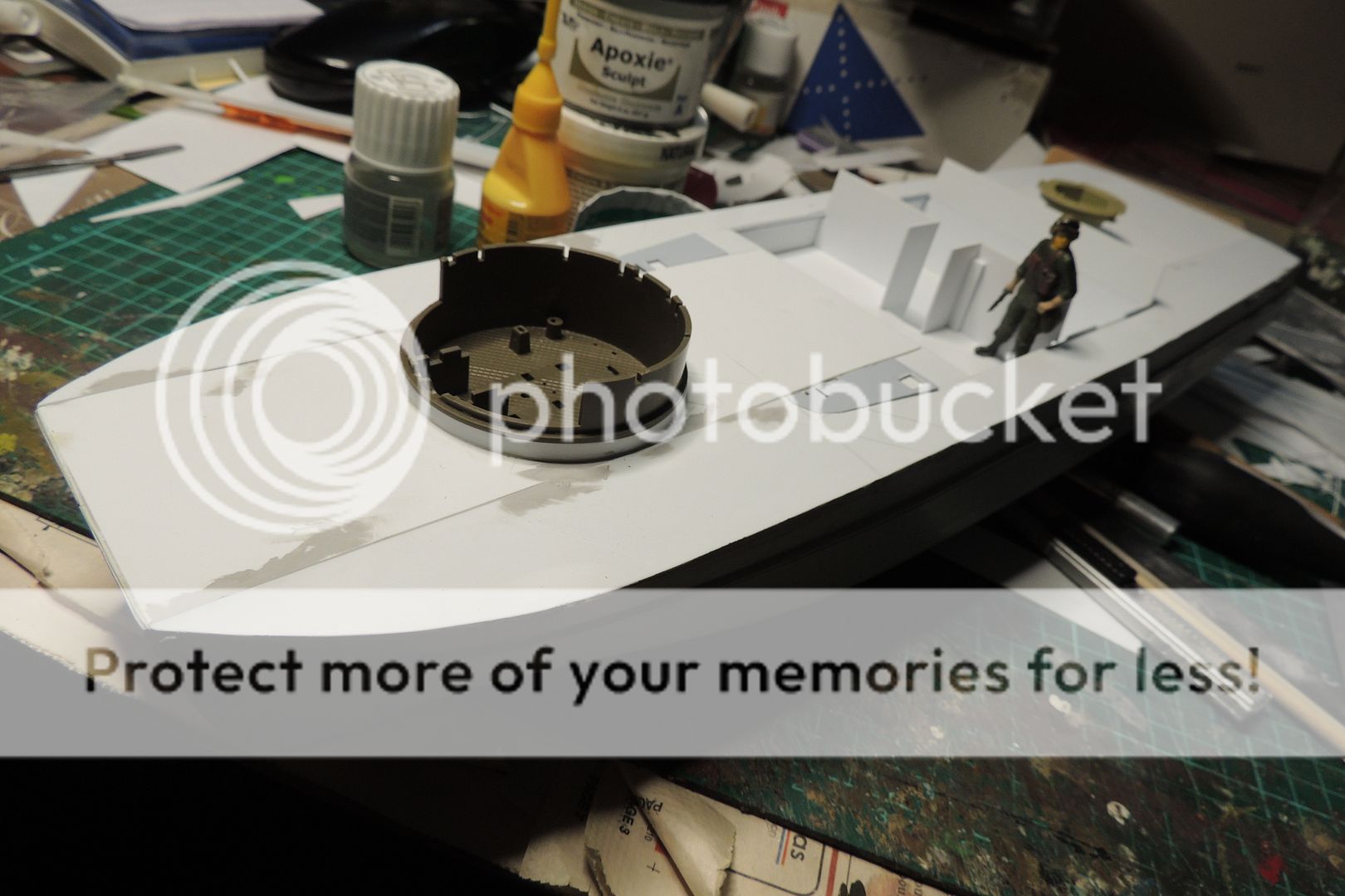

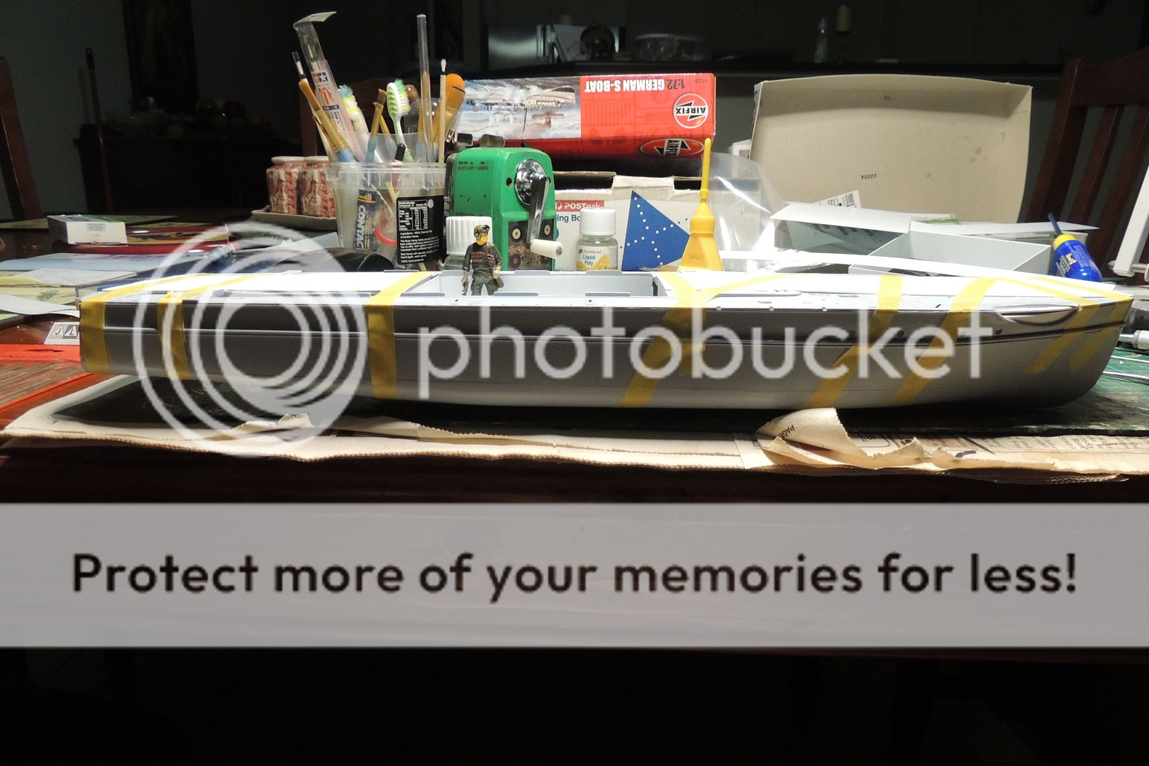

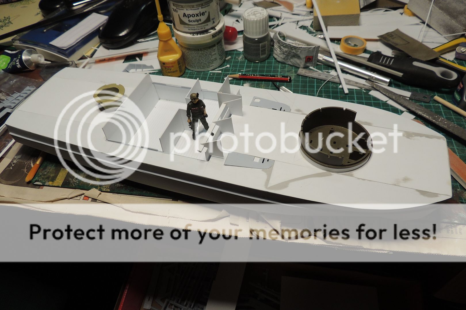

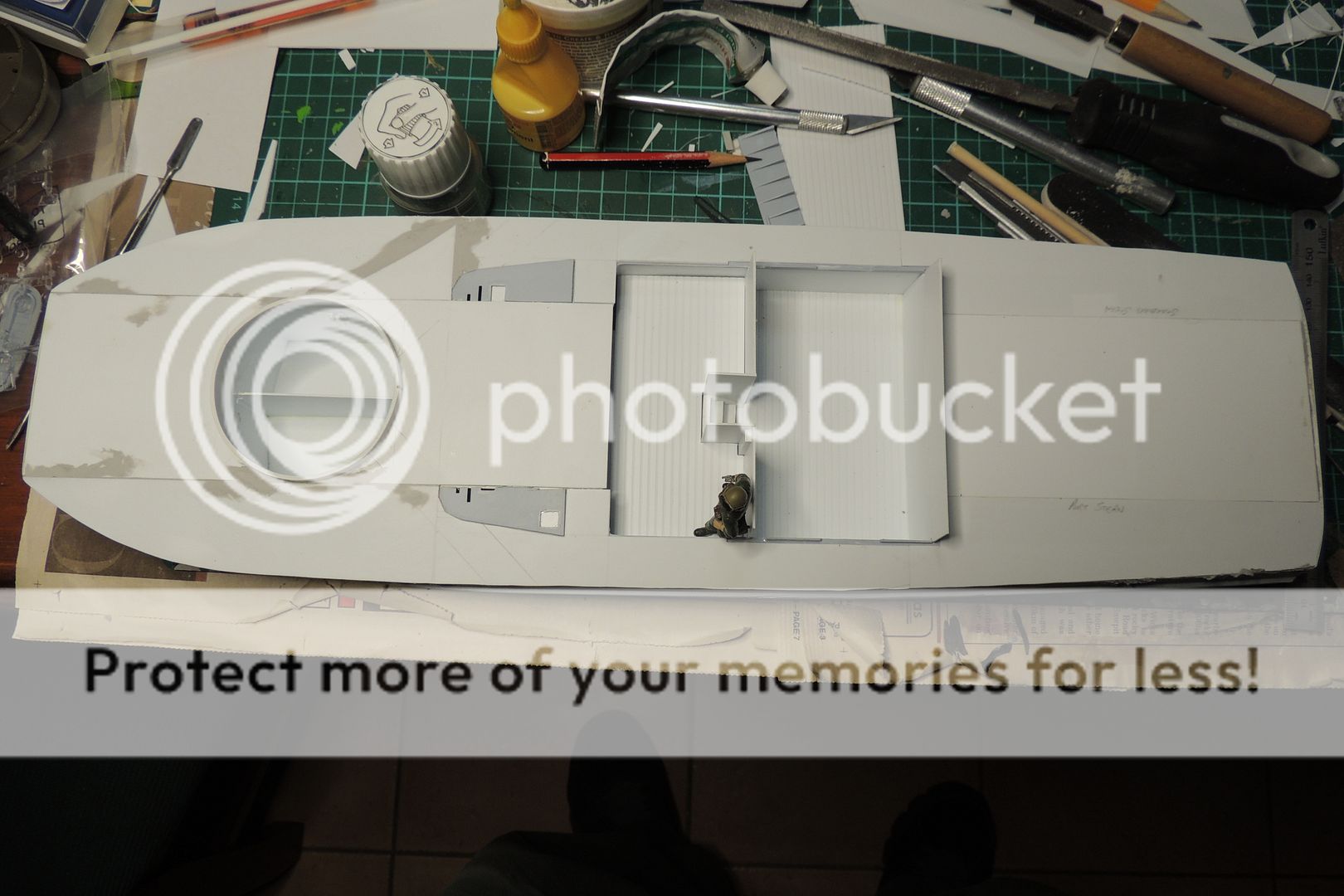

This is what she looked like 2 days ago;

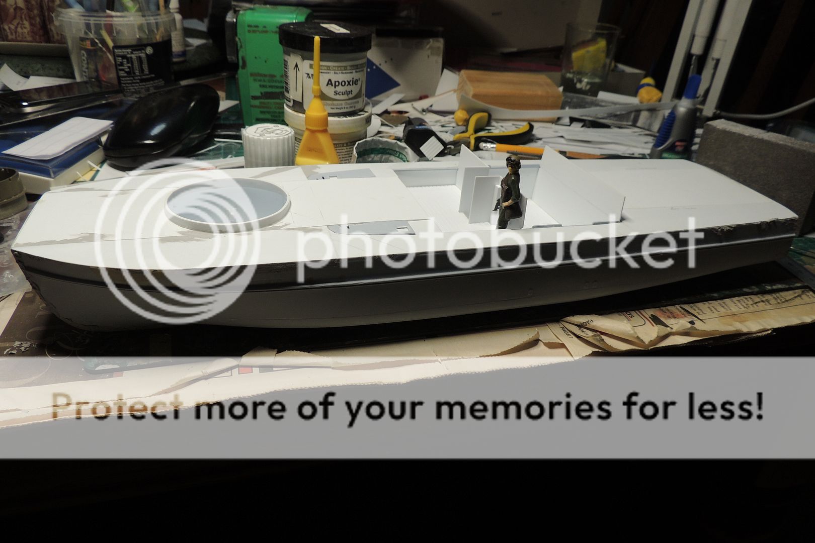

And here she is today;
Hope I haven't put you all, including the insomniacs, to sleep with all these pic's.
Guy

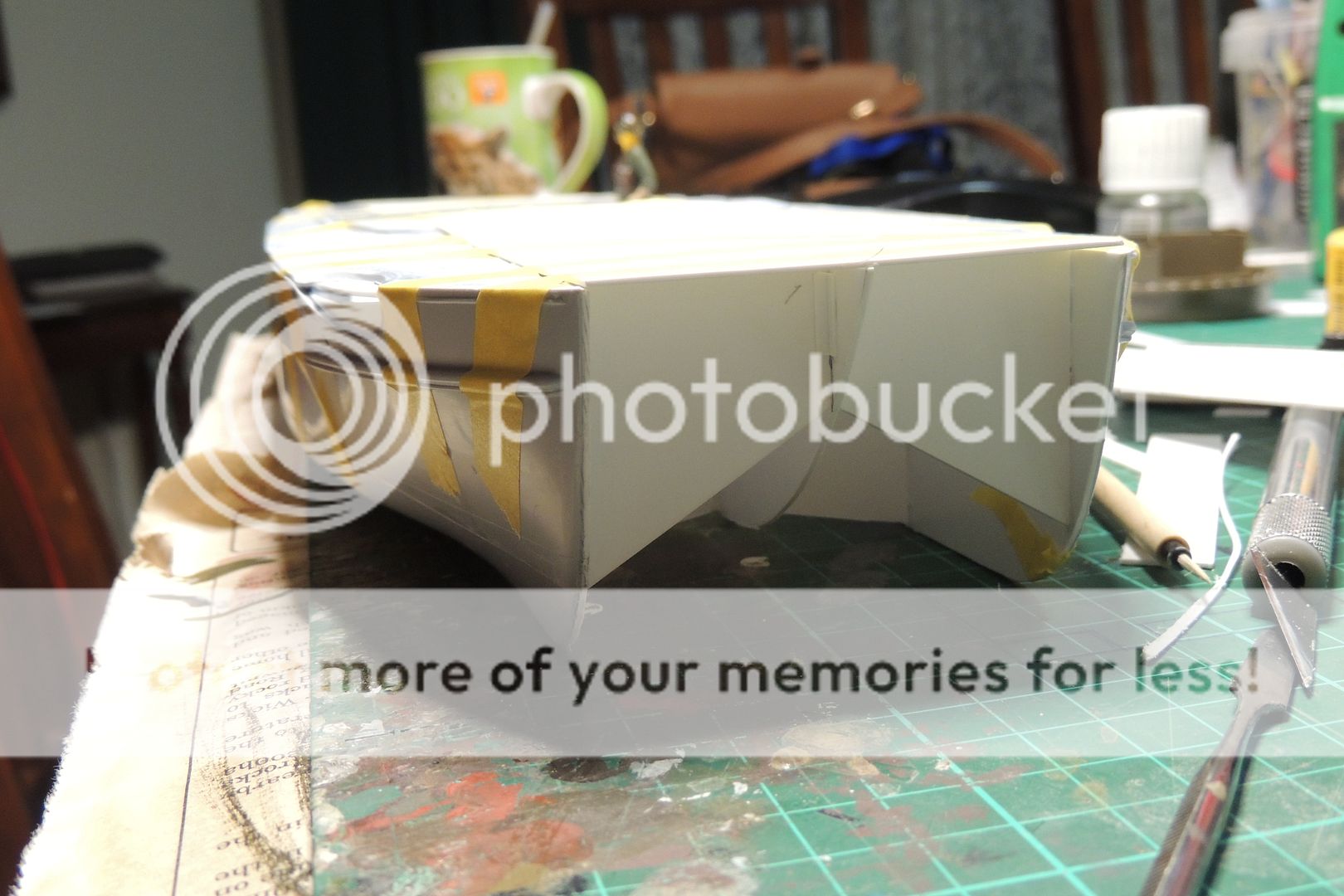

An interesting semi-cathedral type hull. What does it look like from the transom end?
