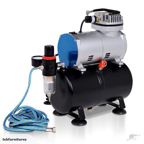

Simple thing is this ..if ya want good to great results get a good compressor like this one ..this cost me $160 NZ brand new .
Having a tank gives you a much better flow of air where as a non tanked one will not as air is supplied with every stroke of the piston so it comes in spurts and not smooth continuous air like a tanked compressor does .

Make sure your compressor has a moisture trap on it (the one in the pic does - it's the clear chamber below the black thing with the red ring).

Another thing also which is a really good idea is a pressure control valve ..nothing better than being able to control the flow of air and with the many different types of airbrushing i do ,,its brilliant .
