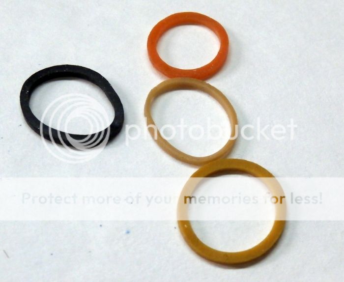

Through the years I've tried several ways doing circular masking on cylinders or cones. The latter need an "adaptive" mask to fit any chosen radius of the cone. An easy and effective way is using a rubber band with a small diameter:

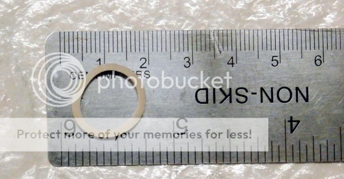

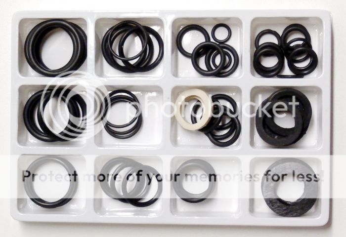

Good and cheap are also different O-rings sold in packages:

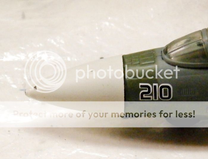

Here I'll use a prepainted toy-airplane in 1:72 and won't care much about the quality of the new layer of paint:

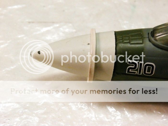

Just put the ring in the desired position, stretching it over the cone. If you want the line to be parallel to another existing panel line or painted band, use more rubber bands to define the exact distance:

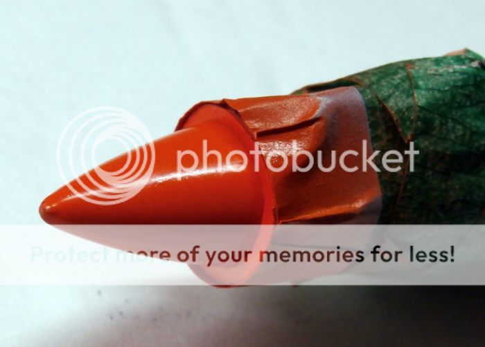

Next step is masking in your usual way:
Spray the desired color:

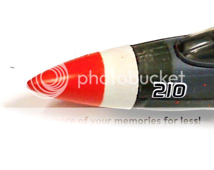

Unmask (when the paint is dry):
To avoid fuzzy lines, before spraying with the final color spray a layer of transparent varnish/lacquer to seal the micro-gaps between the rubber band and the plastic (I didn't do it this time :-\).

Initially I started using rubber glove or a small party balloon with a punched hole in it. I couldn't see the one end of the masking (under the rubber) and I came to the idea to use short pieces of a rubber hose (tubing). Cutting rubber straight is not very easy so I finally started using the precut rubber rings in any form or the O-rings. The O-rings are better, because of harder rubber, but they can break easily.
The success is not always the same. I also use a harder support behind the rubber ring (piece of plastic with a cut out hole) so it doesn't stretch too much. Sometimes I use the masking tape first and put the ring over the uneven edge of it to form the exact circle etc. It depends very much on the size of the cone and the form of it.
