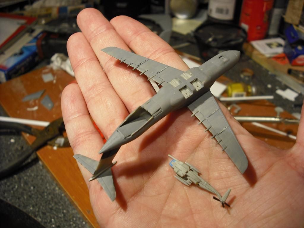

Quite a project!  We really need an affordable 1/144 or 1/200 C-5.
I can offer a bit, the 1/144 kits are super rare, and super crazy prices, I would gag if I chopped one of those up, but your money...
The 1/400 diecast models are good, and might be a better starting place if you just want to do external changes like paint, weapon pods, etc.  They are solid metal however and thus would be an immense challenge to reshape, lengthen etc.
The 1/700 Pit Road examples are a great kit, but getting pricy as well.  But even the C-5 is small in 1/700.  See below for some examples of my beat up spares bin C-5's.  Out of the box they are designed with closed doors and clamshell nose.  They can be opened up as is my C-5 in Euro One camo.  CH-53E's in there for scale as well.
My thoughts are that you would delete the rear troop compartment (like the the C-5C), and this would leave enough room for the rotor head on the CH-53.  There appears to be enough room behind the main spar pass through of the C-5 for the CH-53 to be behind the wing. If you have the 53 in the rear part of the cargo bay, you will definitely have to come up with a fix for the top part of the ramp, that folds up out of the way to allow loading.
This would still leave the cockpit and courier cabin atop the forward cargo bay intact if you have your live crew aboard. Plenty of room.
I do not see a way to realistically leave the tail rotor unfolded.  Just too tall, and would interfere with any type of ramp/door.
Width is also an issue.  The CH-53 sponsons barely fit inside the hold (as per the pictures others show), and external fuel tanks or weapons outboard the sponsons have to removed or fold up someway.
If you go with a 1/700 model, many of the things you mention like radars, sensors, engine upgrades, decoys etc would not even be noticed in that scale, just too small.  New pylons could easily be fitted on the wings, but would detract from you stated goal of increasing top speed of the mother ship.  As the forward part of the cargo bay would be empty, perhaps just go with a bottom or side weapon bays here.  Plenty of room.
PitRoad C-5's and CH53E's, all in 1/700
The belly and ramp area of a C-5.  I have cut this open.  Kit out of the box, the ramp is sealed shut.
The C-5 cargo area is just large enough for the 53, but really no room to spare.
A CH-53E atop a C-5.  I am NOT suggesting such a piggy back placement, just to to show the rotor head of the 53 would appear to be behind the main spar of the C-5, so room if you deleted the rear upper troop compartment.  Note how tall the tail rotor is.  Even if the rear troop compartment were opened up, I think the the tail rotor is too tall.  Suggest keeping the tail fold feature.
Another shot on my hand for scale.
