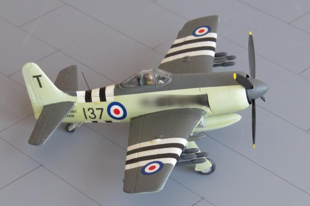

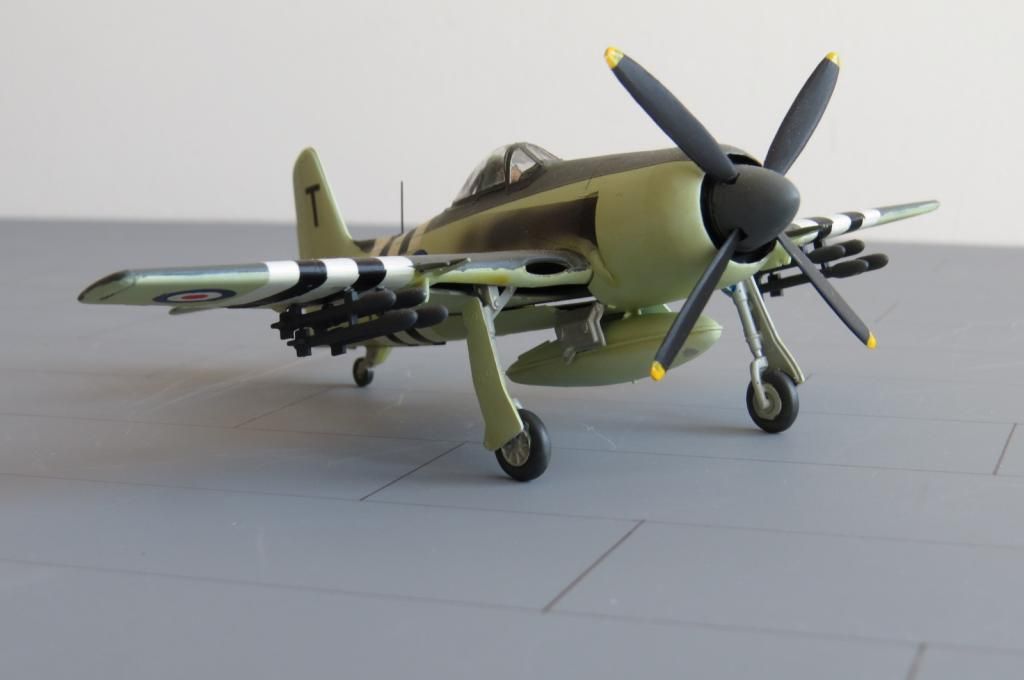

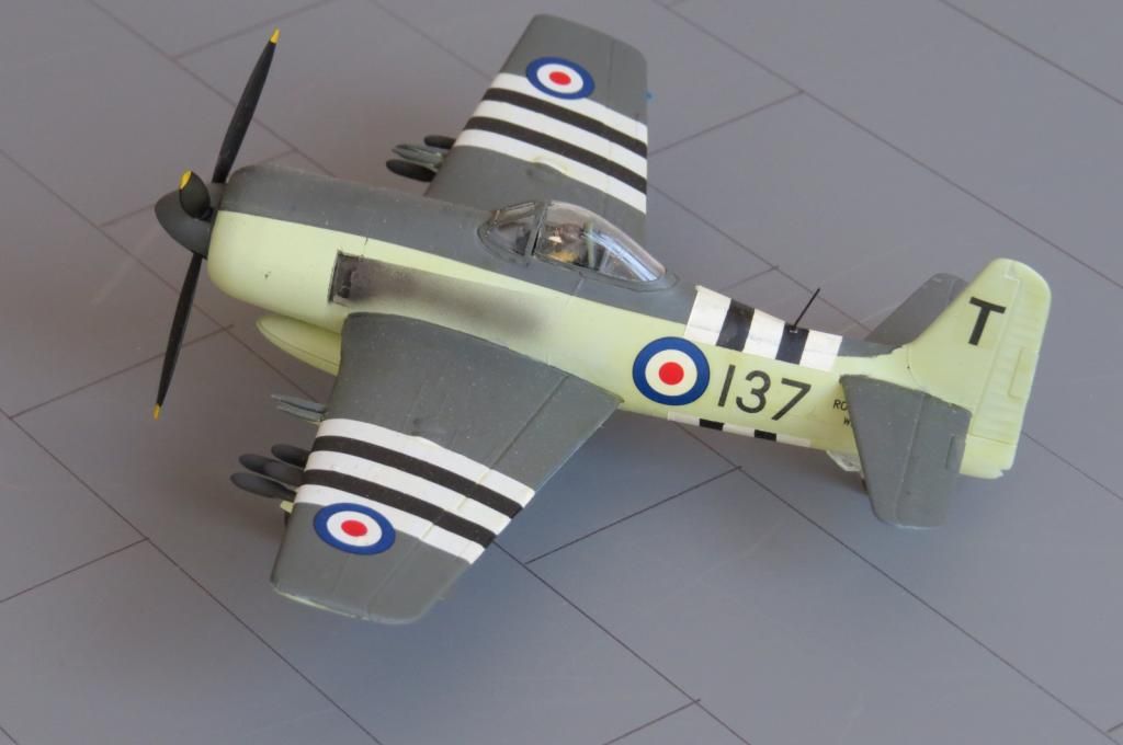

a brainwave occured yesterday to see if adding the spare radial engine from the matchbox hawker tempest kit i've recently finished in a RW scheme, would look good on the front of a revell grumman bearcat. especially as you get the whole engine cowling spare and the prop' spinner too in the matchbox kit. the spinner is easily adaptable to the prop' from the bearcat kit. i've also decided to increase the rudder and fin area on the bearcat too as the radial engine is quite a bit larger on the tempest than the bearcat. a plastic card firewall is on the front of sawn off bearcat fuselage for a bit of extra strength.
as the bearcat is the variant of the F8F armed with 4x 20mm cannon that lends itself neatly to a ground attack a/c in british colors with suitable fighter recon' mods
i don't have much suitable FAA decals so it will be in RAF markings.
many thanks to kitbasher for selling me the kit and some helpful plans with it at the RAF hendon model show last month.

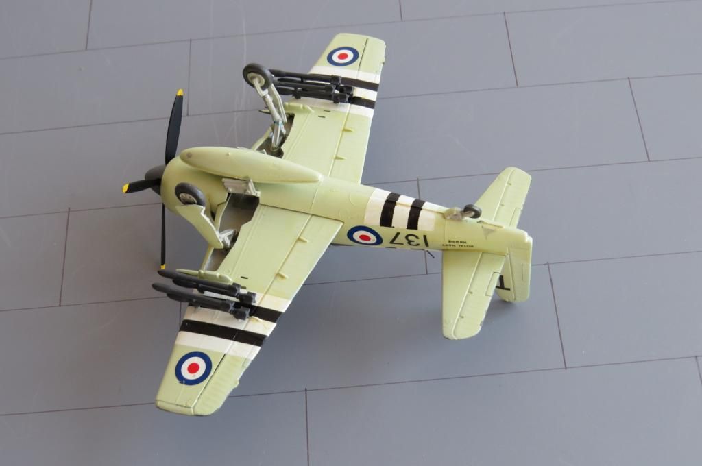

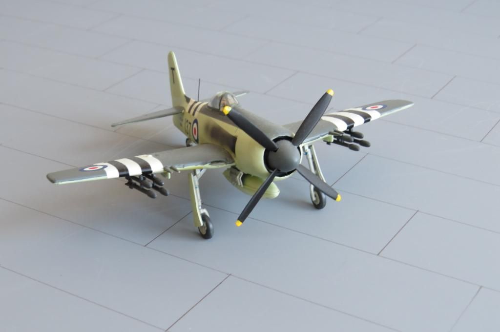

i've gone for a finish of PRU blue undersides for the bearcat but am stuck for a topsurface grey.
should it be ocean grey or medium sea grey?
i recall that some of the mosquitos that were out in the far east at the end of the war and soon after had PRU
blue undersides, but have forgotten their upper surface colors. it was bound to be one of these colors.  :banghead:
Keeper of George the Cat.
Howard looking at my Combat Colours on the Mossie there's a FEAF Mossie with PRU blue undersides and Aluminium uppers, Aussie Mossies with Azure blue under surfaces and dark green/medium sea grey uppers. No PRU blue/grey aircraft.
I'd go Medium Sea Grey as that was the post war upper colour on high flying fighters
Chris
Howard of Effingham
i've gone for ocean grey, but will at a later stage give it a wash with a lighter grey.
Howard of Effingham

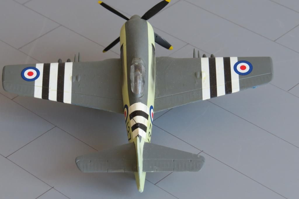

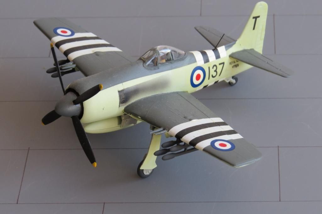

the bearcat is now 80% complete.
i have used a serial and identification letters from an AZ models spiteful kit and roundels from freightdog decals.
weathering will be quite light. the underwing rockets are pinched from the new airfix mustang F-51D kit.
it should be ready for its first display at the IPMS birmingham show this coming sunday.
