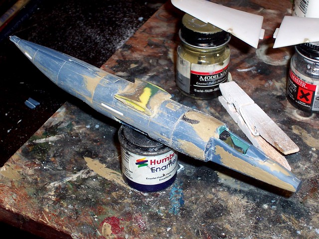

The kit and its assembly:
This fantasy thing was spawned by the vague thought that one could turn the rather crude Yak-38 kit from Tsukuda Hobby into "something pretty". The plan had been lingering for some time, and when I got hands on an incomplete Yak-38 (Revell re-boxing of the kit, canopy missing) I eventually started with the surgery, letting inspiration and donation parts flow.
I had a vague idea of what the aircraft should look like, but the overall layout evolved step by step. One initial measure was to shorten the fuselage considerably: plugs from in front of and behind the original wings were cut out, and the remaining three fuselage pieces glued together. As the fuselage has an almost even diameter and shape all along its length, this turned out to be pretty easy, but still needed considerably putty work.
The original fittings for the wings and tail surfaces were then filled with styrene plugs and sanded even.
Moving the wings from their original mid-position to the shoulders was already something I had in mind before the project started. But the eventual solution just evolved as I had the fuselage ready and could judge positions and proportions.
The wings I used come from a Alpha Jet (Heller), and they were not simply stuck to the fuselage. Due to the curved back of the Yak-38 I had to add a kind of console, made from the upper wing's mid section of a Matchbox SBC Helldiver biplane (!). This connector piece was placed into a carved fairing on top of the fuselage, the new wings attached to it, and the missing bodywork sculpted with 2C putty. This way I was able to blend the new arrangement into the rest of the body with matching wing roots, without having it look as if the wings had simple been stuck onto it. The result is pretty good, looks rather organic.

The tail is new, too. Original plan had been to use the Yak-38 tail, maybe with a T-tail arrangement - but that simply did not look good. Finding a replacement was tough, I finally settled on an A-4M (Italeri) fin, which had to be modified with a clipped top, Yak-38 style, in order NOT to remind too much of the Douglas creation! It fits in shape and size, though.
New stabilizers had to be used, too - the original Yak-38 looked much too small and flimsy. A T-tail was not possible anymore, so I used a cruciform tail, A-4 style, even though the stabilizers had to be moved upwards since the Yak-38 tail is much wider than an A-4. The stabilizers themselves are new, too: a pair of F-86 fins(!), leftover from Hobby Boss kits. They are a bit thick, but look great and blend well into the whole arrangement.
1:72 Yakovlev Yak-35D (NATO Code 'Fraudster B'); aircraft '17 Red' of 26th GvAPIB, Soviet Air Force; Desyatyy Oochastok AB (USSR, Manchurian region), 1976 (Whif/Kit bashing) - WiP by dizzyfugu, on Flickr
The main landing gear was taken OOB, but with new wheels and extra struts fitted. The front wheel is totally new, it belongs to a Fiat G-91. The cockpit received a new seat (from a MiG-29), a pilot figure and a primitive dashboard, and a donation canopy had to be found and integrated (I think it comes from a Tamiya 1:100 F-105).
All around the hull small details were added, including the seven pylons and the rocket pod ordnance.
