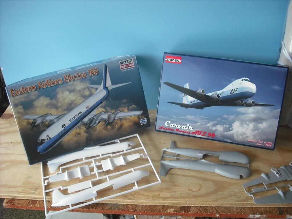

The Kits:
Roden 1/144 scale Kit #305, Aviation traders Carvair
Minicraft 1/144 scale kit #14661 Electra 188
The kits and main parts

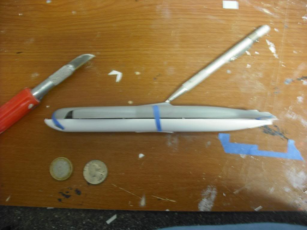

Overhead,  Electra in white at bottom.  Pleased that the fuselages are almost identical in cross section
Side view

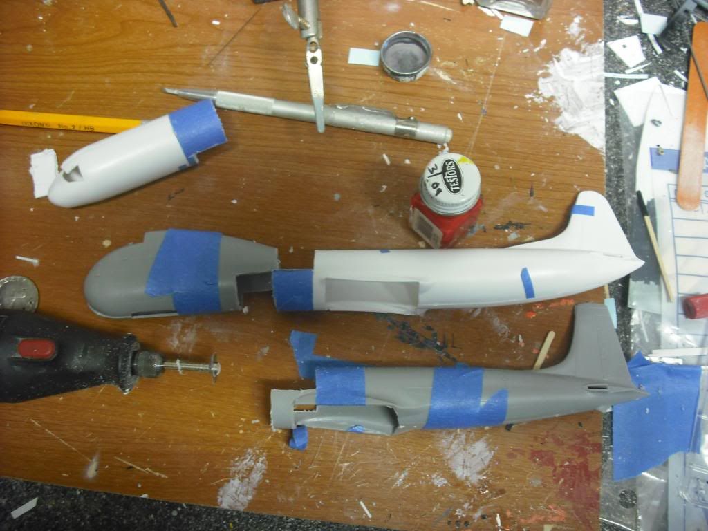

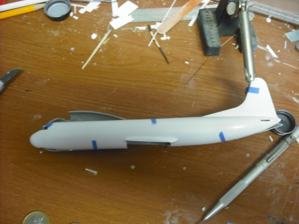

Surgery has begun.
Carvair front end being grafted onto the Electra.  Now where's my putty???
Beauty is in the eye of the beholder, or something like that....

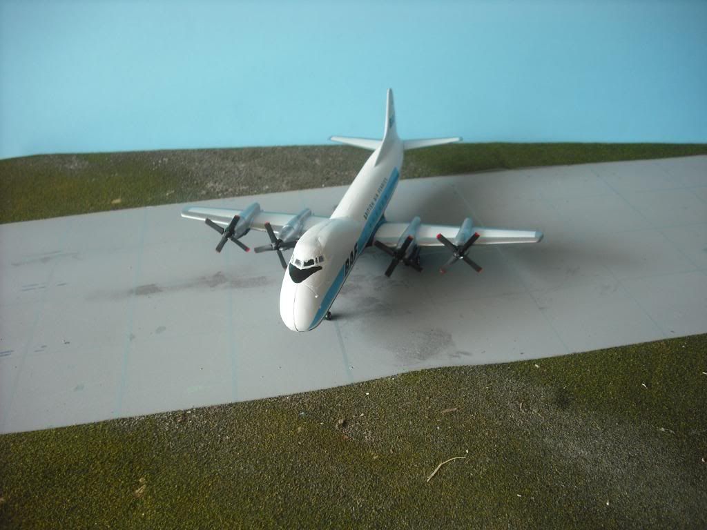

Complete.  Carvair Electra of British Air Ferries, 1964
1/144 combination of the Roden Carvair and the Minicraft Electra.  The Roden kit is OK, but a must for any Carvair fans- I know you are out there!  I saw my first Carvair in Hawaii @1991 and after doing a double take- I had no idea such a beast existed- and ever since I have had a strange affection for the Carvair.
Is there an ugly prize? Although I think she looks rather purposeful with the turbo-props
Quite small, the whole aircraft measures @9 inches long, span @8 inches. Fought me the whole way, the Electra kit, cockpit and the Carvair decals especially.  Roden kit is only OK, good panel lines, fair fit, very poor cockpit glass/fuselage fit, very soft plastic.  Minicraft Electra is fair.  Very hard plastic, no panel lines, so/so fit, although the wing/fuselage joint is very good.  I hate white paint, looked much better in primer.  Was tempted to go for a major strip down when about 90% complete, but I lost the motivation and just wanted to get to the finish line.  Perhaps a resurrection in a different scheme after she sits for a bit, or with more modifications....

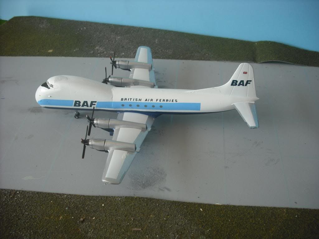

I had to clear the camera card for a few more pictures:
