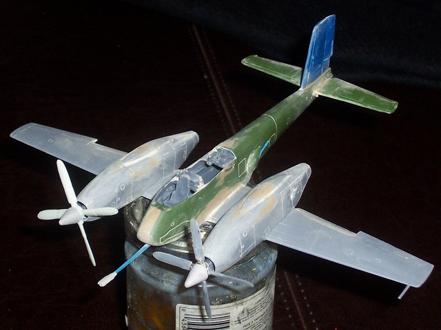

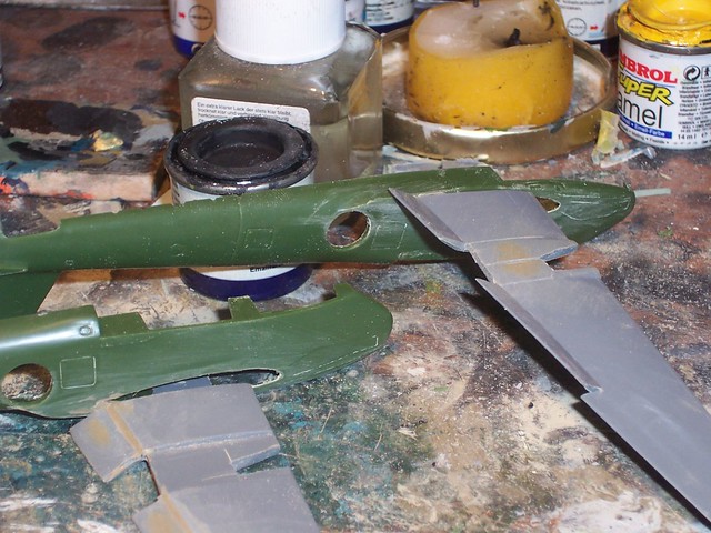

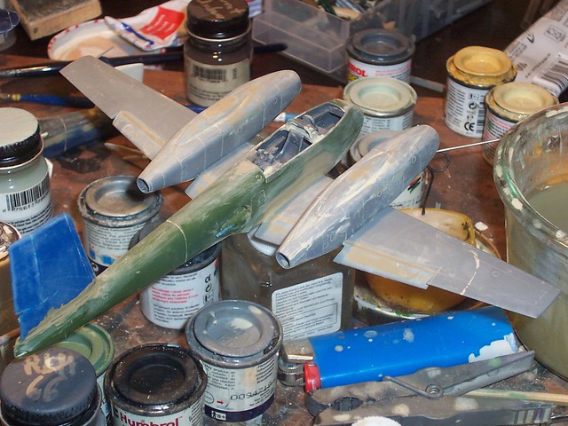

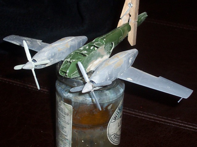

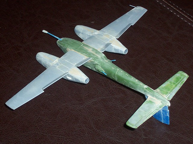

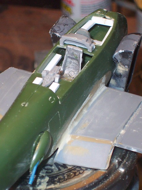

Basically this model is a kitbashing of a Tamiya Il-28 in 1:100 (wings & engine nacelles) with the fuselage of a Matchbox Me 410, which also received new tail surfaces. The IL-28's wings were turned upside down, so that the nacelles would now ride on the wings' top. This not only looks cool and 'different', it's also plausible because the landing gear could retract into the wings under the nacelles with the main landing gear doors closed, just like the original Me 410. This arrangement would also reduce the angle of the aircraft on the ground to a sensible degree - with the engines under the wings plus the landing gear would have been much to steep!
Fitting the wings to the fuselage was basically easy, even though the original Me 410 wing profile was much thicker than the slender Il-28 wings. Cleaning and blending the wing root areas was a bit tricky, though, but the parts went together well.
As a design twist and for a uniform look I also replaced the whole tail section, matching the angular look of the thin new main wings: The horizontal stabilizers are wing tips from a Matchbox Me 262, the vertical fin is a modified outer wing part from a Matchbox Grumman Panther.
1:72 Messerschmitt Me 510 A-1/U5; summer 1946 (Luft '46/whif/kitbashing) - WiP by dizzyfugu, on Flickr

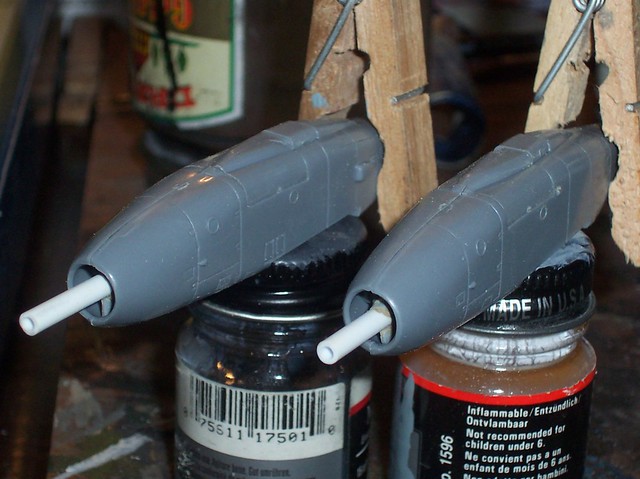

The engine nacelles were taken OOB. I just filled the Il-28's landing gear wells and their covers with putty, since they'd end on top of the new engines. The propellers come from Matchbox P-51 Mustangs, outfitted with pointed spinners and held by a long metal pin in a polystyrene tube which runs through the original intake splitter. Looks pretty martial, even though the nacelles ended up a bit close to the fuselage. The overall look reminds of the Short Sturgeon, but is not inplausible. A compact aircraft!
The cockpit received some side panels, new seats and some equipment, since the original Matchbox kit features almost nothing beyond a floor plate, two broad benches as seats and pilot figures. I also opened the cockpit hatches, since the aircraft would be built for ground display, with the landing gear extended. Unfortunately you can see now how thick the Matchbox canopy is, but, well, it's just a model...
From the original kit the BK 5 cannon installation was taken over, but I added a scratch-built, bigger muzzle brake. Since the aircraft was to become a high speed interceptor/Zerstörer for daylight operations, I did not add any further external ordnance, even though I added empty hardpoints under the wing roots.

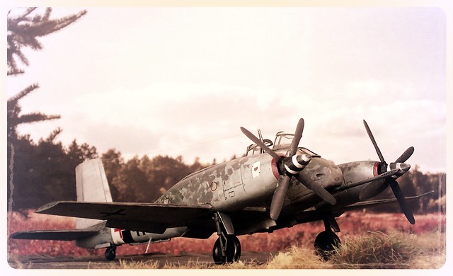

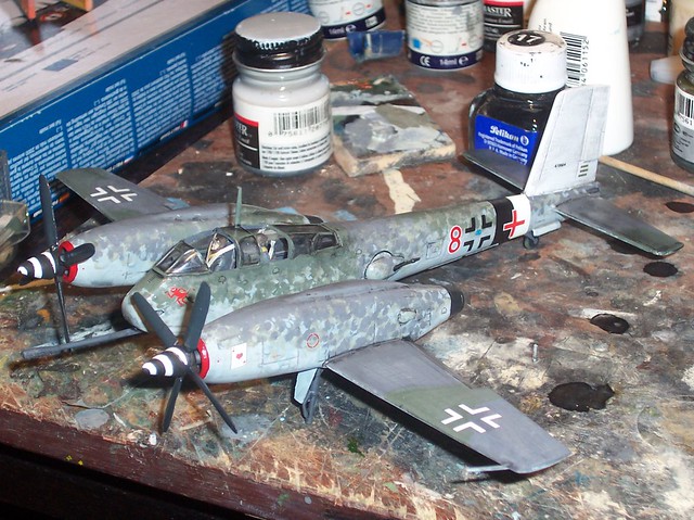

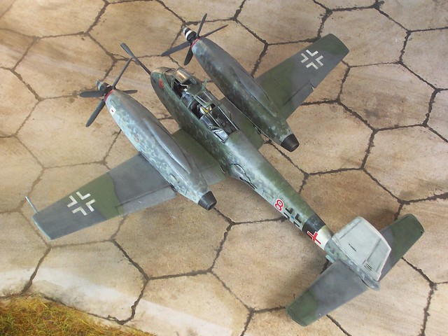

Painting and markings:

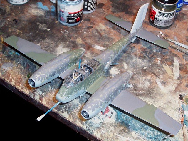

I pondered about a potential livery for a long time. Almost any Me 410 was delivered in simple RLM 74/75/76 livery, just some at the Western front were operated in RLM 70/71/65. But I found this option pretty... boring. So I made up a fantasy livery which I found suitable for high altitude operations, based on my knowledge of late Luftwaffe paint schemes. It turned out to be pretty complex.
The aircraft was to be light in color, primarily camouflaged for aerial combat. I ended up with a scheme that was planned as something that could have almost been called 'low-viz': all lower surfaces received a basic tone of RLM 76  (Testors), partly with a raised waterline on all flanks. This light blue-grey would blend into a slightly darker FS 36320 on the flanks, almost up to the upper surfaces. I wanted to show as much light blue as possible, but in the end the flanks received more and more green and grey spots than intended, so that I ended up with a rather conservative looking result. It ain't bad at all, but so it goes...  :rolleyes:
1:72 Messerschmitt Me 510 A-1/U5; 8./JG26; Flensburg, summer 1946 (Luft '46/whif/kitbashing) - WiP by dizzyfugu, on Flickr
The upper wing surfaces received a wavy scheme in RLM 71 (Dark Green) and 75 (Middle Grey), inspired by late Fw 190 fighters. RLM 71 and 75 are not typical late WWII colors, I rather used them because of their lighter shades.
On the fuselage, just the fuselage crest was painted with more or less dense blotches of these tones, blending into more patches of RLM 02 on the flanks and into the FS 36320/RLM 76. To add some more unconventional detail, the fuselage sides and undersides additionally received large, cloudy patches of RLM 77 - a very light grey. This detail was featured on some late-war He 177 bombers, but you can hardly tell these extra blotches because they have only little contrast to the RLM 76.  :-\
As squadron markings I went for late war JG26 colours - the black and white fuselage band. The red number and the "+" show that the machine belongs to the eighth Staffel.
As a special treat, the tail fin was painted all white: a formation sign for squadron leaders, another typical detail for German late WWII fighters.
1:72 Messerschmitt Me 510 A-2/U5 "Bremse"; 8./JG26, Flensburg; summer 1946 (Luft '46/whif/kitbashing) by dizzyfugu, on Flickr

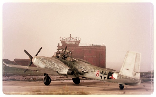

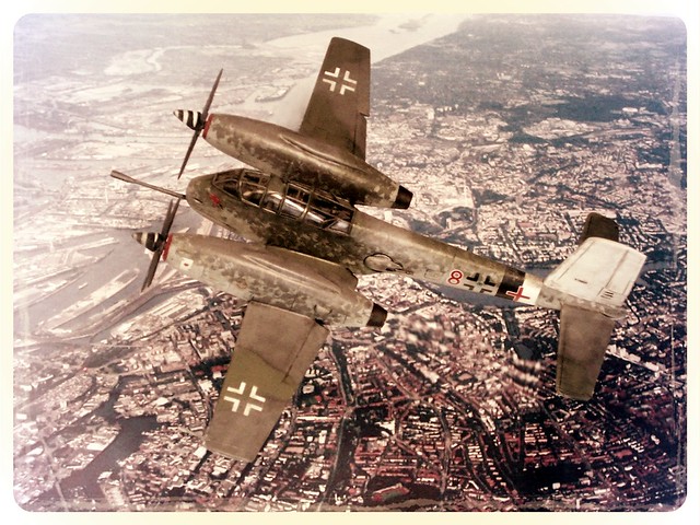

In the end, the whif is IMHO not very obvious - but that's what I like about it. The new engines are only recognizable at second glance, but they change the look of the Me 410 a lot. The new wings/stabilizers with their square-shaped tips create a very slender and elegant look, the aircraft just looks fast and agile like a true heavy fighter should. Mission accomplished!
