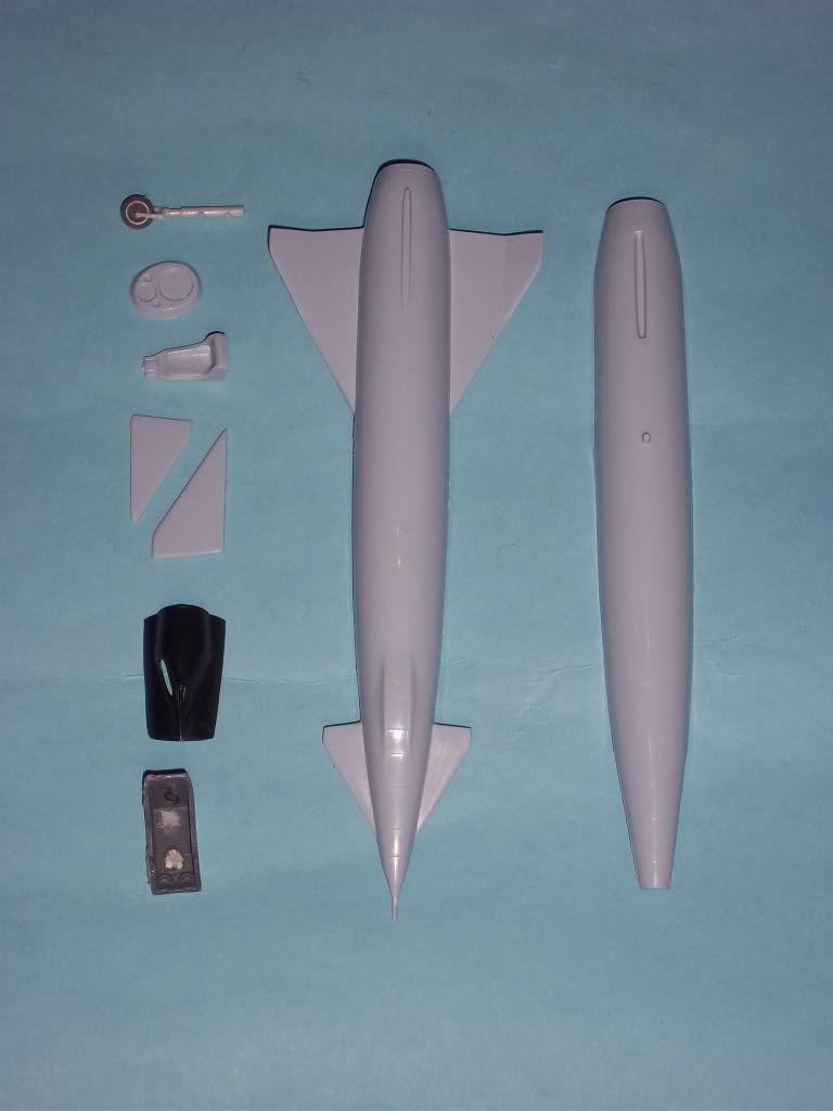

This wasn't really a scratchbuild, more a conversion but it'll hopefully give me the skills to attempt more ambitous projects.  The main thing with this approach is perserverence, and I remembered Overkillers words about carrying on, not losing heart and not to be afraid of tryin again if an approach didn't work.  Here's a smattering of in progress photos I took:
Some of the bits I used, the basic Blue Steel, cockpit tub from a Harrier, seat from God-knows-what, front undercarriage also GKW (I lost this but found a better replacement closer to the plans) and an X-15 Canopy.  I didn't use the lower fin as it was to be jettisoned for landing and was too large for it to sit on it's undercarriage with it in place. Other bits used were half a Harrier drop tank for the spine, Harrier wheel well (that Airfix GR.5/7 donated a good chunk of parts for this build) and struts from an SE5a for the skid undercarriage.

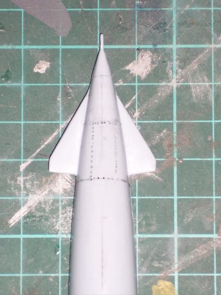

Holes drilled for undercarriage bay, this was also from a Harrier being the only one I had that was the right size.

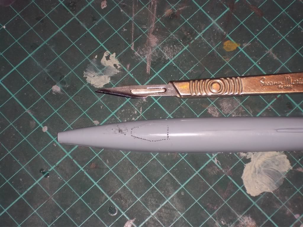

Holes drilled for the cockpit, it was then cut out with a scalpel blade.  I found that more holes with a smaller drill made it easier to cut the panel out, something that I'd learnt from trying to cut out the canopy windows.

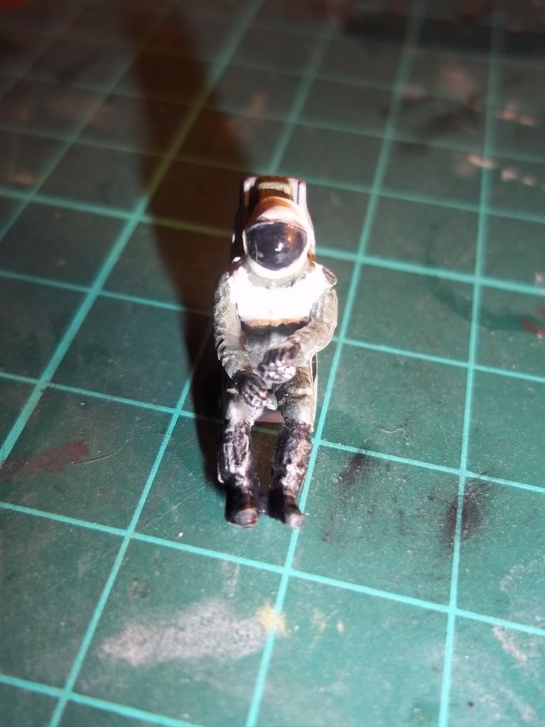

Blokey.  Kindly donated by Overkiller from an SR-71, he was roughly painted to represent the Windak high altitude pressure suit.  I'm currentley looking at converting a standing figure from deathjester and/or philip to better represent the suit.

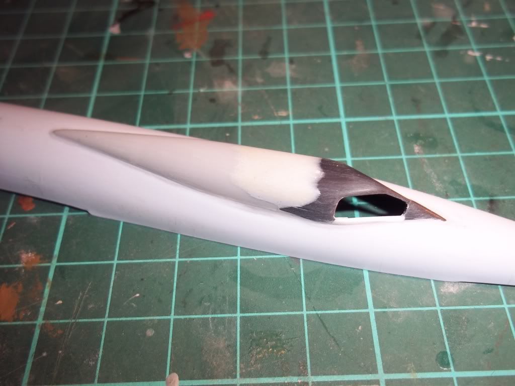

Canopy on, faired into a chopped up half of a Harrier GR.5/7 (that kit came in very handy) drop tank.  The canopy was kindly donated by Weaver from an X-15.  I removed the 'skirt' and cut out the windows as one was faired over in the X-15A2.  In doing this I cut too close to the edge, meaning I had to replace the sills and later knocked of the bridge of it's nose at an annoyingingly late stage.

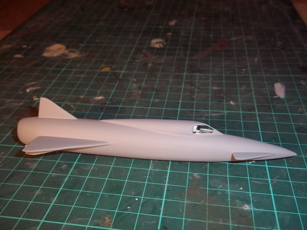

Primer on, blokey in place.  You can just see the crack in the canopy strut that kept coming back to haunt me.  I eventually replaced it and still it managed to break again!  I also somehow damaged the rear of the frame after this pic was taken, it happened at too late a stage to fix it.

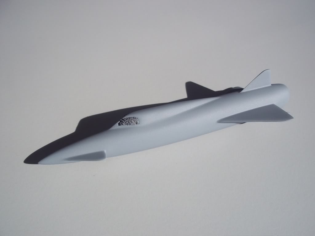

Primer after second round of PSR.  My favourite putty is Mr Surfacer 500 which dried up in the pot just before I needed it :banghead: and I struggled to get rid of the seam lines.  I broke out some gap filling superglue which I don't like (just don't really like the way it feels and I'm suspicous of the stuff since I glued four fingers together when a tube split in a freak work accident!) but it did the job well and I'd use it again were I need a meatallic finish.
