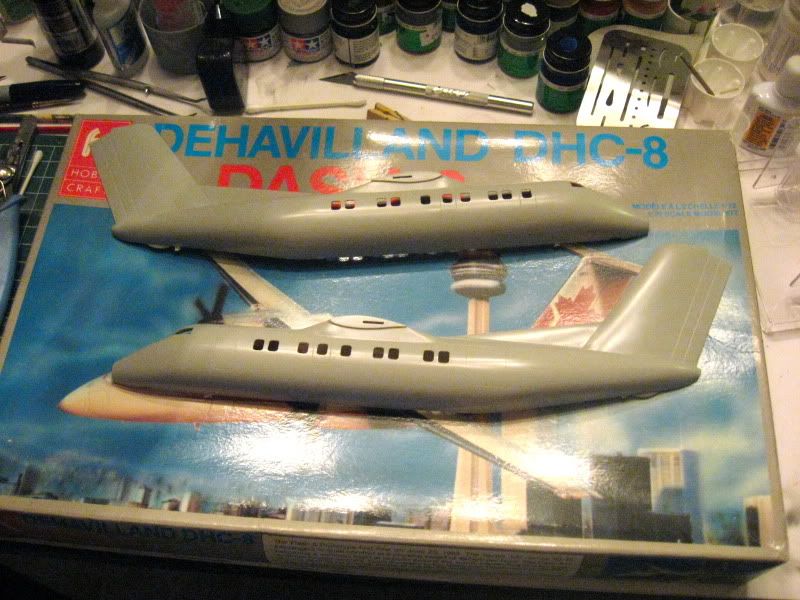

I flew Dash 8-100s and 200s for about 700 hours and was also Simulator Instructor on it.  It's an incredible aircraft, and to be honest the Hobbycraft kit is a bit of a piece of crap...but It's an OK canvas to work with.  I'm not going to do much, if anything in the cabin and cockpit, since it will all be invisible when completed, but I am going to scribe proper panel lines, and add detail such as the deice boots and APU inlet.  The windshield just doesn't look...right...somehow so I may try to improve that, but that will be a few days down the road.  For now it's been a night of scribing!  The 100 and 200 were virtually identical externally, with the only noticable differences being the location of the taxi light (nose on the 100, nosegear on the 200) and the engine breather tubes on the 100, so making this 100 into a 200 will be a piece of cake.

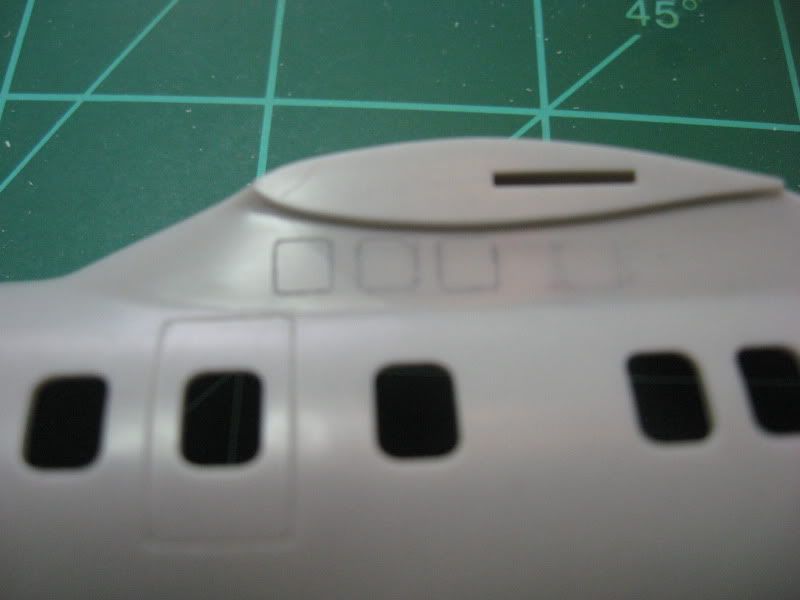

A few update pics of progress so far...I've never done much panel line scribing so doing it from scratch with no raised line to go by is proving to be a challenge, but I'm getting there I think.

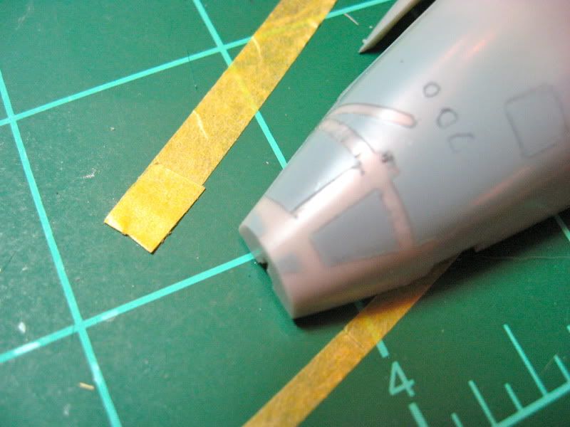

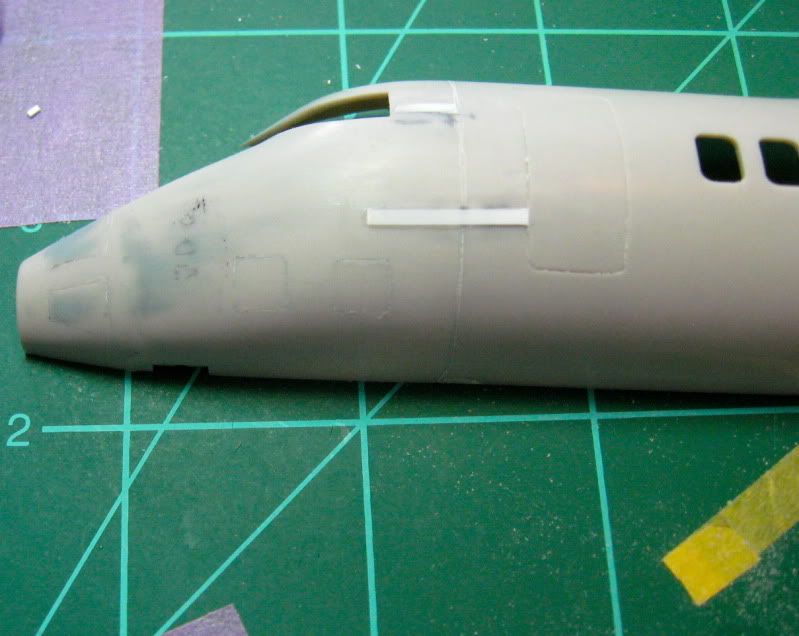

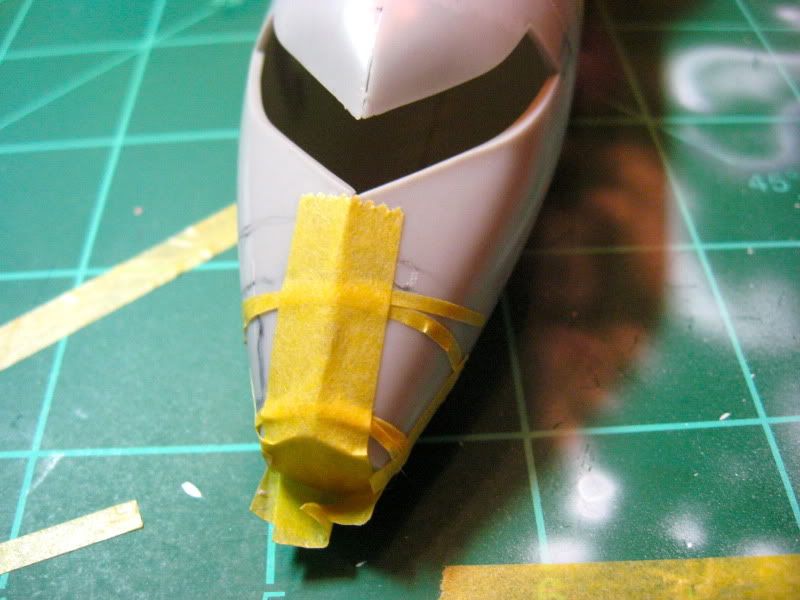

The Dash doesn't really have a lot of visible panel lines, so it's not like there's a ton of them to do.  The nose does have a pair of prominent panels on either side.  The lower ones are maintenance inspection panels and the uppers are hinged doors accessing the avionics compartment if I remember correctly.  To mark them I masked the area with Tamiya tape...
...Then sprayed a thick coat of random color from a rattlecan.  When the tape is removed the paint layer forms a raised area that I then used as a guide for scribing.
The rest of the fuselage was fairly straight forward.  a few inspection panels below the cockpit, and water/lav service doors on the RH side just aft of the cockpit.  The three small hatches lined up vertically just forward of the windshield are the GPU receptacle, ground coms receptacle and nosewheel steering disconnect for towing.

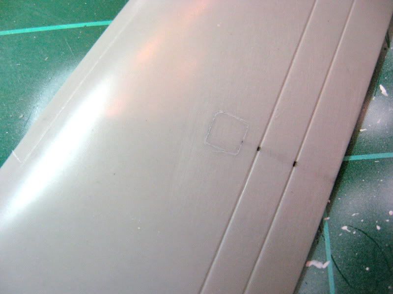

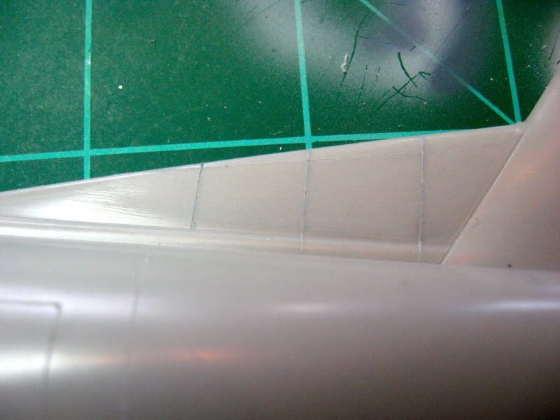

There are a row of prominent inspection panels in the wing root...
There are also prominent panel lines on the vertical fin fillet...
And on the fin itself I scribed the deice boot on the leading edge and a rudder actuator inspection panel.

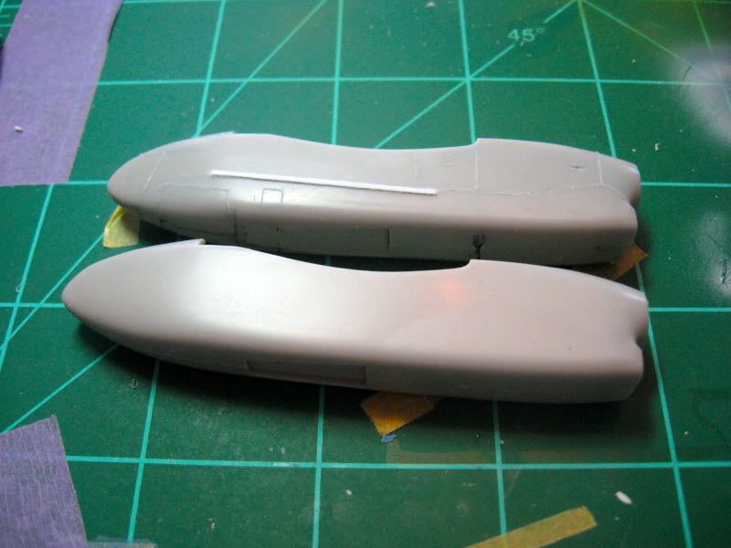

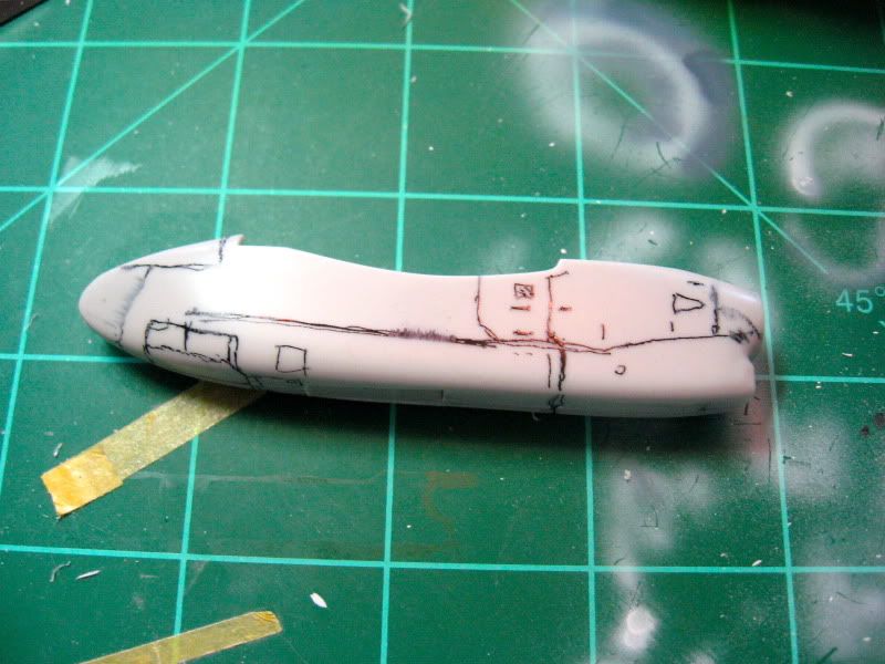

Next I moved on to the engine nacelles...here the kit is particularly weak.  Absolutely NO detail whatsoever, just smooth plastic.  The nacelles have prominent inspection and servicing access panels so it really needs something done.
First I roughly drew on the panels I wanted to reproduce...
Then scribed them...here is a completed nacelle next to the other untouched one.  I'll use the finished one to trace a template for the other.
