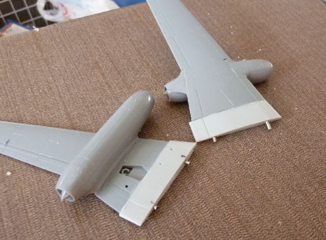

For those of you who cut-and-paste in 3D styrene, the weakest joint is the "butt-joint", where the two interfaces have no interlocking sections, no pin-and-sockets, etc. This is the easiest bond to break, too. So if this joint is going to be strong, it is best to bolster the joint.
"Hollow" joints, like wing section to wing section, where only the thin, outside layer of the wing is being joined, is most easily done with "tabs", like with vac-forms. A small section of sheet plastic is glued half-in, half sticking out to one face of the joint, and then the other face is slipped on over it (glue being applied, of course)
"Solid" butt joints have a bit more inherent strength, having more gripping surface for the glue, but it can "sheer" or part if bending forces are applied. I have had most success with small lengths of steel tubing (being inherently strong and virtually impossible to bend), but even "safety pins" sections will help. Here is a setup for my latest Me-2262:

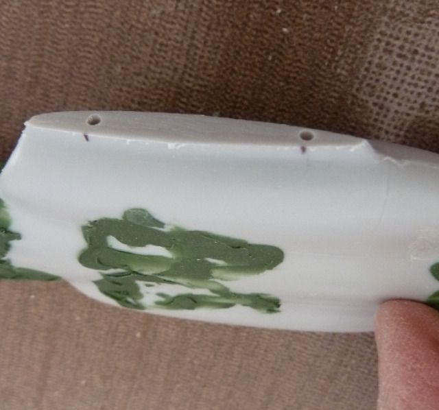

There are small, matching holes in the joint area where the wing will attach. Notice you don't have to have much depth, but you do have to be accurate with the placement so that there is no offset to the surface of the joint.
First, you should align the parts you want fused up EXACTLY, then mark a line (pen, pencil) across the fusion line.
Next, carefully gouge a small indentation in the plastic to be drilled with the end of an Exacto knife or something to "start" the hole. Then drill in a short ways, making sure the hole diameter fits the supporrting rod you will use. Of course, do the same to both sides, making sure the distance from the top is the same on both sides. Insert the small bit of rod in one side (with some sticking out, of course), and then glue the two faces together. You will hopefully end up with something that looks like the second picture! And...it will be strong!

I agree with everything Craig's posted about pinned joints. Some extra points to consider:
1. Another way of getting the holes to line up perfectly is to fit the pins to one half of the joint, then put blobs of paint on the ends of the pins and offer them up to the other half. That way they mark exactly where their corresponding holes should go.
2. Use a slightly smaller drill bit than the one you think you need, looking at the pins. Drill bits, particularly tiny, bendy modelling drill bits, tend to flex and wobble and unless you've got a very elaborate set up, you'll be doing the drilling free-hand, not with a drill stand and jig. This means that you've a fair chance of ending up with conical holes that are wider and looser than is ideal if you use the same size drill as the pins, whereas if you use a smaller one, the holes are a tight fit. Of course if you don't conicalise the holes, you can always take them out a size.
3. When drilling the holes, remember to think about their direction as well as their position: if you drill them in the right place but at an angle, then you'll end up giving, for instance, a wing or tailplane the wrong dihedral. The upside is that if you're using fairly fine rod/wire for the pins, you can often recover this mistake by simply bending it at the joint line.

>Another way of getting the holes to line up perfectly is to fit the pins to one half of the joint, then put blobs of paint on the ends of the pins and offer them up to the other half. That way they mark exactly where their corresponding holes should go.<
I have done that, both successfully and UN-successfully. There is a danger in that where the paint hits MAY not be where they need to be to line up the joint properly when the gap is closed. You may be holding the other part just far enough away to be offset and not know it---I speak from bitter experience here!
>Use a slightly smaller drill bit than the one you think you need, looking at the pins.<
Good idea, generally. Luckily styrene and (especially liquid) glue is our friend here. If the hole is a scosh too small for the pin, some liquid glue will likely soften the hole so that the pin will fit in anyway--be careful of a slight "bulge" (in this particular case) where the pin goes in the hole, in order to limit any gap caused by the bulge.
>When drilling the holes, remember to think about their direction as well as their position: if you drill them in the right place but at an angle, then you'll end up giving, for instance, a wing or tailplane the wrong dihedral.<
Yes--that is also the possible "drawback" of the "paint the rod ends" paradigm. You may START the rod in the right place, but a slightly-slanted rod could cause a slight offset by the time the two parts are joined.
>The upside is that if you're using fairly fine rod/wire for the pins, you can often recover this mistake by simply bending it at the joint line.<
Be careful, here! The whole point of the "bolstering" is to PREVENT bending. If you can bend it INTO place, then you might be able to inadvertently bend it OUT. Ideally, a bolstered wing joint, for instance, should be strong enough to grasp at the wing tip and still hold the model up without bending or breaking anything, despite the leverage of the weight of the rest of the plane.
Actual wing spars, like Gondor so aptly demonstrated, are VERY STRONG (why they use them on real aircraft!) but often require a bit more "engineering" to make sure the dihedral is a proper angle and symmetrical on both sides.
