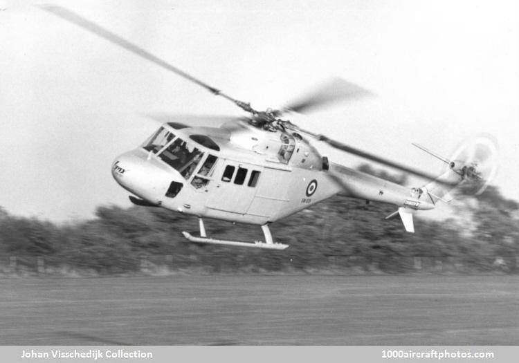

   My guess would be modifications that made it similar to the Lockheed CL-1700. http://www.helis.com/70s/
Quote from: famvburg on February 23, 2012, 06:37:59 PM
Rather loses the pleasant lines of the Cheyenne, doesn't it?
