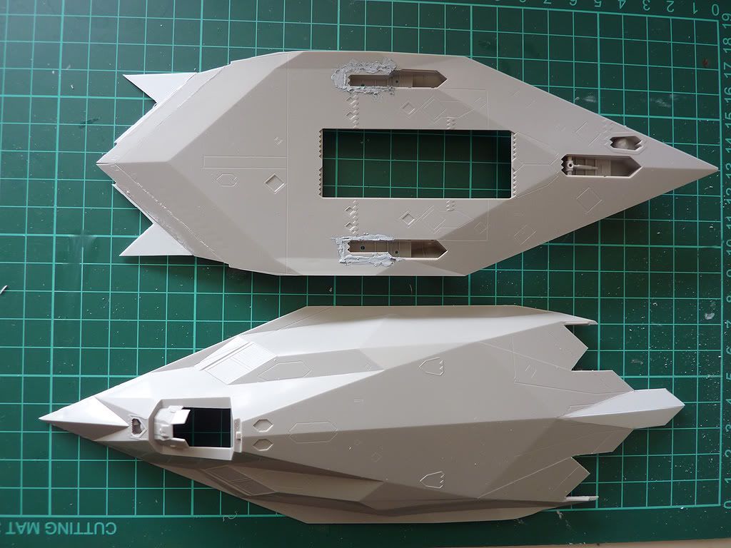

Anyway, for this project, I couldn't spare my F/A-18 nose gear, so I'll use all the landing gears from the donor F-14. Using F-14 main gear means that I need to swap the aft section of the landing gear housing (as can be seen in the pic below). It was a more involving job than anticipated.

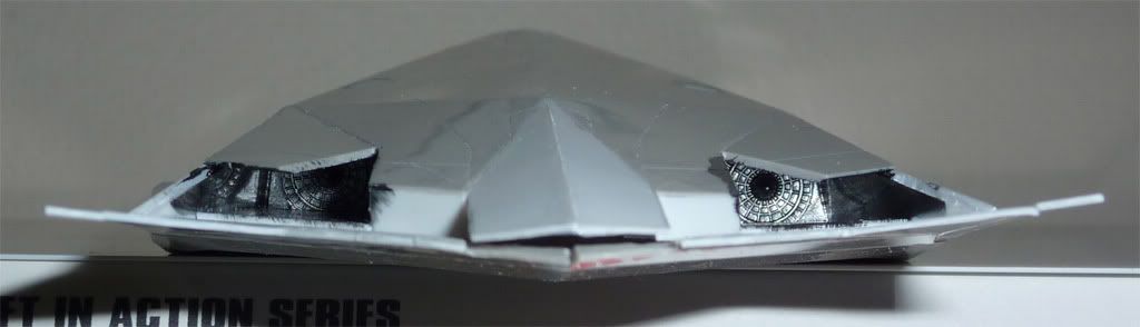

Here is my latest progress; trying to mimic the exhaust. I noticed that even the shape of the exhaust are different from one photo than the other. I decided to go ahead with the F-22 like exhaust.

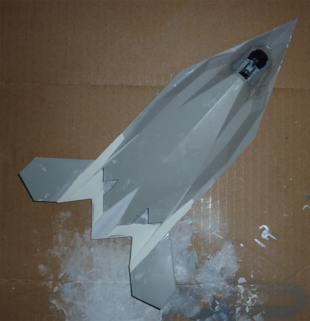

Not much of an update except that the exhaust is roughly there and given the first rough coat of paint.

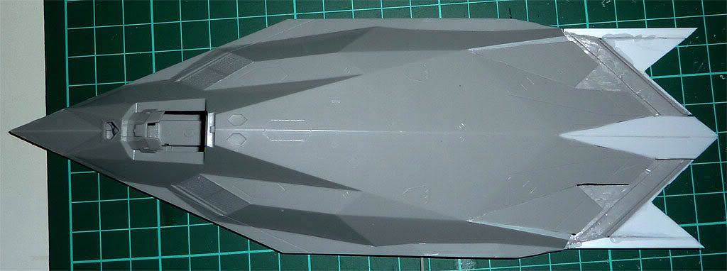

The exhaust is in better shape now. Lots of Miliputt and sanding. The cockpit is just a straight fix. I'm still pondering on doing the bulge or faceted underside...
