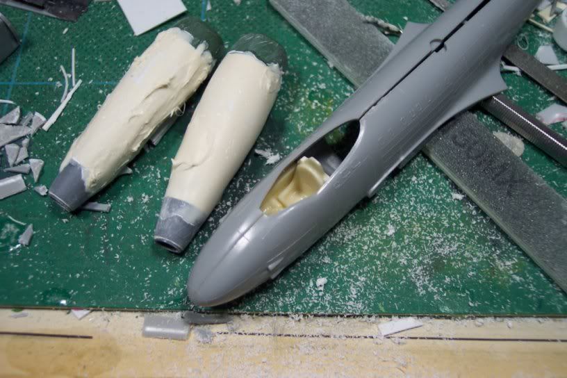

The filler hasn't dried properly yet, found it was starting to move around as I was trying to sand it  :blink: not good I thought. The upper wings have been added to the outer panels and I start to rebuild the upper surfaces later today when I will post some more progress pictures on the wings seeing as there is nothing happening with the engines   :banghead:
#47
Tends to happen if you use a large amount of one of the tube fillers.  The outer surface will cure to a crust and that stops the inner curing, slowing in down at best.  It's happened to me on numerous projects.  Best to leave it for at least 24 hours.
Others would recommend using milliput but I wouldn't.  I find it horrible to mix and then it takes sooooooooooo loooooooooong to cure.  Although it's a small area, I'd go with P38 car body filler.  Easy to mix and cures quickly.  Get it right and you can cut it like cheese whilst it's curing.  Sands to a glass like finish.  Downside is that it stinks.

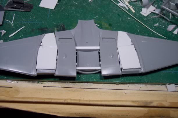

While the filler is curing I have managed to get a little work done on the wings.

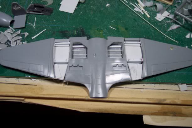

and from the underside....
you may notice a very odd looking circular area on the underside of the left wing, which is to the right in the above photograph, this is the landing light which was horrible in the kit and replaced by a scavanged circular plastic window or something from the scrap box. I have stuck silver paper behind the "light" which because it is not ment for the job is fitted to stand proud of the surface so I can sand and polish it to shape.
