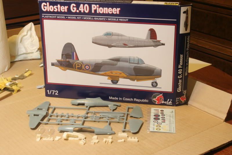

My SSGB kit from Black Knight is a Pavla 1/72nd Gloster G.40 Pioneer, better known as the E.28/39 Whittle engine testbed, for which, many thanks. :thumbsup:
Since this aircraft is so intimately wrapped up with the history of the jet engine, I am, true to the spirit of Whif, going to drop a large and sacreligeous bomb on that by converting it to a rocket interceptor with a battery of RPs in the nose, the overall scheme being colsest to a somewhat less disposable Ba.349 Natter.
The back story suggests that it needs to get it away from runways, so CTOL or an Me-163-style take-off is out. I see it taking off either vertically or at a steep angle using auxilliary rockets, and then recovering near the launch site using a parachute and air-bags, like some modern drones do. It would still be RAF and still 1940s.

Right, made a start now  - nothing worth photographing yet. Ventral fin cut, fuselage and wing parts cut and trimmed and various offerings made. The kit is typical limited run fare: no location pegs, not so much flash, but various odd blobs of plastic in unexpected places. Surface detail is pretty good with only the odd glitch. Fit is okay if not wonderful, but it looks like the resin cockpit tub is too wide for the fuselage halves to close: still pondering that one, but I'm glad I didn't paint it before possibly having to sand it and generate loads of dust. REALLY glad I don't have to make the separate resin intake vanes fit either.... :blink:
I can't decide whether to cut the wings down and fit tip tanks or not. It means re-scribing the ailerons, but a thought occurs to me: given the relatively large speed range and low technology of this aircraft, maybe it has split ailerons, i.e. only the outer parts operate at high speed to avoid over-control, with the inner parts kicking in, drooped to double as flaps, at low speed.
The LOX crew have also been given kidney transplants, i.e. had the sink holes in their waists filled. The plan has changed again: now the pilot's going to be out while LOX filling goes on, since there's no point risking his life at one of the most dangerous prep stages. This also gives me an excuse to have the canopy open, if either a) the cockpit is too pretty to cover up ( as if .... :rolleyes:) or b) the fit of the vac-form canopy is a horror story.
