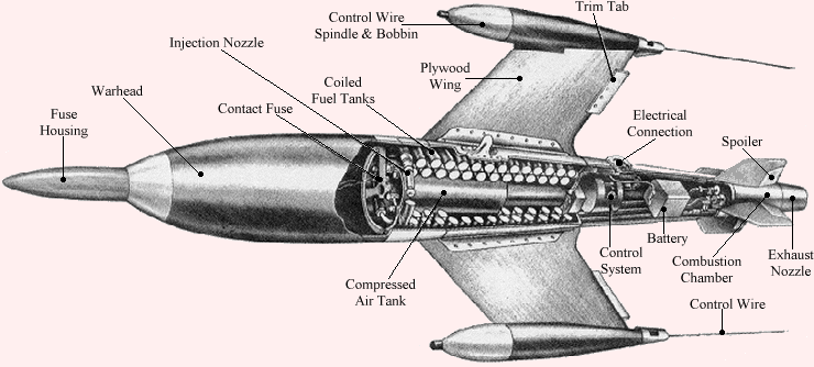

The wire-guided X-4 had a very limited attack range (1.5 to 3.5 km at the same altitude as the target) and was not a fighter-vs-fighter weapon.
The Germans were working on other air-to-air missiles, the Hs 117 H (range 60 to 10 km, up to 5,000 m above target) used line-of-sight radio control and they were working on a homing system. The Hs 298 (range .5 to 2.5 km, up to 1,000 m below or 2,000 m above target) also used line-of-sight radio control, however there were plans to equip it with a wire-link like that used on the X-4.
All were basically line-of-sight daylight weapons (as were, realistically, all A-to-A missiles until many years after WWII), and as such were not suitable for nightfighters, regardless of what Dragon shows on the box of their P.1101 Nachtjager;D
The main problem with changing the guidance system on the X-4 is that it was a small missile and, as shown by the cutaway, the BMW engine took up most of the interior. To add radio-control and semi-active radar homing (ala the Ryan Firebird, http://www.designation-systems.net/dusrm/app1/aam-a-1.html) the airframe would, a the least, have to be lengthened.
