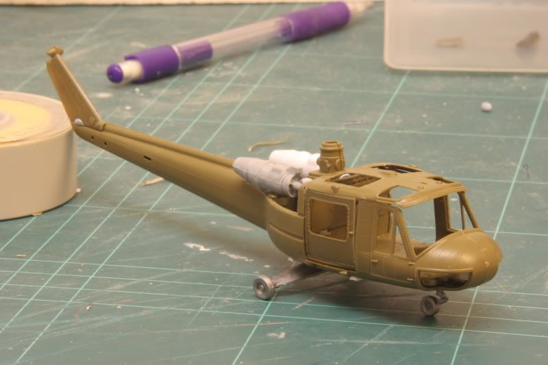

Okay, done some actual work on this, to the point where I have a mock-up. The fuselage is actually glued together, but it's okay because the roof is separate, so I can paint the interior as I go along.
The doors will fit FLUSH (i.e. better than the one in the pic), and will split horizontally rather than slide. Next, it needs an engine deck: since I bought it, I've realised that the new HobbyBoss one actually has an engine deck in the kit, so I could have saved myself a whole heap of effort...... :rolleyes: Mind you, the plastic is nice and soft on this Italieri one, which is good when cutting tiny bits off the fragile struts and frames.

Engine bay work:
Deck in
crossbeam for u/c strut top mountings
ribs on deck and tailboom for "Scout Look"
beefed up gearbox
tail rotor shaft
bulkhead detail (tiny ship gun turrets  ;D)
new rotor mast
side door inner plate
The original Huey rotor mast is very tall, probably because of the length of the blades. With a smaller four-bladed rotor on it it looked plain wrong, plus it only had control rods for two blades anyway, so I've made a new mast and swashplate, and (not in the picture) are four tiny brass rods to link the latter to the rotor head.
