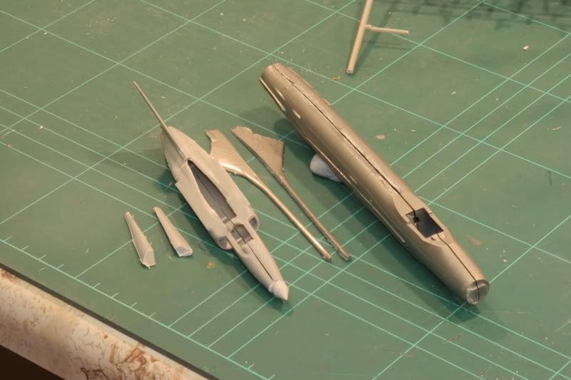

Little bit more progress. Spines cut off the Gnat and the MiG-21 in order to swap a section of the latter's onto the former, thereby allowing the full bubble canopy to be used. This makes for a better pilot view, and also makes it look less like a Gnat.....
The Spineless MiG-21 is thought-provoking, isn't it?
