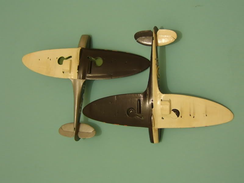

The undersides could be a split of night/white, or include some of the surfaces in aluminium.  Here's pics of an in progress project of two real world Spits from 1939, with different undersides:

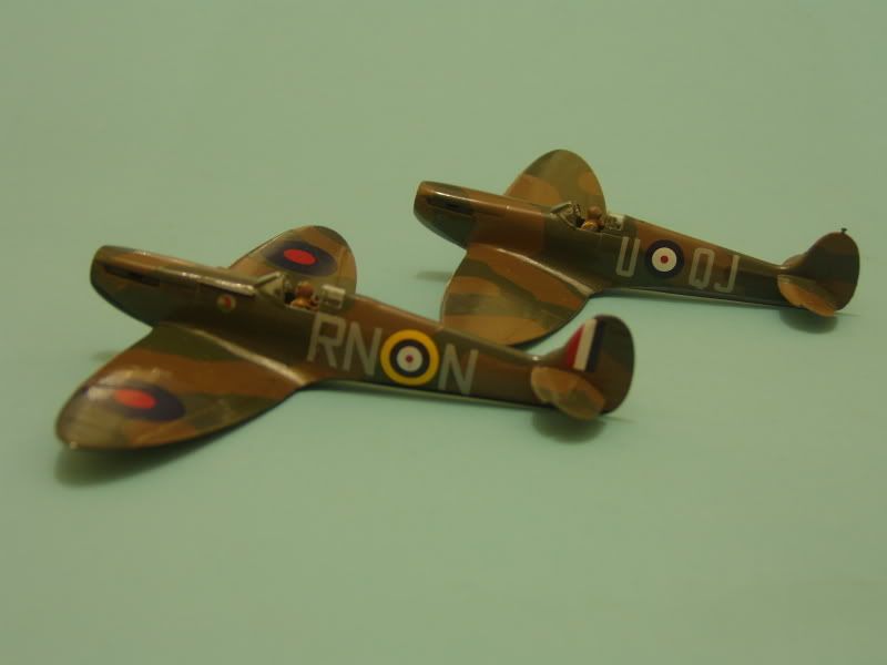

The roundels could vary too.  The were usually A1 (red/white/blue roundel with yellow outline) on the fuselage & type B (red/blue) on top of the wings.  In this period, roundels were rarely carried undersurface of the wings, but it wan't always the case.  Here's a pic of the same project, with two different roundel, fin flash (one missing them) & code styles on the fuselage, both with the serials painted out:
It's a bit of a minefield if your trying to replicate a real world aircraft, you really need photos of the aircraft in question.  But with a whiff, it actually makes things easier, as there where that many variations, almost any combination you come up with will have happened real world.

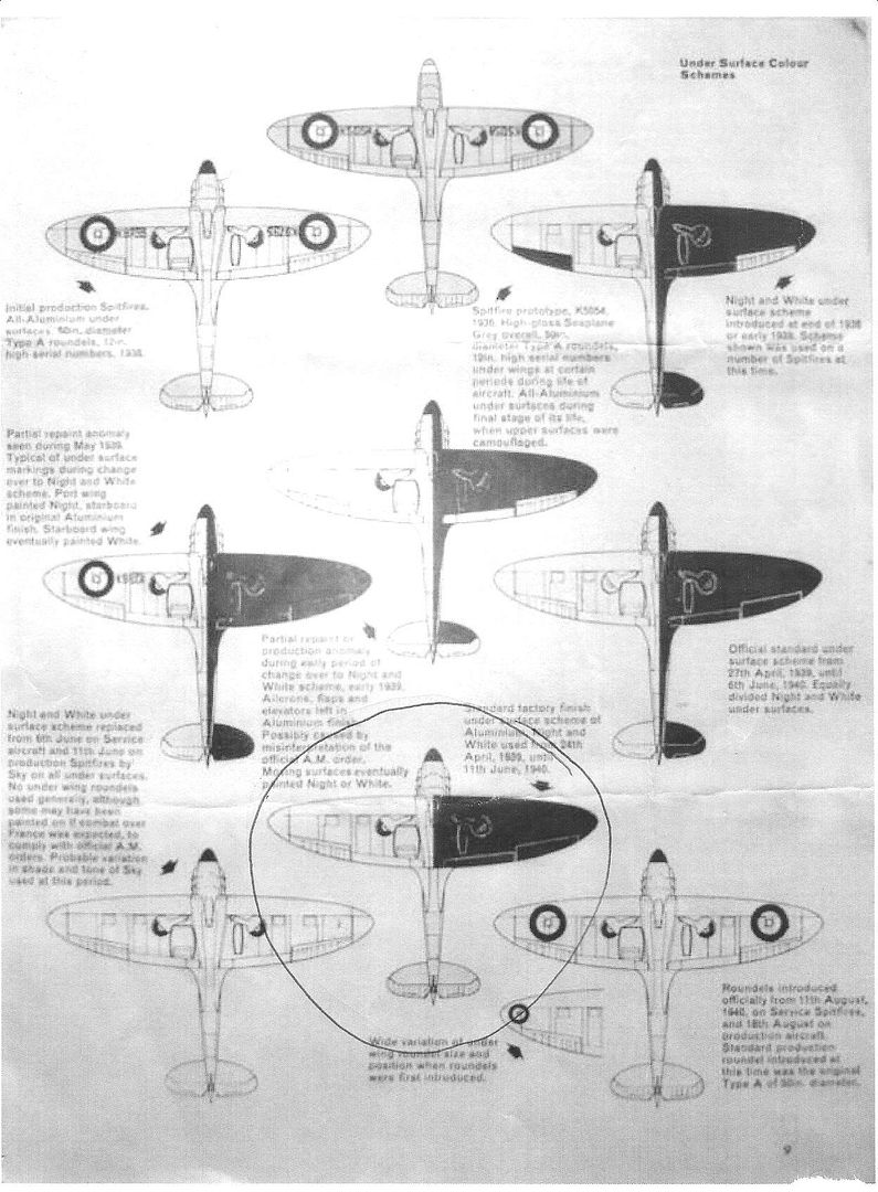

I've got a diagram of the variations in the undersides from this period, I'll try & scan it, although it's already of slightly-poor quality.
Here's the scan I promised of the most common variations.  For late 1939, the night/white versions are the way to go.  You can see that sometimes the nose & tail were aluminium dope (on one of my models above).  Sometimes the ailerons where aluminium, or the opposite colour to the rest of that side wing.  The night/white split wasn't quite half & half, the white was from the centre line at the nose to the right side of the rudder where it meets the fuse, you can just about make it out on one of the models.  One thing that did tend to remain standard was the left wing was always night & the right always white.  I've never seen it the other way around.
