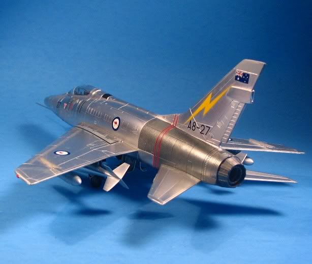

If using cans is at all possible I'd try that.  Testor's Metallizer cans have always worked really well for me.  I've airbrushed Metalizer too with good reuslts but it's been a long time ago.  Now that I've switched to acrylic I dont use anything that needs a thinner other than water or alcohol.
With Metalizer you can get a nice variation depending on how much buffing you do.  It works best on smooth styrene, but I've also primed individual panels with silver and gloss black before to get variations.
This was done entirely with Metalizer Aluminum Plate and Titanium cans.
