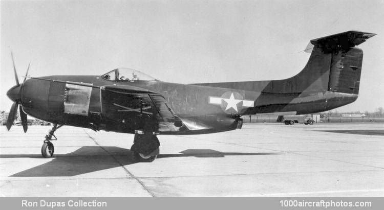

The Curtiss XF15C-1 of 1946 was the first jet-age powered aircraft to fly with a true T-tail.
