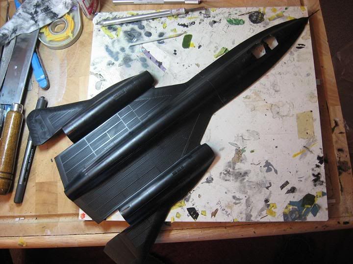

I'm using the Revell-Monogram 1/72 kit for the build, and the contours make it tough to shorten the forward fuselage as much as the picture.
I cut out 1.25 in., or a about 7 scale feet in a spot were the contours match back up just about perfectly.
This is the shortened fuselage.  Instead of missile bays I'll be mounting a large ASAT missile on the pylon included in the kit for the D-21 drone, and I'm adding a rocket engine to the tail too.

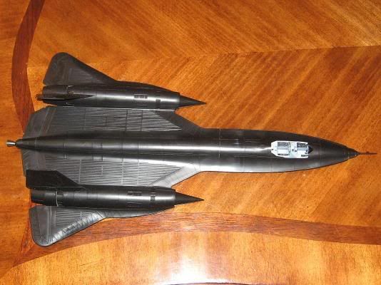

One more pic for tonight.  Major construction is mostly complete.  The shock cones, exhausts, and vertical stabilizers arent permanently attached yet, and there is still some PSR to do around the seam on the underside where the top and bottom halves meet, but otherwise it's mostly done.
This pic shows the small rocket engine bell at the tail to boost the Raven to missile launch altitude/attitude.  It doesnt look as different from a normal -71 as I had hoped, but as I mentioned earlier, the shape as well as the nosegear bay made it much easier to chop out 7 scale feet instead of the 15 or so I had intended.  The scheme will be whiffy, with a mix of YF-12 and operational colors.
