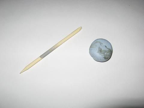

The tools of the trade are pretty simple.  Blu-Tac (or a similar poster-hanging putty) and some sort of chisel pointed thingy.  This is from a 99 cent nail care set I saw in the checkout aisle of a discount store.  It had 2 or these things, a nice file, and a 4-way nail buffer.  I thought it looked very useful for modeling!

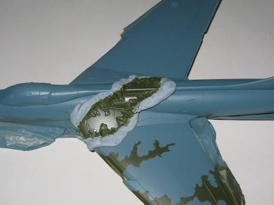

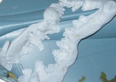

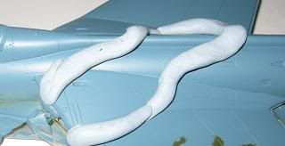

I roll the putty into 'snakes' or 'sausages' then outline a rough pattern.
Next I use the chisel to push the putty down onto the model surface in the more intricate pattern.  The putty adheres well to the surface, but isnt sticky, so there is no risk of lifting paint.
I also use the pointed end of the 'nail stick' (my term, no idea what the ladyfolk call it) to create smaller shapes in the camo outline.

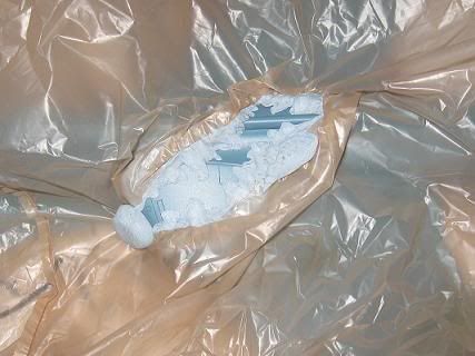

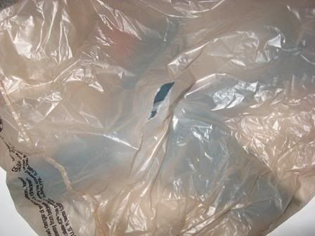

To mask the rest of the model I use a plastic grocery bag.  I put the model in the bag and cut a slit over the area to be painted.
Then using the chisel again I push the edge of the hole into the putty to seal it.

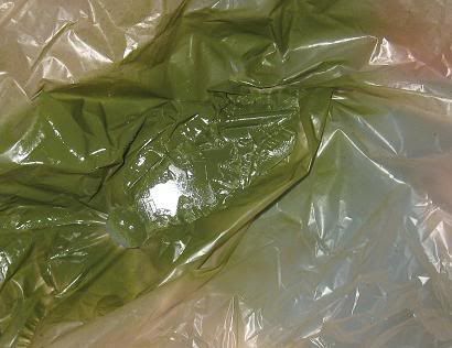

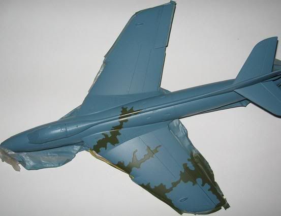

I do a lot of painting with Tamiya spray laquer in cans since it is easier than getting the airbrus out and the paint gives a beautiful and durable finish.  Whether you use cans or airbrush though it's just like painting anything else, using multiple thin layers for the best coverage.
Once it dries (quick with the Tamiya paint) I pull the bag away from the blu-tac and take the model out of the bag (which can be reused once the paint is fully dry).
The blu-tac lifts off easily.  If any stays stuck to the model just lift it off with another piece of blu-tac.  Roll the blue-tac around and knead it a little and it's ready to use again.
This is not the quickest way to paint camo, thats for sure, but I like doing it a patch at a time so I can look at the overall effect as I go.  To paint the section shown above took a total of about 30 minutes from start to finish, so doing the whole model takes several hours.

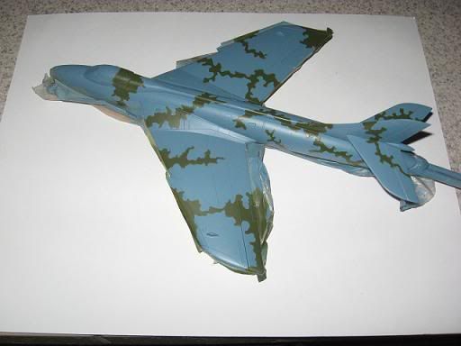

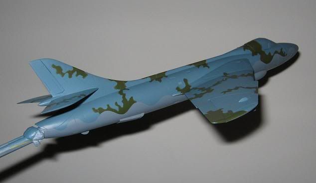

Well it took allllllll day (with a few other things going on too), but the camo is done.
With all the masking removed to show the wavy demarcation line...
