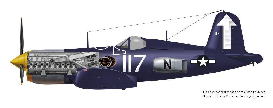

Reengining Corsair with turbocharged Allison V-1710-111/113 ...
... and with Klimov VK-1
What if installing a Chrysler IV-2220 https://en.wikipedia.org/wiki/Chrysler_IV-2220 in a Corsair?
Do I need to stretch more the nose?
All your comments will be wellcome.
Thanks.
perttime
Quote from: ysi_maniac on October 19, 2018, 07:53:53 PM
The Crysler weighs about the same as an R-2800 - but the R-2800's weight is mainly out there in front. Just eyeballing this, and a regular Corsair profile, I suspect you should stretch the Chrysler nose a little to balance the aircraft, especially with the radiator in the rear fuselage.
You might want space for a fuel tank in front of the cockpit, too.
Quote from: perttime on October 20, 2018, 04:15:05 AM

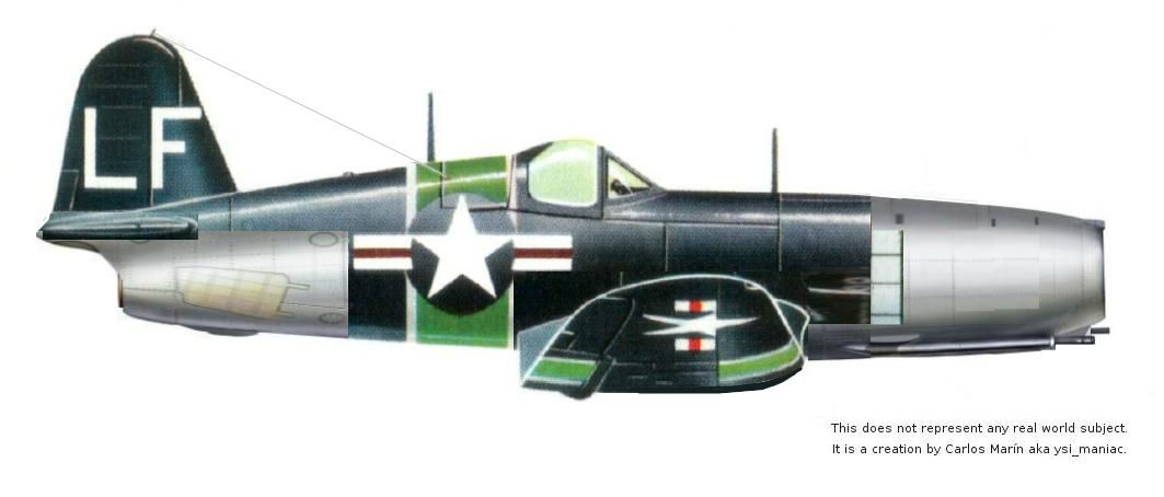

Use a Corsair FG2 as a base instead
Quote from: ysi_maniac on October 20, 2018, 02:05:35 PM
According to Wikipedia F2G is only 4 cm longer than F4U. :o

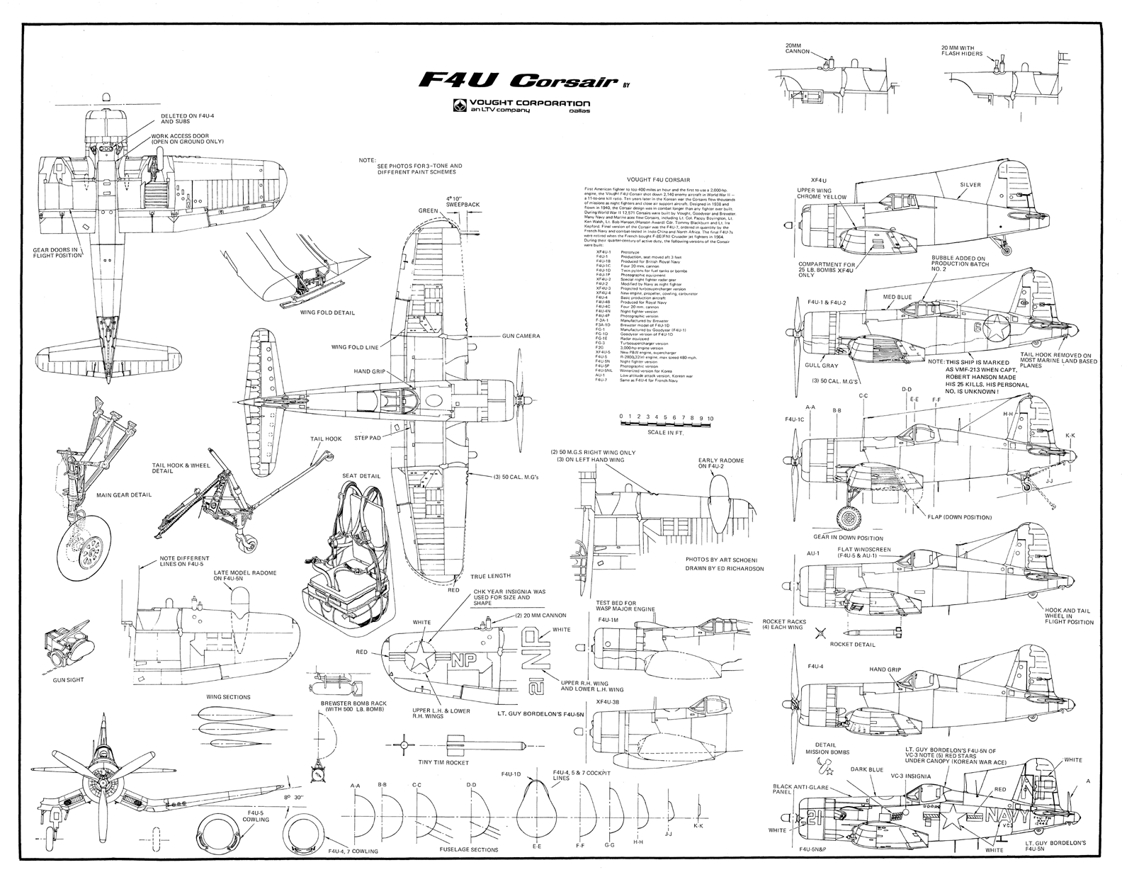

It's all in the packaging, the firewall was moved aft in the F2G, compare the location of
the exhausts between the F4U and the F2G.
F4U-1M (Wasp Major testbed) nose to nose with R2800 powered Corsair.
The scrap view of the F4U-1M in the centre of the drawing also shows the
difference when compared to the profiles at the right.
BTW the XF4U-3B was turbosupercharged.

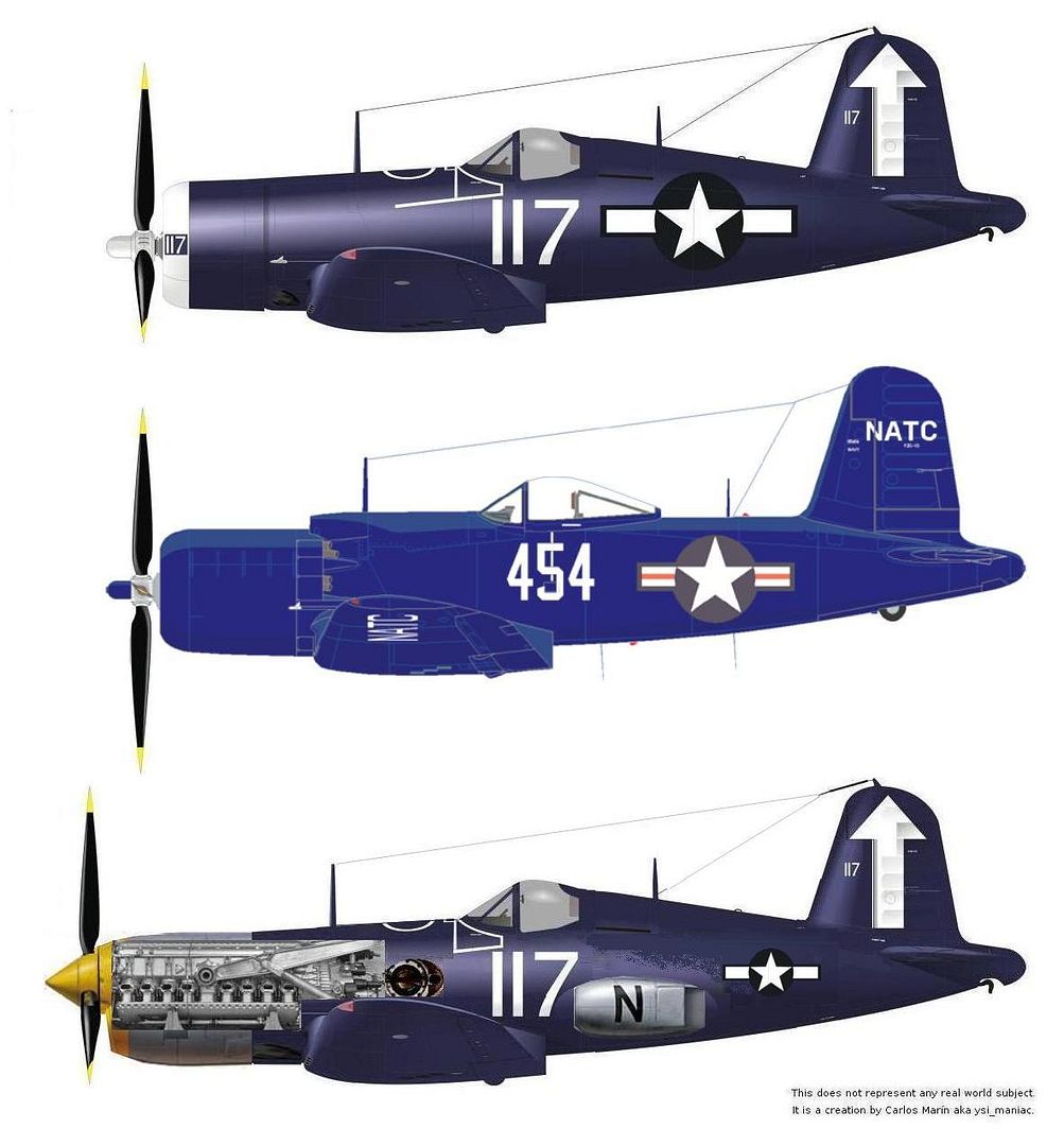

Here you can see F4U, F2G and my design.
According to wikipedia F2G was only 4 cm longer than F4U :o
Anyway in my definitive version, the plane will be 72 cm longer than standard F4U (measured in the base of propeller), so 1 cm more in my 1/72 model. 8)
I have moved radiator a little forward,
