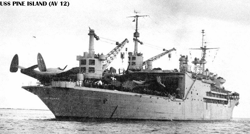

Why not just bring her to the AO aboard ship, and put her in the water to take off and land?
QuoteWhy not just bring her to the AO aboard ship, and put her in the water to take off and land?
Large seaplane tenders were used for that purpose.
Here is a US type, the USS Pine Island:
The Tangier (AV-8) and Currituck (AV-7)  in 1944:
Lots more here:
http://www.navsource.org/archives/09/41/41idx.htm
Jon
