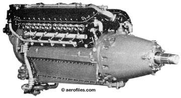

The P-40B/C were powered by a 'long-nose' C series engine with 'straight-through' reduction gearing:

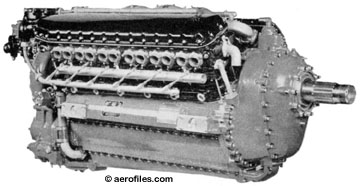

Later P-40s used an F series with an offset reduction gear housing that raised the thrust line:
The Allisons installed in the P-38, P-39, P-63 were F type, and that is the type being modified for the Flugwerk project.
